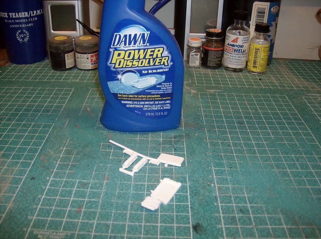

Posted 19 October 2010 - 10:01 AM
How long is everyone using Dawn power dissolver soaking the parts for?
Sean, please refer to my previous post. :lol:
Posted Image
The parts in front of the bottle were done in about 4 hours.
Those parts required a slight bit of scrubbing with an old toothbrush, if you'd leave parts overnight, the chrome should almost just fall off.

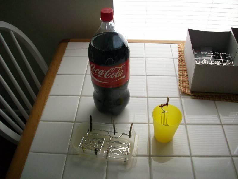

I've found Coca Cola works well for stripping chrome. It leaves the undercoat on, just takes off the chrome. And in the case of earth friendly, you don't get any better! Usually a day or two (if you can wait that long) and the chrome is gone. I use soap and water to wash the sugary brown liquid off the parts.
