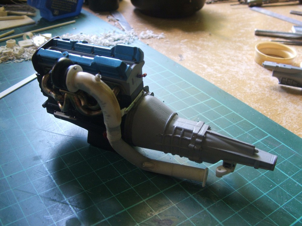

Rom, only an early mock up of the RB engine at this time....the turbo was a very early item from Tim @ TDR. It's a little on the large size, but was the smallest available at that time.
Sitting on a custom fabricated tubular exhaust manifold, it sits way too high.
Posted Image
A smaller, more to scale turbo will be on the way shortly. :) Will run a 3inch mandrel bent system from the turbo back.
It should look right at home sitting in here.....
Posted Image

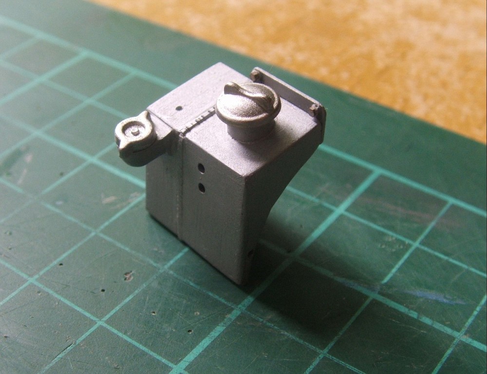

Working with the fuel system, I found that a "swirl pot, or tank" is an often fitted accessory with turbo cars. Not sure if it's really necessary, but thought I'd add one.
I punched tiny black washers from thin black sheet stock to simulate the rubber bushes supporting the tank.
Posted Image
Still needs all the lines fitted at this stage, and am anxiously awaiting an order from Robert @ RBMotion.
Posted Image

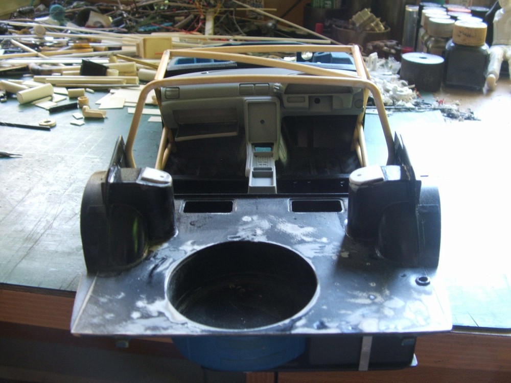

TDR and Shapeways sure do wonderful work. I could not be happier than what I am with their new turbo. B) ;)
Posted Image
This is actually a "2.5inch" which I think suits the build really well. I will run a full 3inch exhaust from the outlet.
Posted Image
Posted Image
Tested in the bay, it's still snug, but fits a lot better than the larger turbo I had originally. :)
Posted Image
And I'm really hoping I can get away without the need for a hood "lump"......I will if it needs it, but indications are it will be fine. :)
Front view.
Posted Image
I hope to get onto the "down pipe" later today, so I can get the full exhaust done.
Thanks for stopping by, and I hope you all enjoy.
Cheers
Greg
