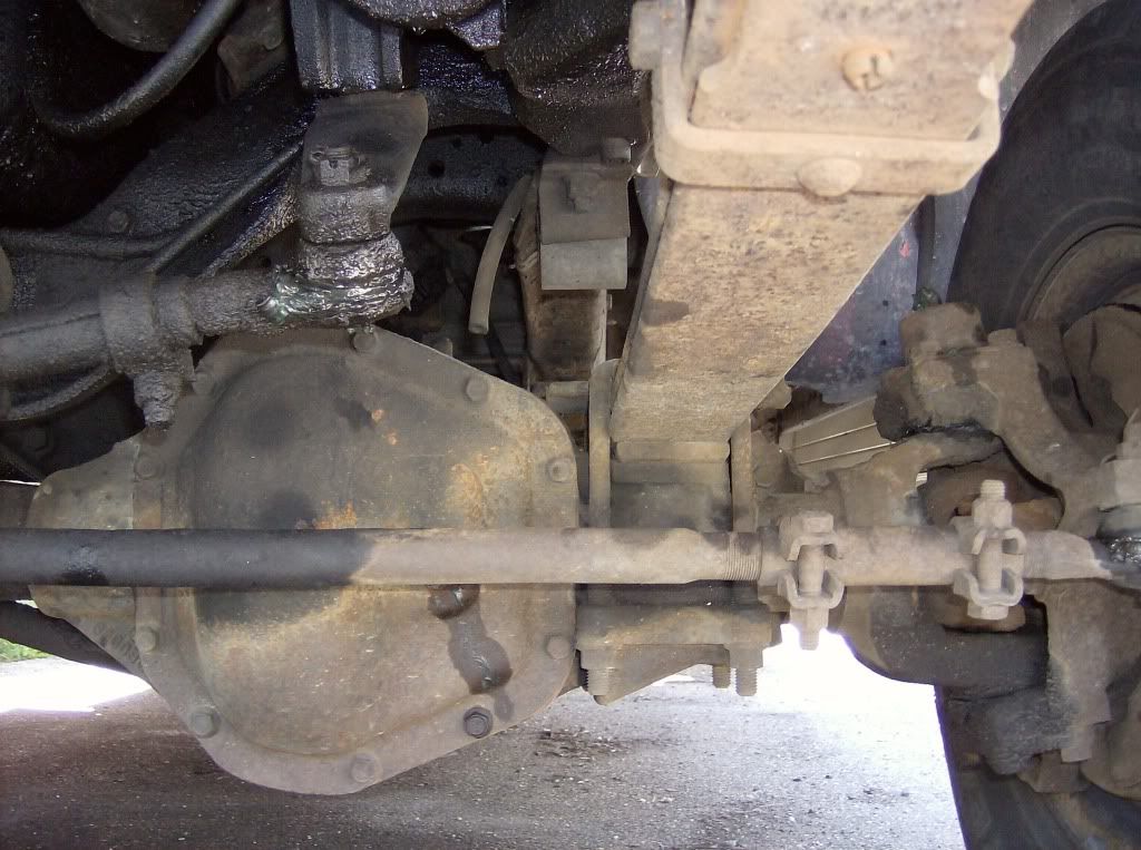

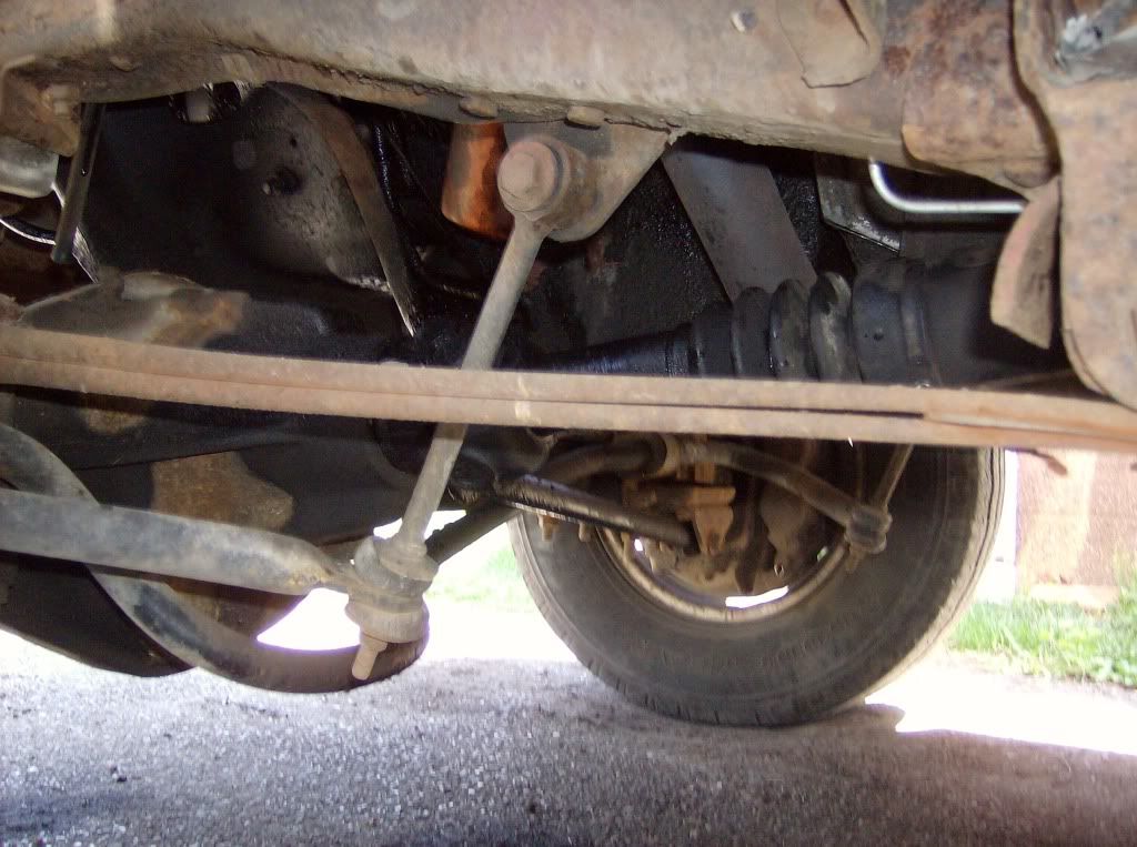

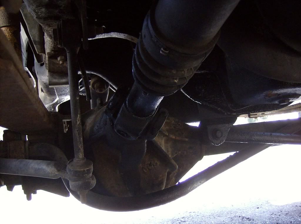

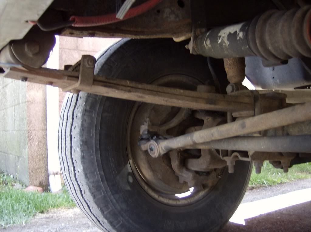

Front Dana 60 Monobeam Axle:
Drivers side front spring from front:
Passenger side front spring and steering from drivers side:
Close up of passenger side front spring:
Drivers side front spring and steering arms from under passenger side front spring:
Rear of center section from rear under front driveshaft:
Rear of drivers side front spring and sway bar mounts from side (next two pictures):
Link to comment

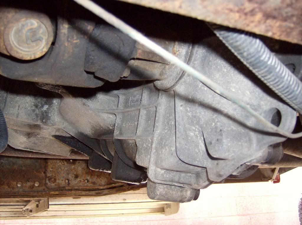

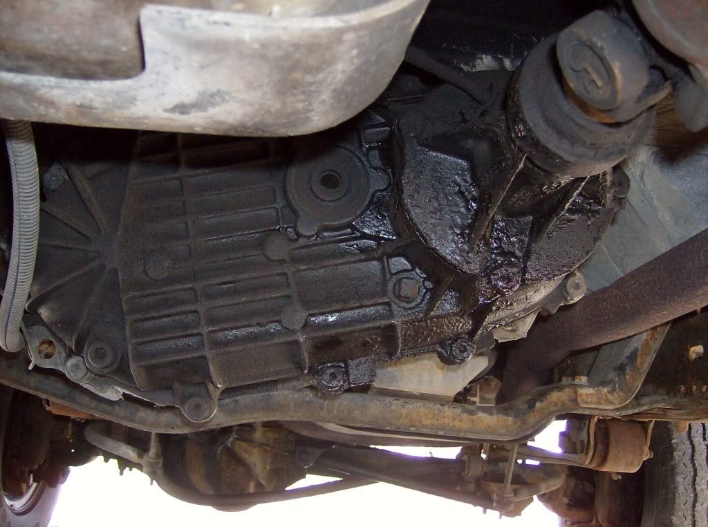

The Borg Warner 13-56 Transfer Case from front drivers side:
Transfer case from rear:
I should also note, I did not get a picture of the passenger side of the transfer case, I plan to, but there is a cover on the passenger side for a PTO.

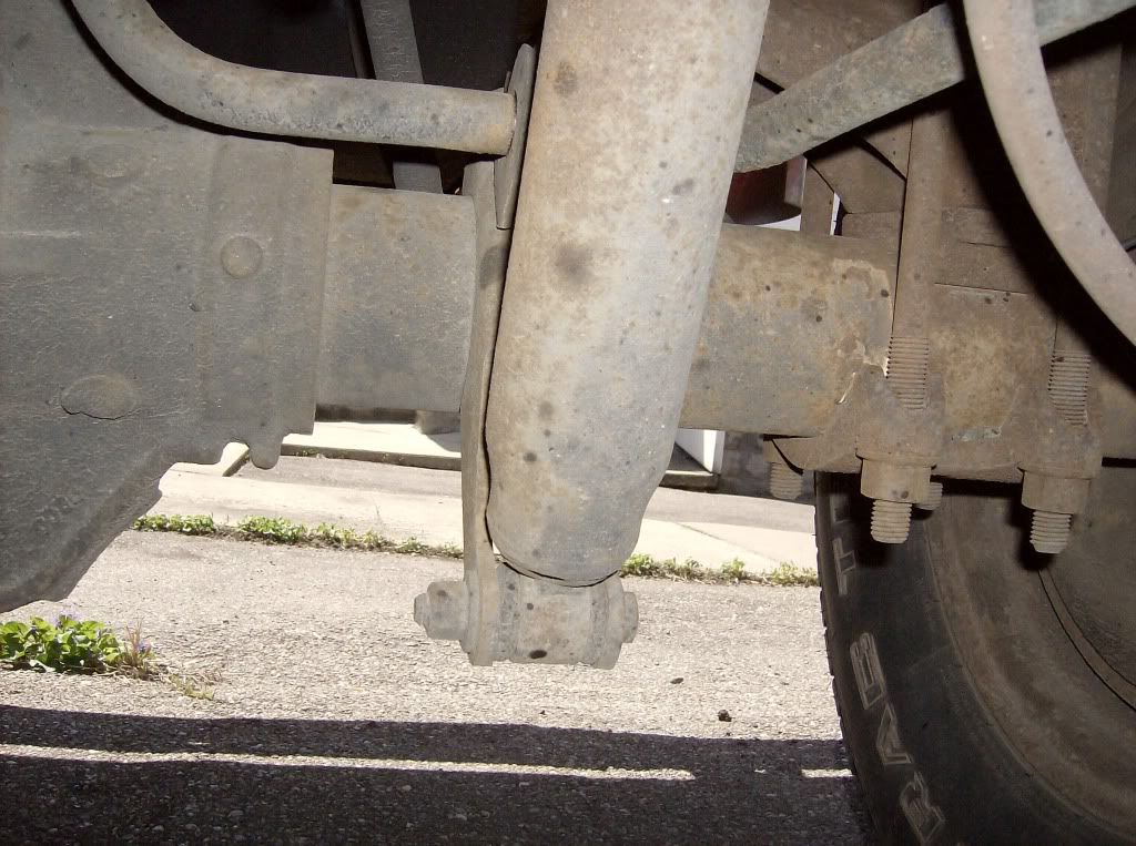

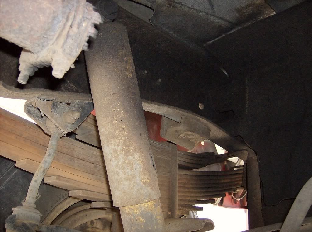

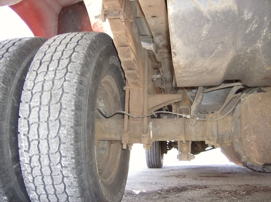

The Ford 10.25 rear axle from rear:
Heavy Duty drivers side rear spring and sway bar link from front:
Heavy Duty passenger side rear spring, sway bar link, and shock from drivers side front:
Passenger side upper shock mount from drivers side front (drivers side upper shock mount is the same, both shock tops face front of truck):
Drivers side lower shock mount from front (again passenger side is identical):
Front half of drivers side rear spring from beside truck:
Rear half of drivers side rear spring from beside truck:
Drivers side rear spring and axle from rear:
Passenger side rear spring and axle from rear:
I hope these pictures help in your projects, and, as I said before, feel free to ask any questions or if there is something you may even need another picture of, I will be happt to help in any way I can. I must note, you will not find the rear springs pictured in any of the Monogram kits, the kits have the standard dually springs. As I mentioned in the opening post, this truck was built as a heavy duty chassis cab, not a standard dually. This truck has a Gross Vehicle Weight Rating of over 12,000 pounds, with a front axle Gross Axle Weight Rating of approximately 4,000 pounds and a rear axle Gross Axle Weight Rating of approximately 8,000 pounds. My GAWR on the rear axle is about the same as the GVWR of approximately 8,000 pounds for a standard factory built dually!
