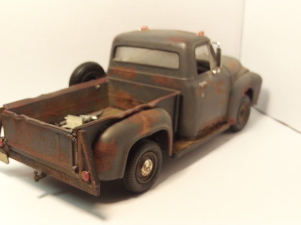

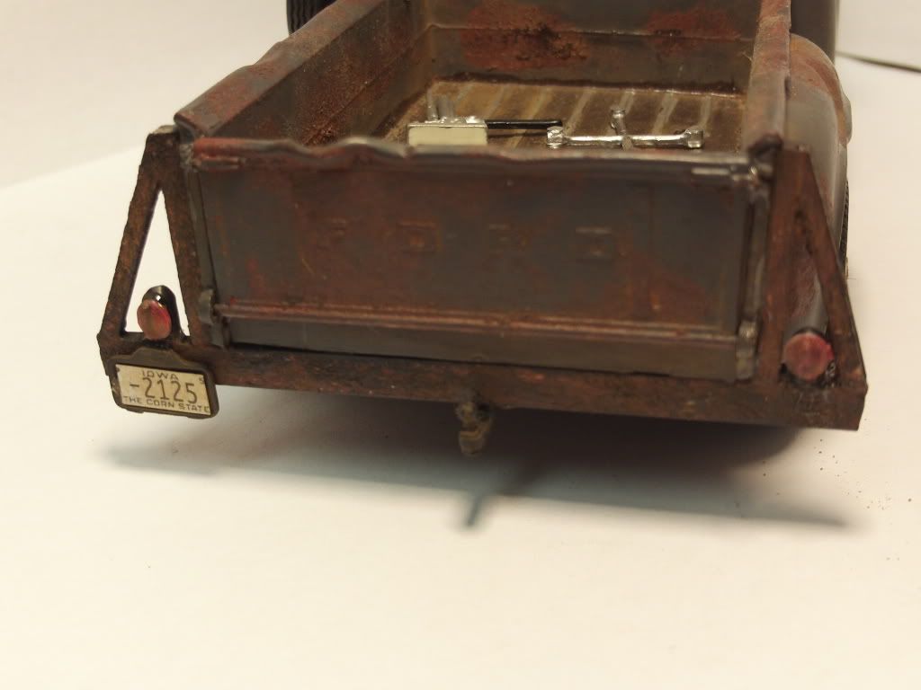

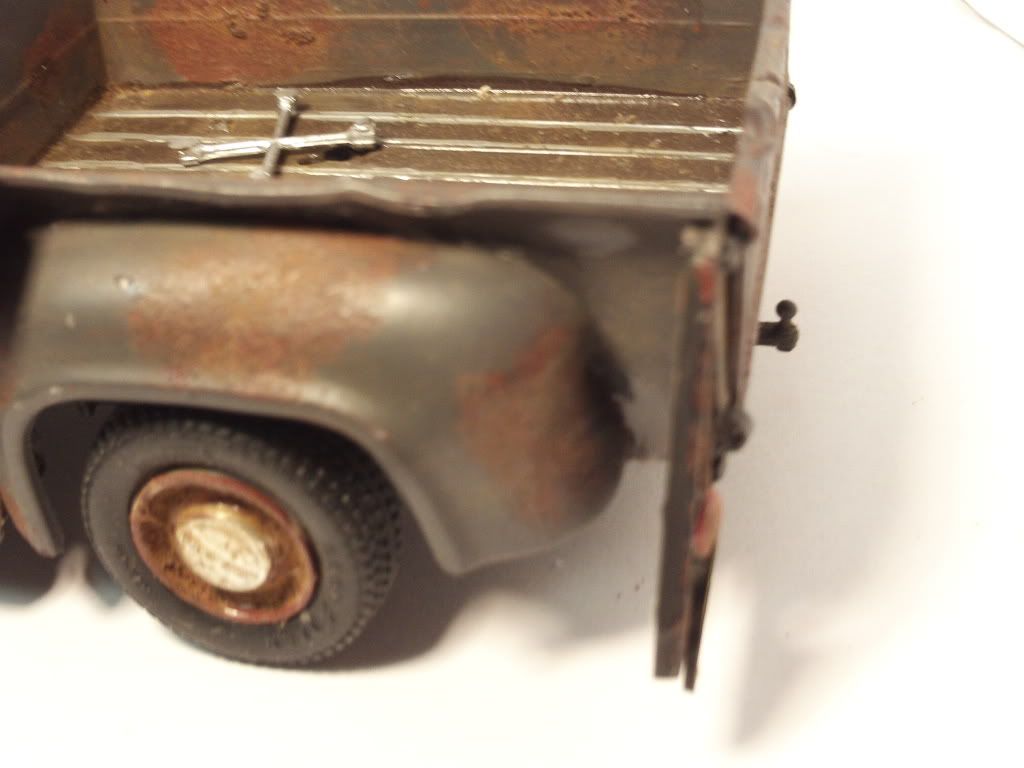

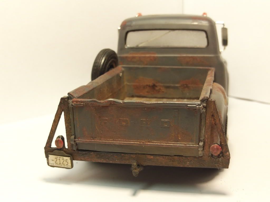

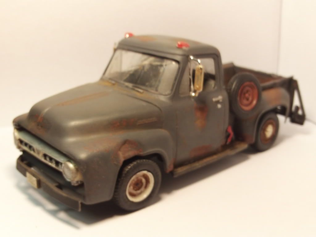

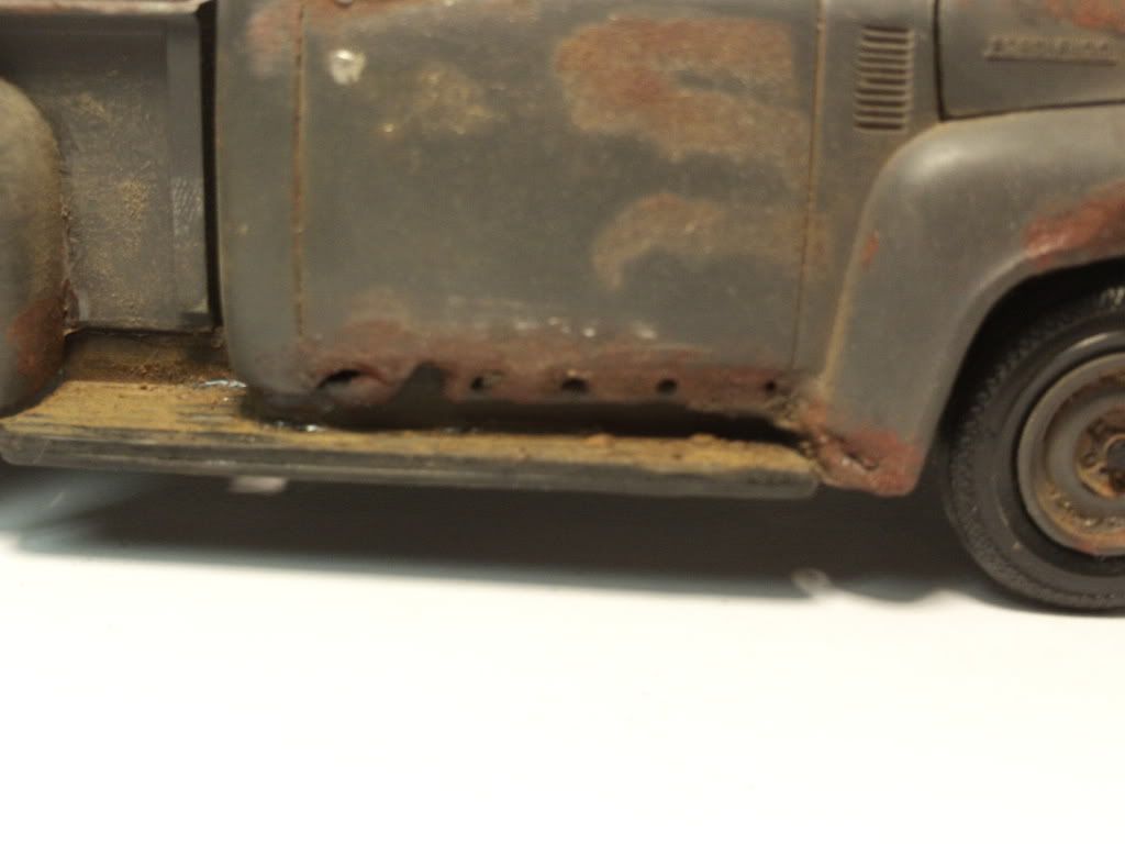

Posted 20 November 2010 - 09:47 AM
I did this after watching Cranky build a '55 Chevy truck. I used like VW Dave said a round dremel bit and then a dental pick, I used Testors Rust, then salted it, then sprayed the color, the removed the salt, then dry brushed some finely ground real rust over it.
Posted Image
Posted Image
Posted Image
Posted Image
Posted Image
Posted Image

Posted 20 November 2010 - 10:35 AM
That's a nice one, Nick! The dents are really well done ... as is the rust. It's all VERY believable!
