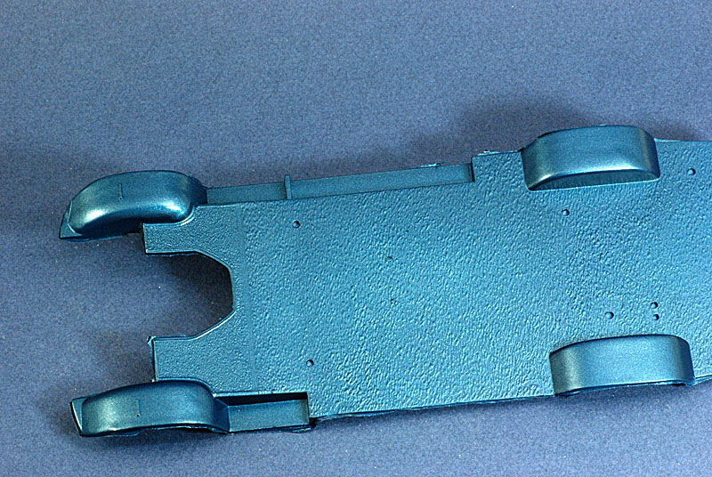

#90 Foxer
Foxer
  • 6,209 posts
  • Location:The Berkshires, Massachusetts
  • Full Name:Mike DeRagon
Posted 30 November 2010 - 04:09 PM
more on the glacial build, but not a glacial change :D
I came on some better seat references as the seats were taking shape, so they are getting squared off at the top. Otherwise I'm happy with them. I got the upholstery for the driver seat done in Photoshop and some half rounds for the passenger seat pattern which didn't have a seat cover.
A rust coat was applied to the chassis plate for some salt rusting. Everything but the hinges is moving along ... hinges came apart trying to glue the tubes to the doors.
