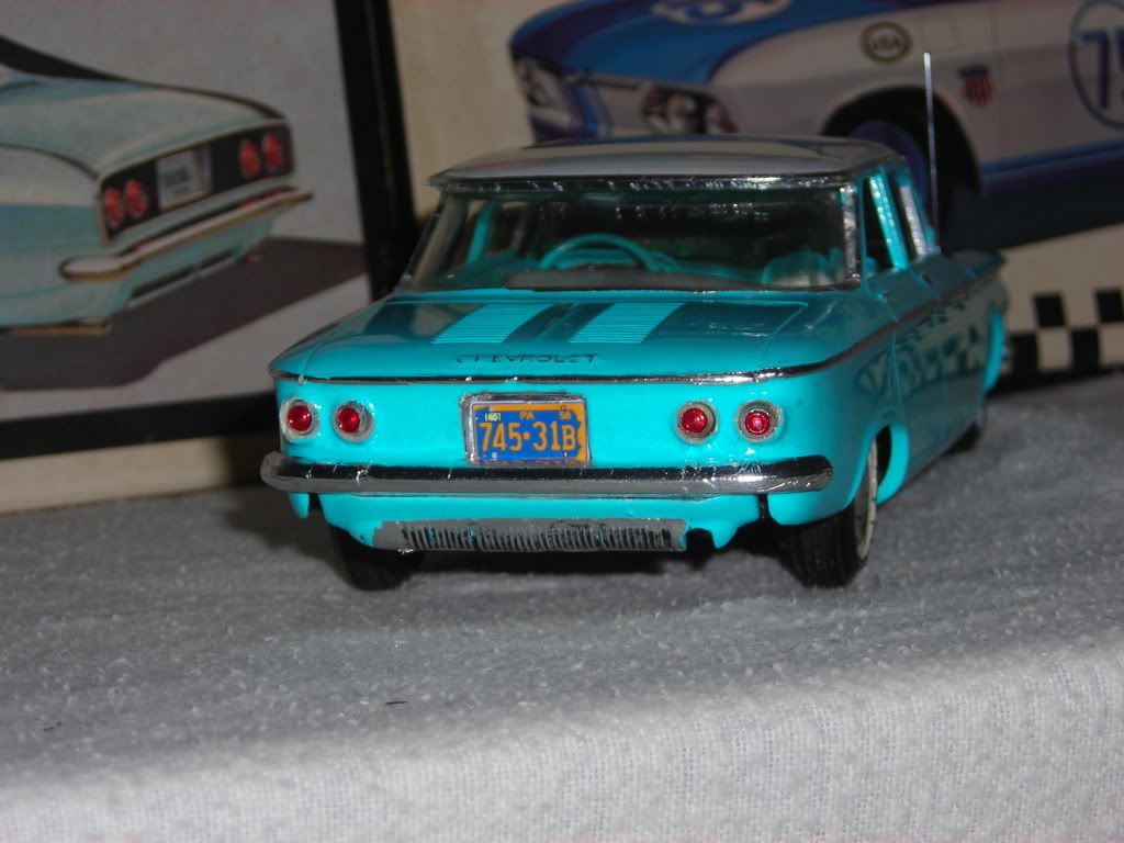

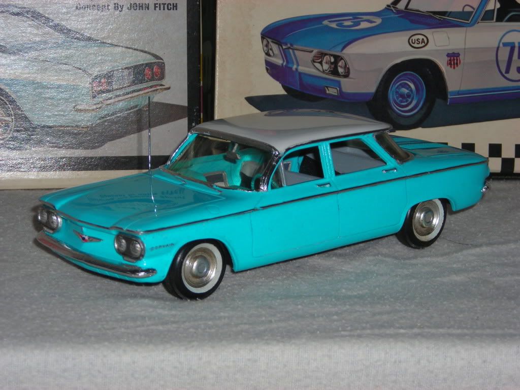

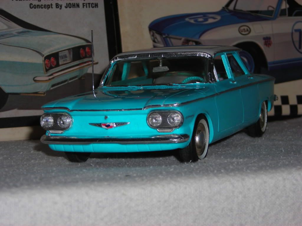

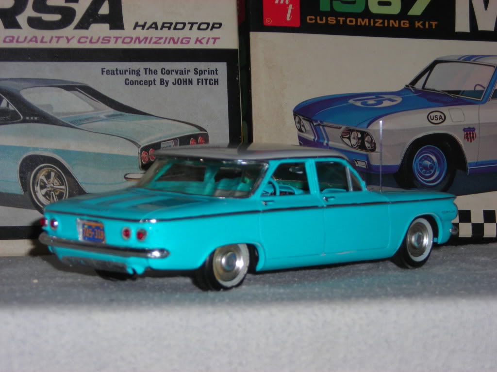

Here's my SMP 1960 Corvair 700-Series 4-door sedan annual kit restoration. At this point, I'm ready to call it done... For the moment. As I mentioned above, the chrome is weak but I don't have an airbrush to re-do it with Alclad or the money to send it out to be replated so I'll just have to make do with it as-is. There are a couple of areas where my BMF work is weak (particularly around the rear air exhaust grille), but I really don't feel like futzing around with it any more at the moment! Some time in the future, after I get the necessary chrome work done, I'll be ading tire valves to it too - I just realized while looking at these photos that I forgot to add them! This rebuild was a blast to do: I usually enjoy doing restorations/restomods on old glue bombs like this one was better than building a new kit anyhow, and it being a replica of a car I used to own just made it that much better.
(One area where I particularly liked the result was the license plate. I found a seller on eBay who makes computer-generated scale license plates and sells them at a bargain price. I bought several 5-year sets of Pennsylvania (my home state) and California plates from him and was so pleased with them that I special-ordered some more from him with specific number combinations from cars I used to own and am planning to replicate in scale some time in the future. If you're intetested, I'll see if I can dig up his website info so you can contact him yourself. Tell him Corvair Jim sent you!)
So, on to the pictures:

Jim, what do you use to burnish the BMF down with? I use a Q-tip to burnish BMF, and that also helps you get into tight areas like the areas where you have some of the wrinkles in the window frames. By using the Q-tip and using firm but not hard (you don't want to be rough, it will tear the foil) pressure, it will lay the foil down smooth and eliminate wrinkling. I've also found through the years going from one edge to the other, like from the drivers side corner of the window to the passenger side corner also helps eliminate the wrinkles, espacially on curved areas like the top of the back window. I hope that helps. :)

My favorite BMF burnishing tool is generally my fingetip with a soft cloth wrapped around it. I've tried Q-Tips but I find my method gives me a better 'feel' of what's going on. I go around my foil work in three phases: The first pass is just gentle pressure to tack it down as smothly as possible. Next, I go over it with more pressure to get it to lay down in all the details. Then a final pass to make sure it isn't going anywhere.You're right about the tight areas, though - I ought to go back to the Q-Tips for them. A good part of the problem with this one is that the adhesive on my current sheet of BMF isn't working too well, and the aluminum I used for the air exhaust grille under the back bumper is, well, just garbage. It won't cut clanly, even with a freshly honed blade and it's adhesive is weak... until it lands where I don't want it to - then it holds just fine!

Jim, that '60 looks great. I've tried the kitchen-foil method too. I found the Micro-Scale foil adhesive worked pretty well, and I'd use a fresh blade, as opposed to a re-sharpened one. It does seem to make a difference.
