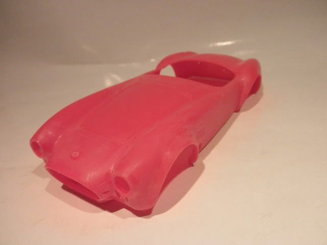

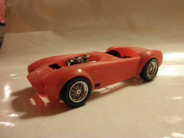

This is my newest project. I love these old Monogram kits, this one is looking very good, there are lots of parts and they are looking nice! Good looking parts there. Specially I like those wheels and tires. Bad thing is that this is molded to red... :D But that really doesn't matter too much... There are no chrome parts, those parts are looking like metal, not chrome... Good job, Monogram. This will be some kind of street machine...
It's great that this kit has very good top option, I'll be using it for sure... I painted the engine with blue, it's now painted twice, but red is still like "you can see it", must paint it one more time... I have also that Revell's new kit from this, It will be great race car, but this is going to be street machine...
But the biggest thing, I did today was tires and wheels, they were looking very good. I usually don't like BBS style spoke wheels, but these were looking very nice and that's why I'll be using them. I think, they are looking good under the Cobra too. These wheels are made very nicely, they are made from two pieces. There is the front side of the wheel, there are not so many spokes, but there is also rear side of the wheel. There are lot's of little spokes. Then of course there is some kind of brake drum/ wheel back... Rear tires are "Good Year GT Radial", you can see these tires in many kit's, for example Revell's '71 Buick GSX. There are no text but it's the same tire. Front tires are Michelin's tires. They are a little smaller... You can find those tires, for example Revell '66 El Camino.
Posted Image
Posted Image
Posted Image
Posted Image
Comments, ideas and tips etc. are very welcome!!!

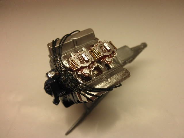

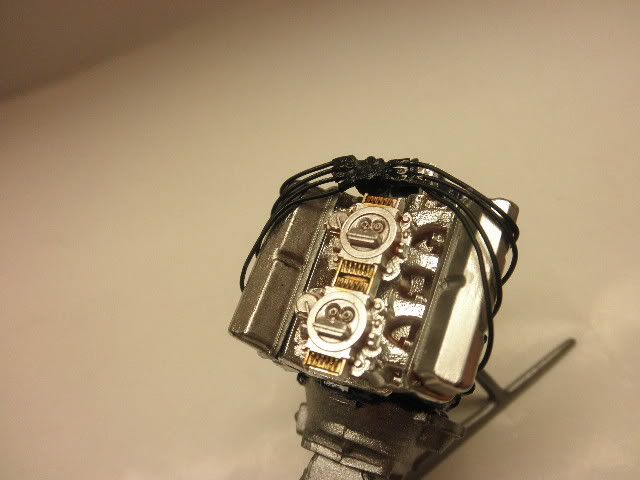

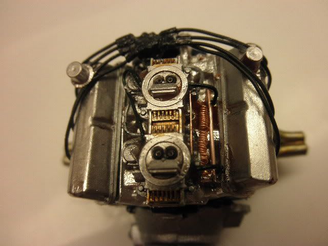

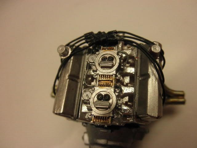

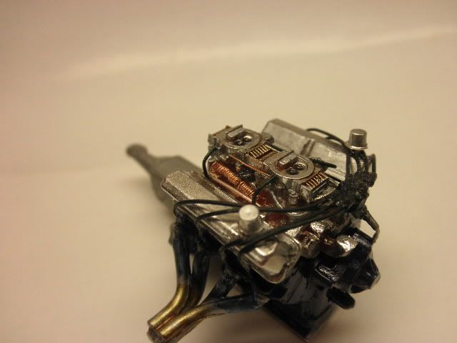

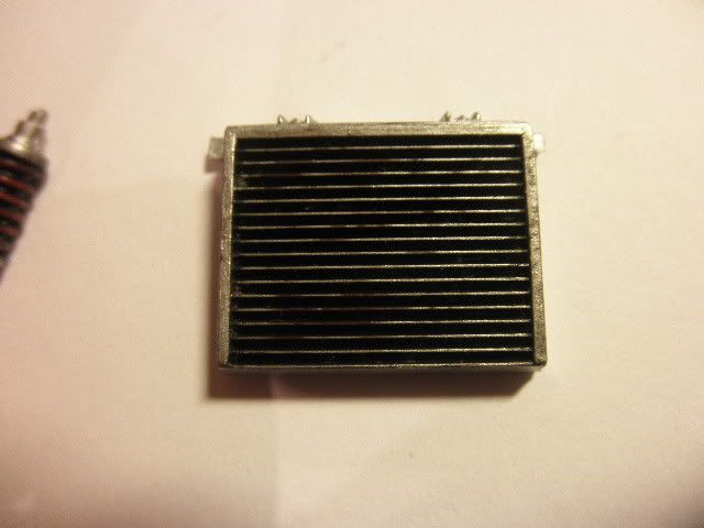

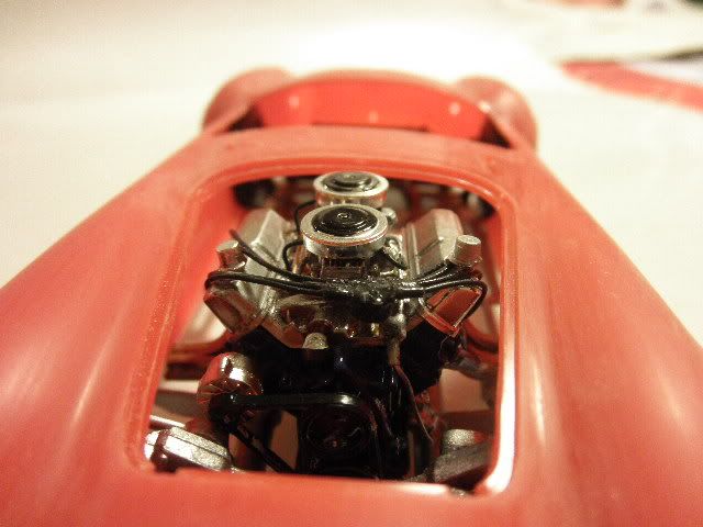

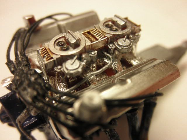

Little update to this one. Engine is starting to come together, now it's painted three times... Now it looks blue... Nothing special, it came together very nicely, there were no any problems. Valve covers and manifold fit perfectly! Transmission is painted by silver.
I also put plug wires to that engine, I have been using Detail Master's plug wires, stock wires, black. And red, black and yellow racing plug wire. But now I just bought Scale dreams black and red wire, there is 2 feet more material than in Detail Master's wire. It's matt coloured, detail Master's was shiney, and didn't look real. Now this is better, cheaper and so on. I use Scale Dream material!

#5 Cato
Cato
  • 2,063 posts
  • Location:Eastern East Coast
  • Full Name:See below:
Posted 13 November 2010 - 07:59 AM
Niko,
Your English is excellent and so are your building skills. Your carburetors are very well done but they can be improved. It appears you left some molding 'flash' around the linkage area and the vacuum breaks. I have removed the choke housings on mine so they look a little different than yours. Also the plug wires seem to replicate the 10mm drag racing wire not the stock original 7mm wire, A thinner set of model wires would improve it. See below:
Posted Image
Posted Image
Cheers,

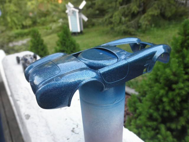

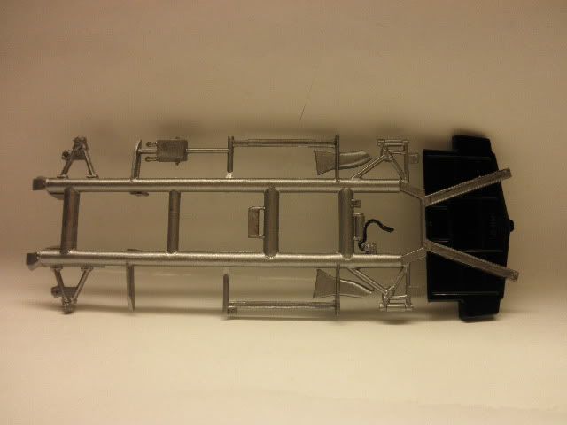

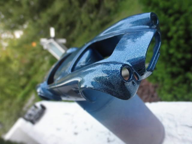

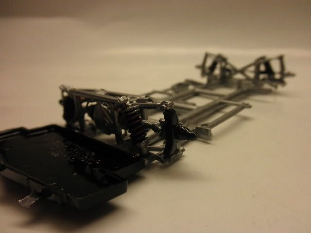

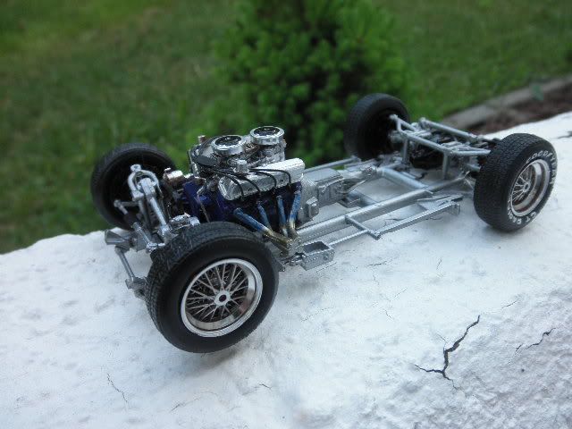

Some update to you! Today I have painted chassis parts, and the frame is also painted by silver. It looks pretty good, I think. The biggest thing, I did is the engine. Fuel lines are made from iron wire. I painted them by black. There was no fuel pump in the kit, that's why I found one from my "million box". Now I just connected those fuel lines and removed all molding flash from the carburetors. Lot better, I think. Headers are those, came with the kit now they are painted by silver, then I painted some clear blue and clear orange to them. Now they are looking like used...
Also I test fitted all of the body parts, I mean hood, top and the windscreen frame. Hood was fitting very nicely, no problem with it. But if the hood fitted very well, that top and windscreen frame didn't fit at all. Finally I got them to fit correctly with tape, but I'm a bit worried about how I can fit those painted parts... Is it possible that I put those painted parts together with tape and then using super glue, gluing those parts together from "wrong side".?

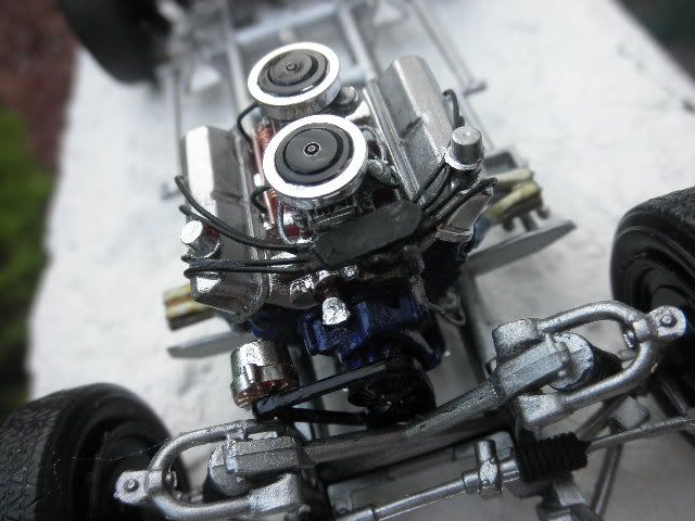

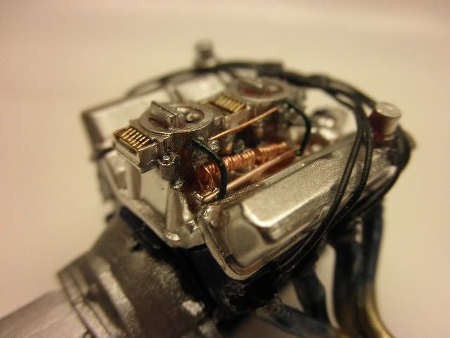

Thank you, Cato for those two pictures, they are very good, and there I can see how to detail those carburetors. Well, now I put some detailing to the carburetors, they are looking ok. I used different types of "metal wires", like MIG welding wire and stuff like that. Engine needs just few little parts, and then it's ready to be mounted to the chassis...
Also the chassis work is pretty much done. That frame is painted by silver, and that rear end is gloss black... I also painted those chassis parts. Most of them are silver, but there is used other colours as well, of course. Front axle system was a bit tricky to install together, but after all, it looks pretty good. Those springs are painted by black, and then some red to give some realistic look. Rear end was bit tricky too, but there were less parts than in front. Rear axle is painted by silver and black, now it's looking pretty good, only tires and propeller shaft and engine are still missing from it.
Now I must start interior work also, and body must be primered, I have graved those panel lines with Trumpeter's graver. Radiator is first painted by silver, then I painted it by black and removed the black paint from it, now that looks more realistic, I can't explain better, because of my English, look from that picture.

#12 Cato
Cato
  • 2,063 posts
Posted 18 November 2010 - 04:34 AM
Niko,
The return spring for the linkage goes on the other (drivers) side of the engine. It is shorter and goes from the rear carb linkage back to a bracket bolted to the bottom corner of the carb. The thin rod is correct as you have it.
Both carbs seem to be mounted too far rearward-the rear carb is overhanging the manifold. There is an aluminum vent tube bolted to the rear of the manifold, behind the carb.
Study my photos above and you will clearly see all these things. Your workmanship is excellent, keep up the improvements.

Thank you for the nice words! Cato, as in your pictures, there are springs in the both sides. I must make that another one to that side also... I think, I leave that other thing just how it is right now...

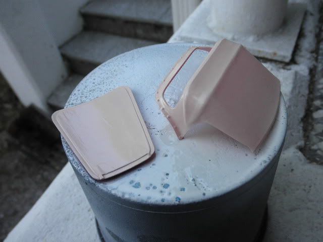

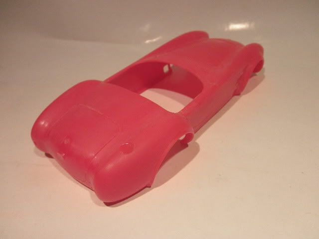

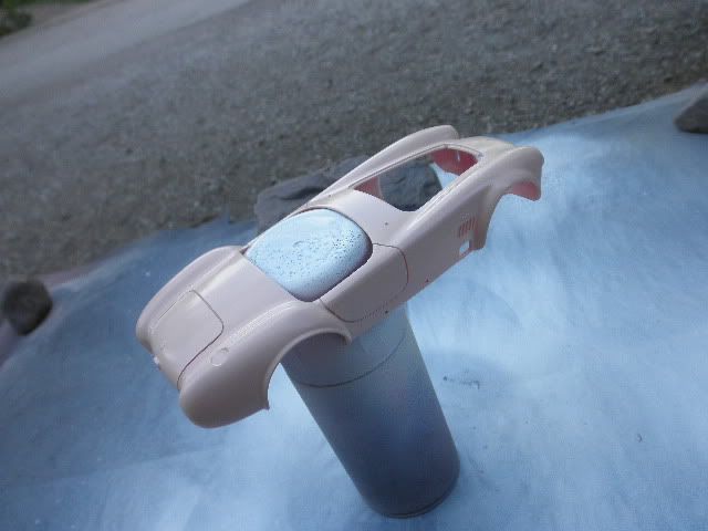

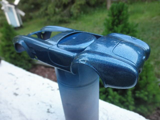

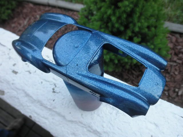

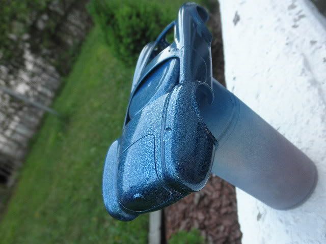

But now the body is ready for primer. I sanded the body with 600 paper, then finishing with 1000 paper. Now it's ready. I used an eraser for a push. That's because there comes no any bowles to the body. Eraser is better than piece of wood, because the eraser is not so hard stuff... But anyways, there were pretty much sanding on the body, the wrong side of the hood, there were some ejector marks. I removed them with sandpaper. Now these parts are ready to primering.

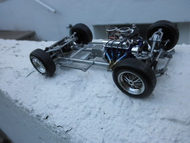

Now Shelby Cobra is on four wheels. Tire and wheel combo fits perfectly, no problem with that. But I did little mockup, to check the ride reight and if I must make something better. No problem with that also... But when I test fitted the engine to chassis, it fits just perfectly, but when body is in place, engine system doesn't fit under the hood. Don't know, what I have to do for it but maybe I built new engine mounts or just do some modifications to those old ones... Don't know really what I have to do, I have also one hood with scoop but I really don't want to use it...

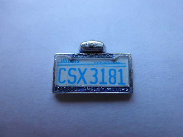

An other thing. I built that register plate frame ready to be mounted. I painted around of those textes by blue and then removed the paint off from the textes. Illinois plate is lots of better than "COBRA" what's also in the box... Next step, I must make that engine to fit and then primer the body and of course more work on the interior.

Don't relocate your motor. It is just fine. You mocked it up without the assembled interior tub. The body sits down to far without it. I just finished two Cobras this year and one of them is this street kit. Assemble the interior with the dash and top of the tub attached to the base and do another test fit.

DanielG: How those rear tires are wrong scale? I'm not sure that are they from this kit or not, but they fit fine. Those wheels fit also perfectly to them, and that's why I think that they are from this kit. But I can be wrong also.
Sport Suburban: Thank you for the info, I must build that interior right now, before I paint the body and then I'll do an other mock up. I was thinking about doing some modifications to it, but I thought that it would be better to look here first and it was really good thing!
