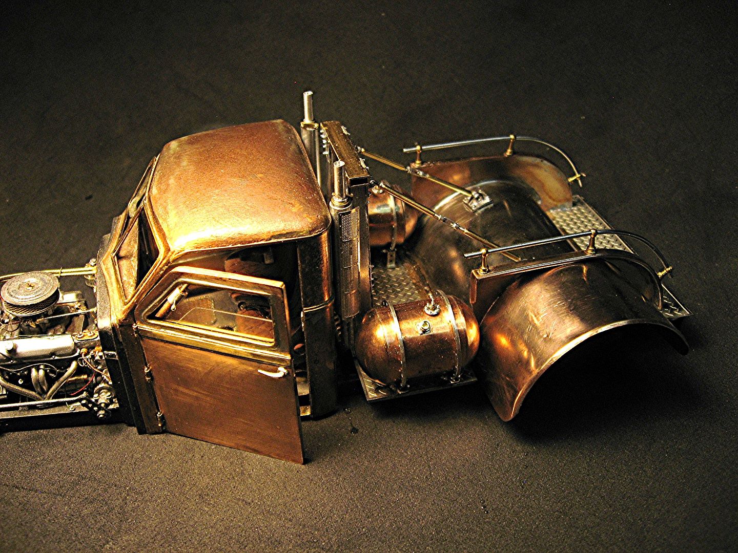

001_zpsc6cc35dc.jpgHi Folks,

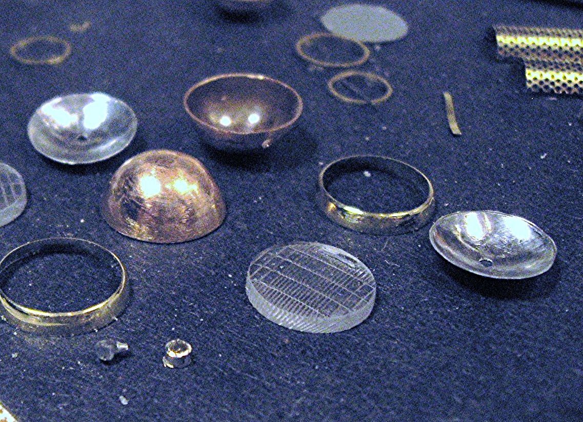

       Just a quick reply to an email I received asking about the real glass....
         It is microscope slide covers.
  You scribe a line with the carbibe tip tool and snap it apart.  I use the flat side of a moto tool cutoff wheel, diamond kind, as sand paper to smooth the edge if it does not break clean.
 I was hoping to get more of a real glass reflection over the typical clear styrene but to tell the truth I don't think it was worth the effort.
   If your are interested I get mine from.....www.cloverhouse.com
   Thanks,
   randy

Man, I just love this truck, Randy. The variations in raw metal work so well together. Topped off with your skill and workmanship, it's just an unbelievable feast for the eyes.
I picked up some similar glass a while back for my Model-T. I found a 100 piece pack, slightly thinner at .005"  for a pretty decent price at a local school science store. I broke several pieces trying to cut them with a traditional glass cutting wheel. Then, with some googling, I found that the trick is the carbide tipped scribe. That works quite well. The diamond wheel sounds like a good idea for smoothing the edges.
Thanks for sharing. Every part on this truck is a modeling lesson on it's own.

Randy - By using glass, can it stand heating for soldering, such as a closed frame like a model T?  I understand the desire for a real glass reflection, but I have not been pleased with just having the piece glued into a frame with no back structure.  What do you think?

Hi Pete,   Hope so :)  :)    Planing on using it for my front windows with it being captured in a frame.  I did put a torch too it just for fun and actually got it to curve.   Thought it would only be good for flat applications but maybe not!
         Randy

Hmmmmmmm........a new material to tackle.  Have to get me some of these. It would be nice to have a clear material that you could throw into some acetone to clean.
Ok, just orders some.  They are cheap enough at $5.50 for a box of 100.  That way I can break a few while learning about them and not worry about it.

What's next, A curved windshield in scale made or real glass? If you could make that I think you would forever be remembered as the man who could build anything in the modeling community.

Sorry that no pics came thru ,   seem to be having issues getting a post right tonite !
    Hi Austin,   Lucky for me this truck has all flat pieces :)   Still playing around with the glass, can get it curve with heat but hard to control.  Need to find larger pieces of this thickness to have something to work with.  I had sent Bill D.  some pics showing the size of the slides  to see if would work on his'Cuda...
Research continues.
Small update,   Building up the gas pedal and linkage along with some work a dash...
