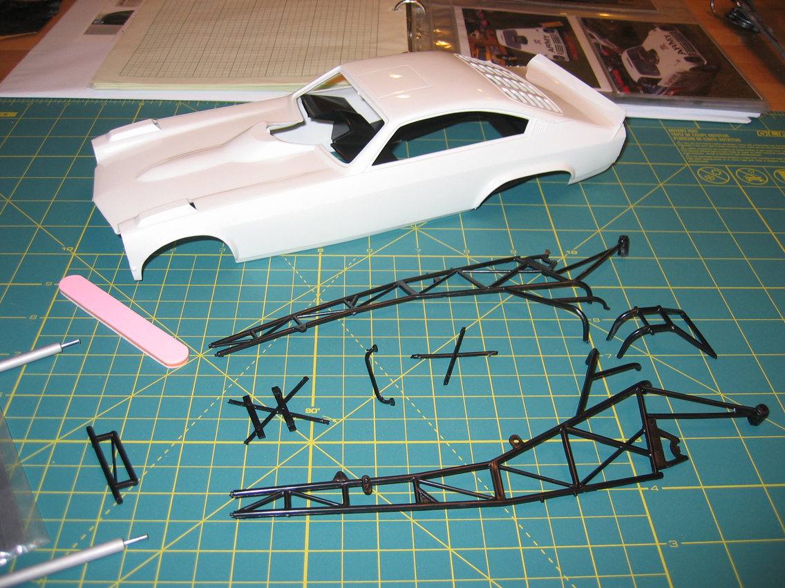

I have started a new build about a week ago of Revell's 1/16 Scale Army Vega funny car kit. I picked up this kit little over a year ago and have been anxiously waiting to start building it. Decided I couldn't wait any longer and just gonna jump into it. Been thinking for a bit of what all I wanted to do to the kit and have picked up some aftermarket items that I will be using on it. I will be posting progress pics as I go. Hope you all will enjoy the pics. With all that said let me get to it....
The Subject.... Don Prudhomes 1974 Army Vega Funny Car
FRONT VIEW:
SIDE VIEW:
THE KIT:

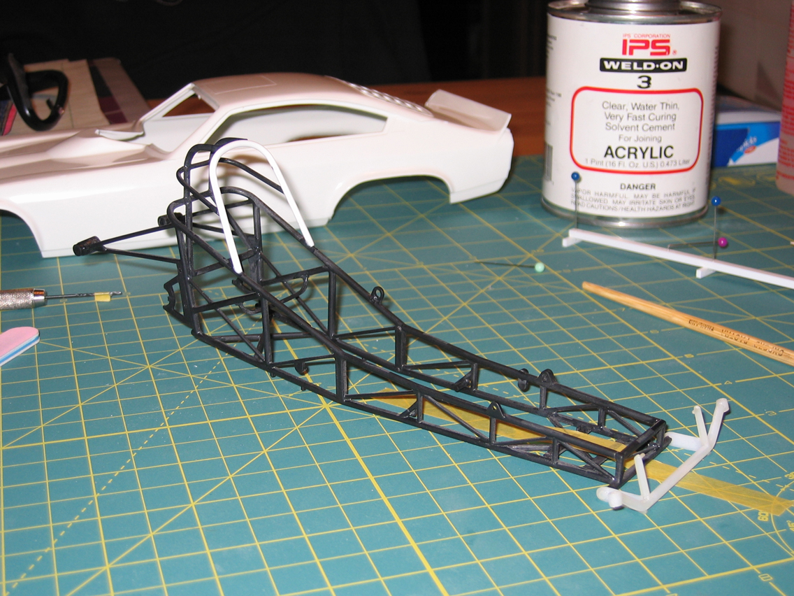

The start of the build cutting the frame pieces off the trees, washed with soapy water and ready to get worked on.
After putting in some hours and elbow grease on sanding and filing the mold lines. It was time to start gluing the chassis together.

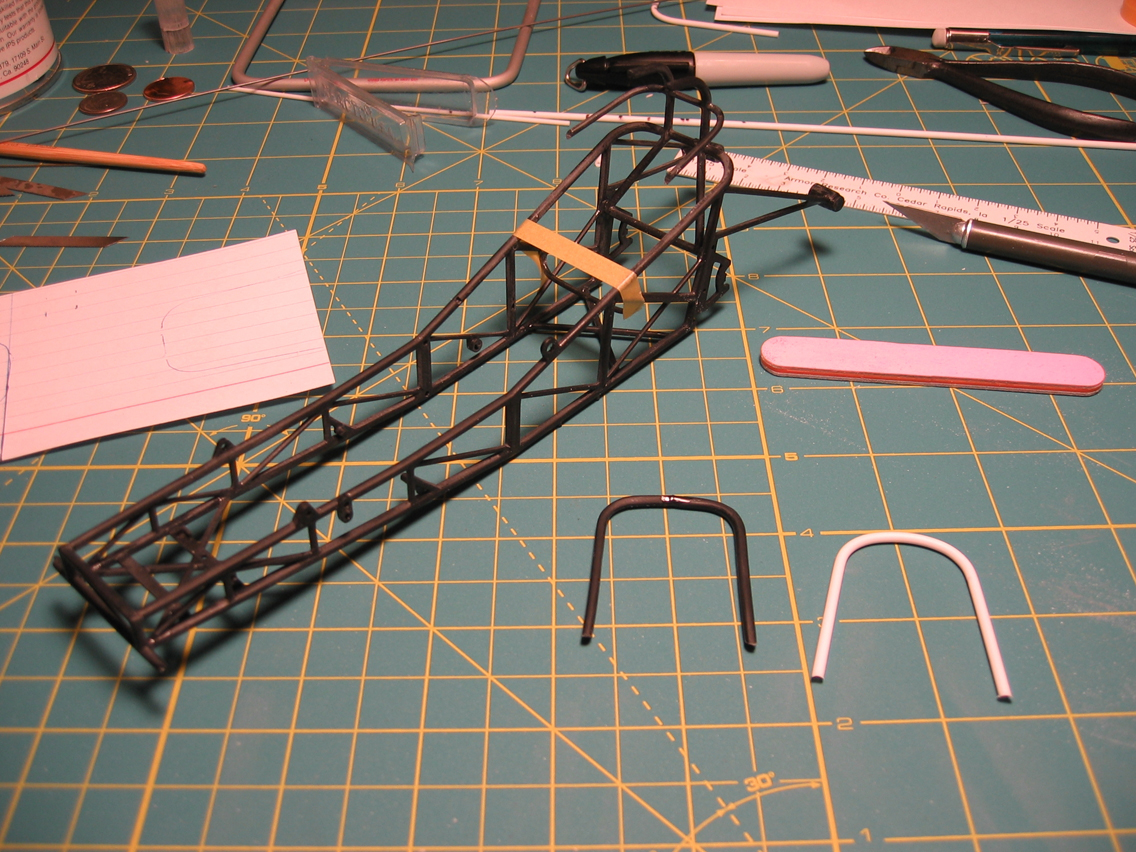

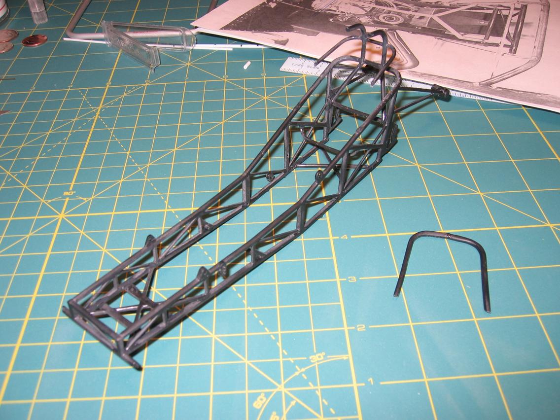

Cut away part of the roll cage area to fabricate a new bended piece
Fabricated the new piece to go onto the frame

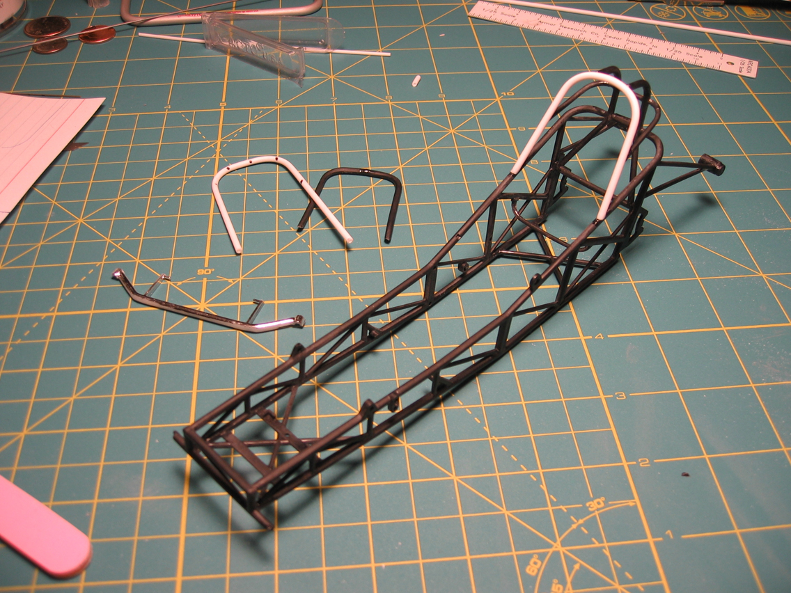

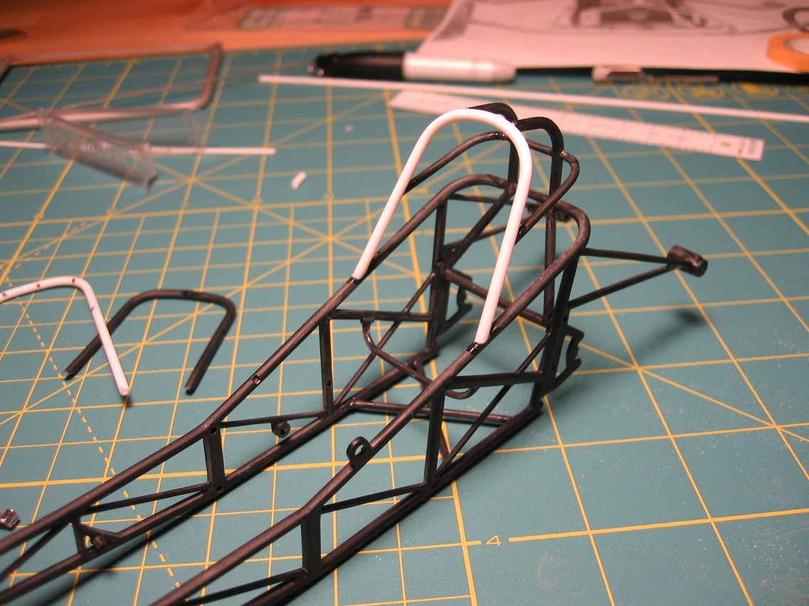

After gluing the new piece in place

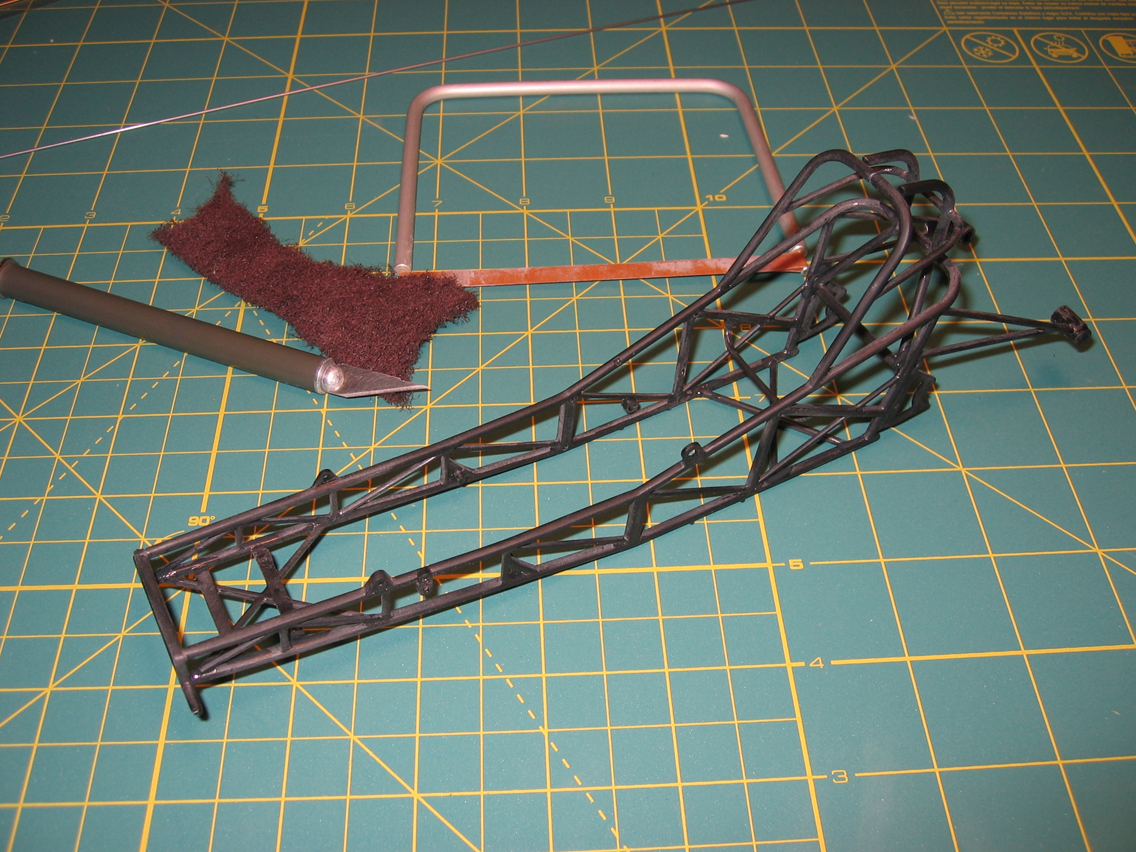

Upclose of Roll Cage
I have been enjoying this build and can't wait to get more progress done on it. So far I have about 10 hours put into this build at this point and felt like I was never going to be done sanding mold lines... :lol: Hopefully I will be able to make some more progress this week and will share more pics

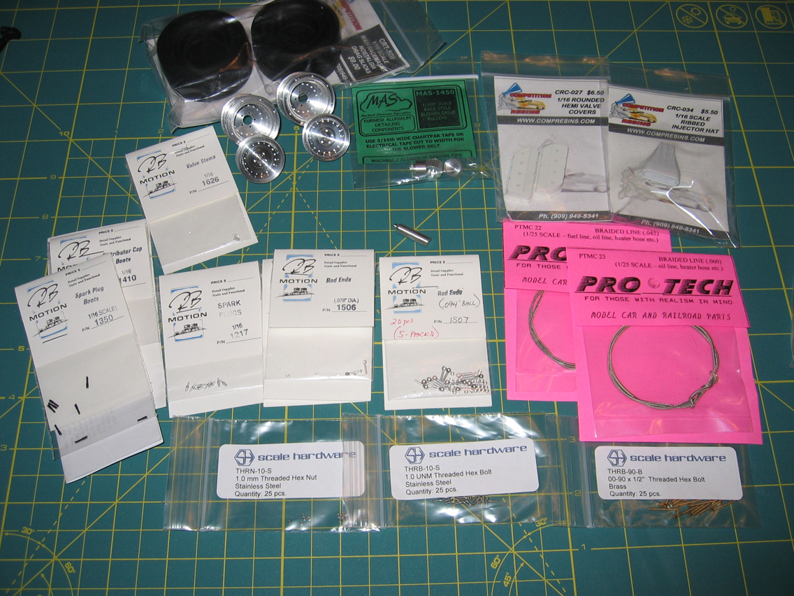

Just a little teaser pic of a few of the many aftermarket items that will be goin on this build. I forgot to add a few packages of A/N fittings from RB motion in the pic but will be using them too. I started cutting some of the front end pieces off the model tree. I removed the chrome on the front end parts among the rear end, bell housing and what the kit calls the firewall by soaking all in a cup of amonia. I think I will be working on fabricating the new linkages with rod ends as well as making new mounts for them on the frame and front axle next.

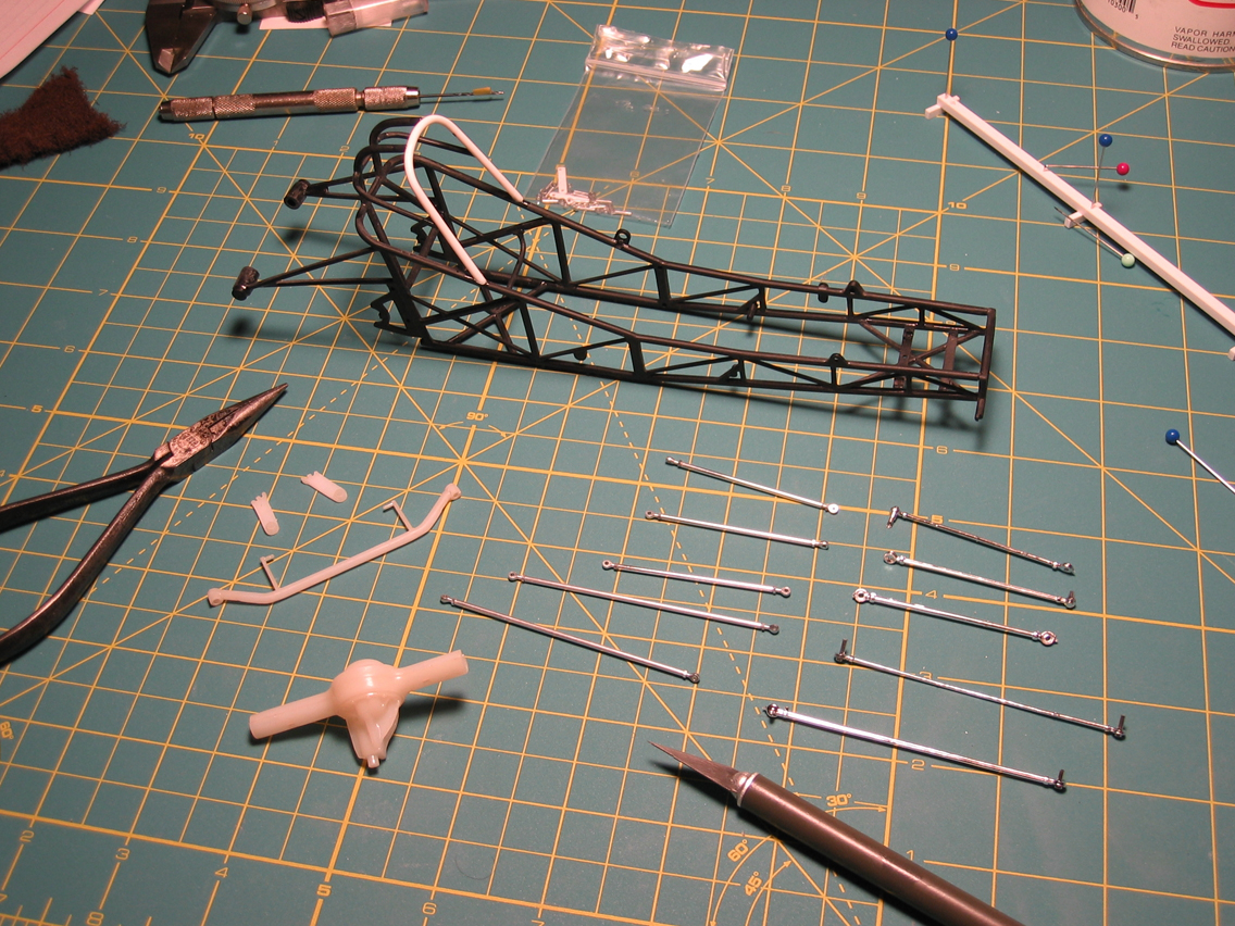

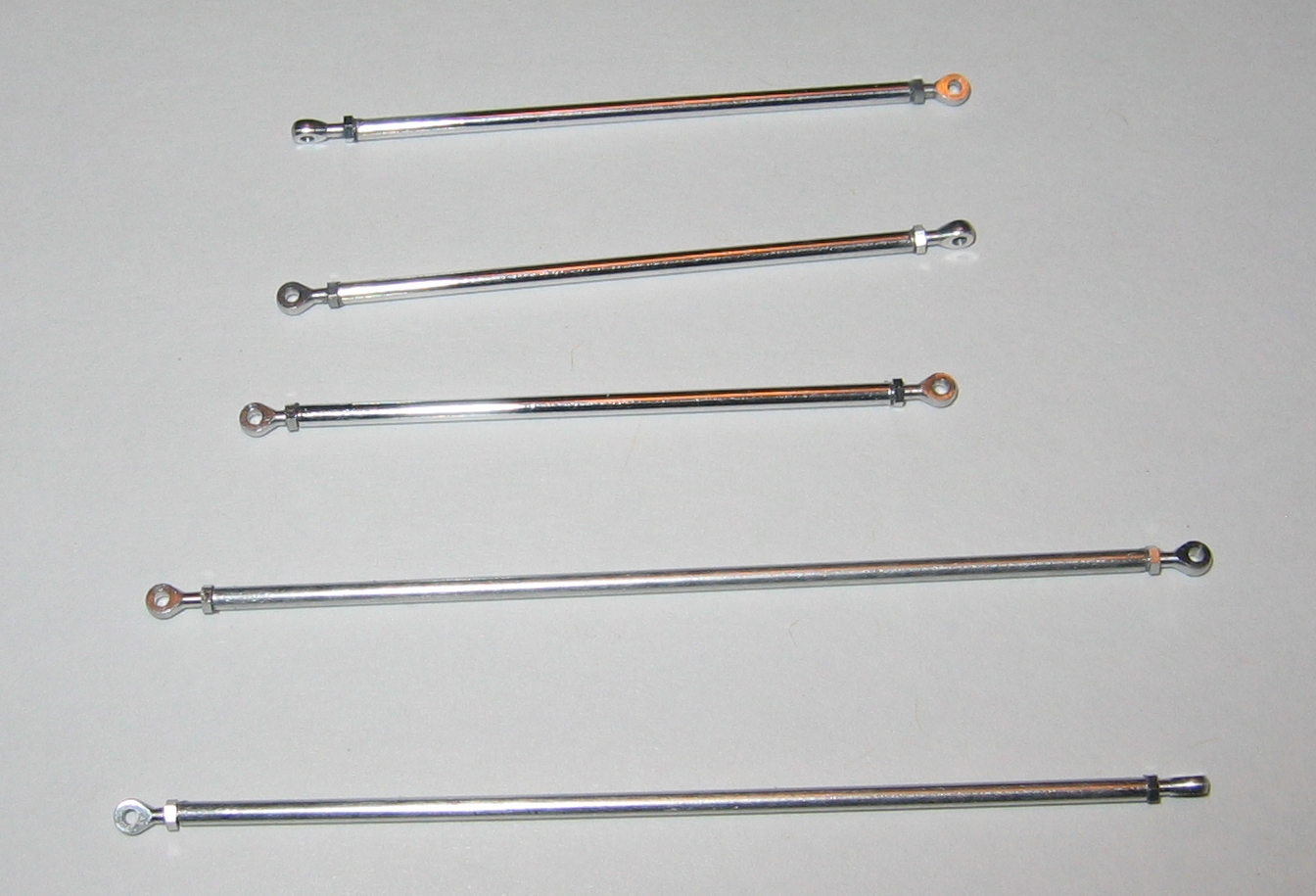

Did a little bit of work on this build tonight. Started out making a jig to hold my parts in place. Drilled holes in some strip styrene and have different holes in the jig for different lengths of the rods I am making. I am using RB Motion rod ends and aluminum tubing. Going to mock them up and glue temporary with Microscales Micro Kristal Klear. Get everything test fit onto the chassis since I am making new tabs that will get glued to the chassis and front axle. Once I am happy with how everything fits, I will go back polish the tubes and then glue the rod ends in with 5 min epoxy. Hoping to make more progress on this tomorrow.
Posted Image
