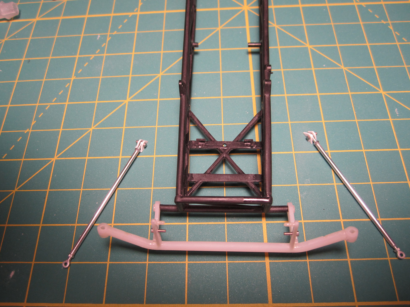

I wanted to share a little more progress I made to this build last night and tonight.

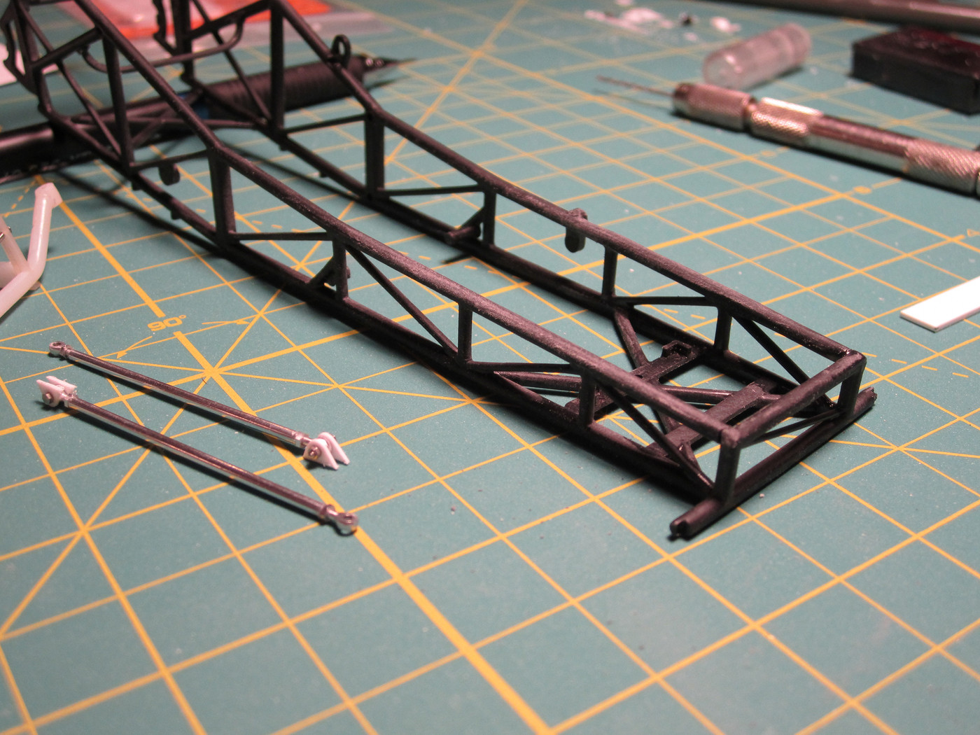

I removed the chrome from the rear end and front end pieces, glued the rear end together. Fabricated a new tie rod, Radius Rods, Forward Drag Link and Rear Drag Link using 1/16" dia aluminum tubing and RB Motion rod end's. Parts on the right were the new fabricated ones and the parts on the left are the parts from the kit.:
Posted Image

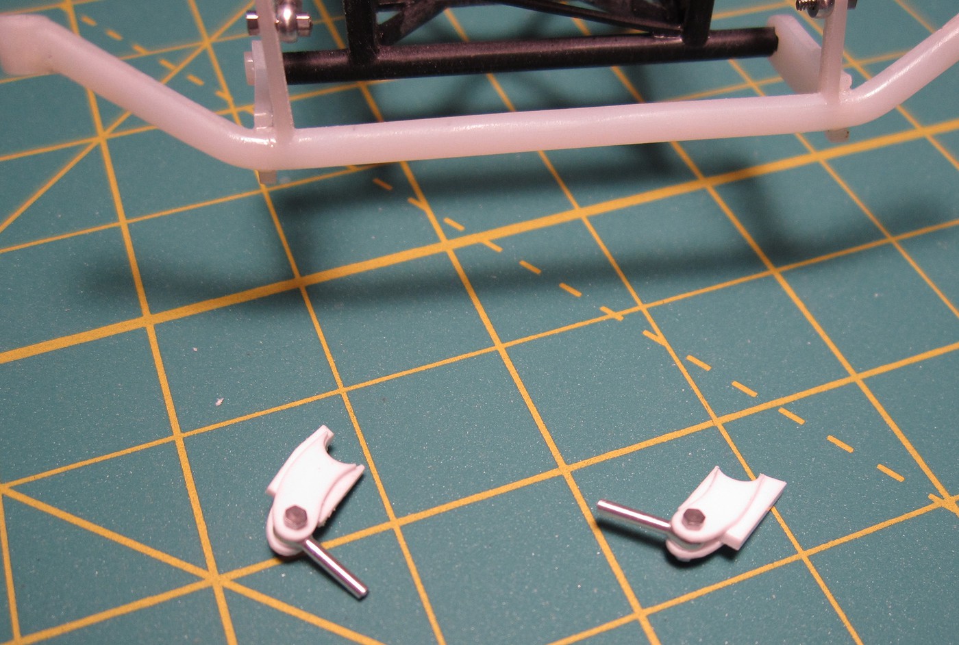

Up Close shot of the new part. The top 3 parts have been polished and I still polish the bottom 2:
Posted Image

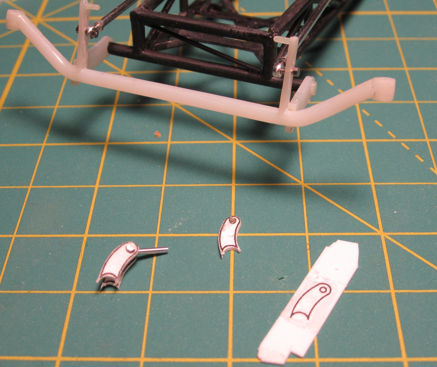

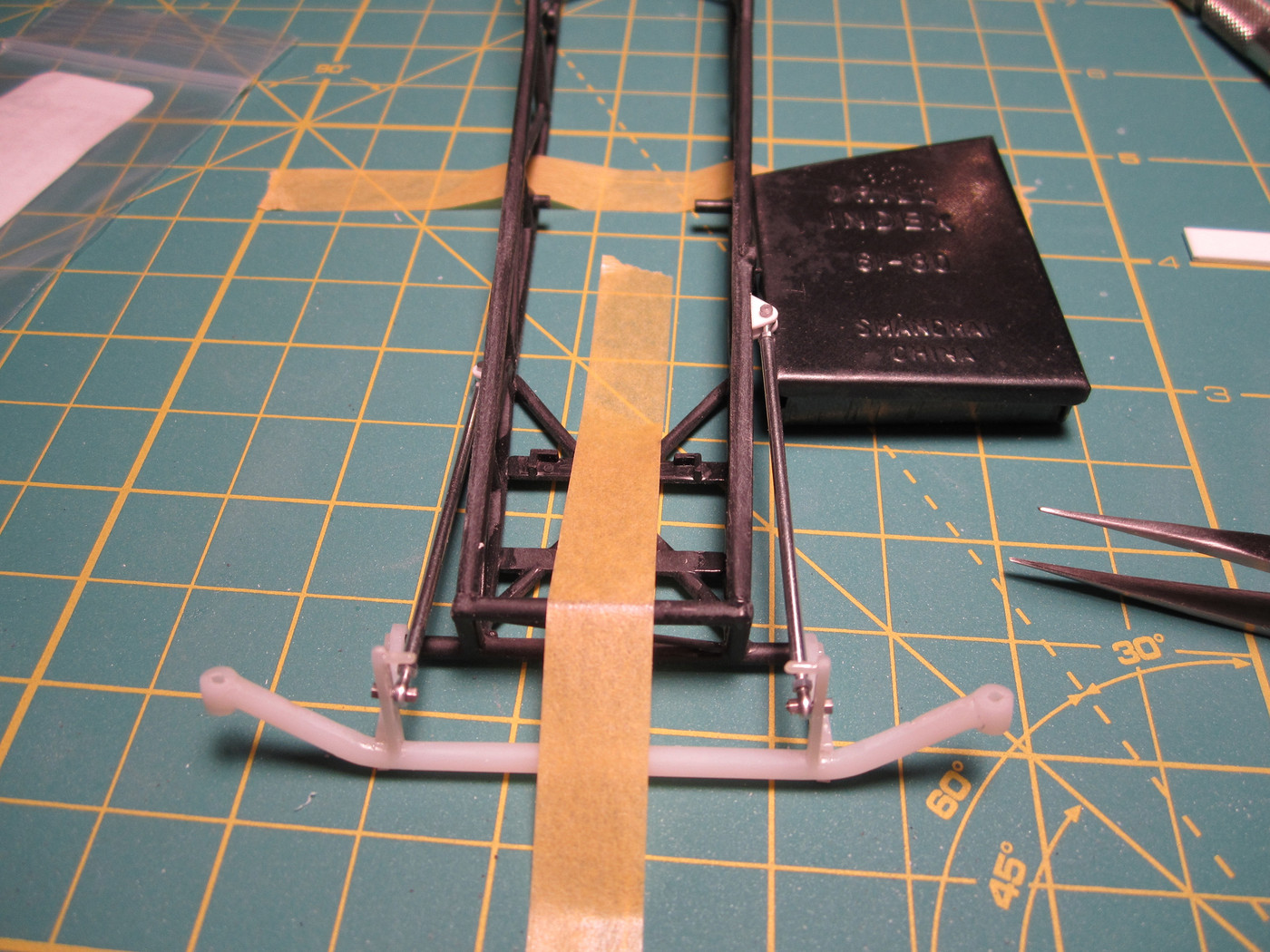

Gluing the front axle to the leading links. The next step I plan to modify the towers that the radius rods attach to as well as the tab that are sticking vertical on the chassis for the radius rods. Going to remove them, fab new ones and install them horizontal as in some reference pics that I have of the car:

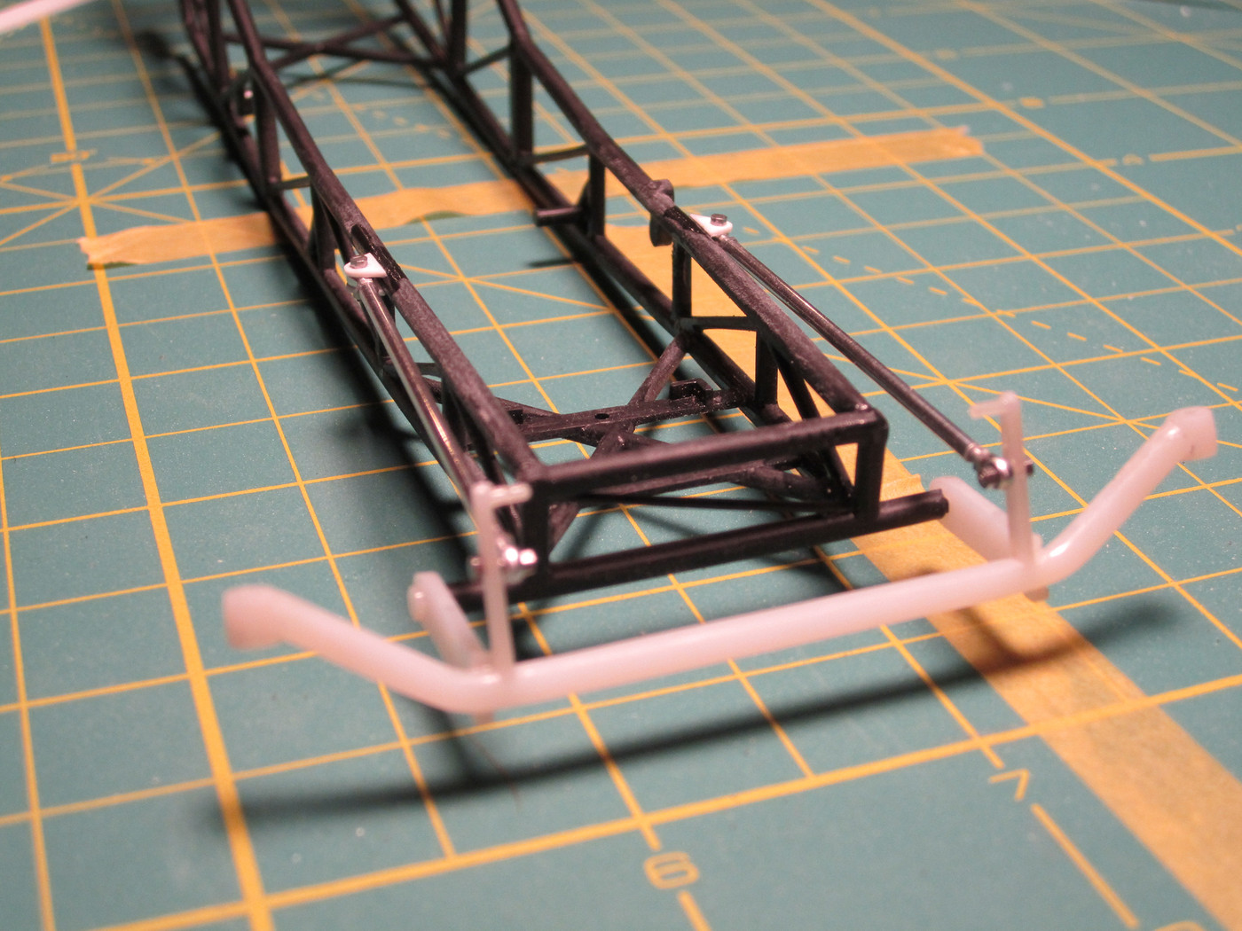

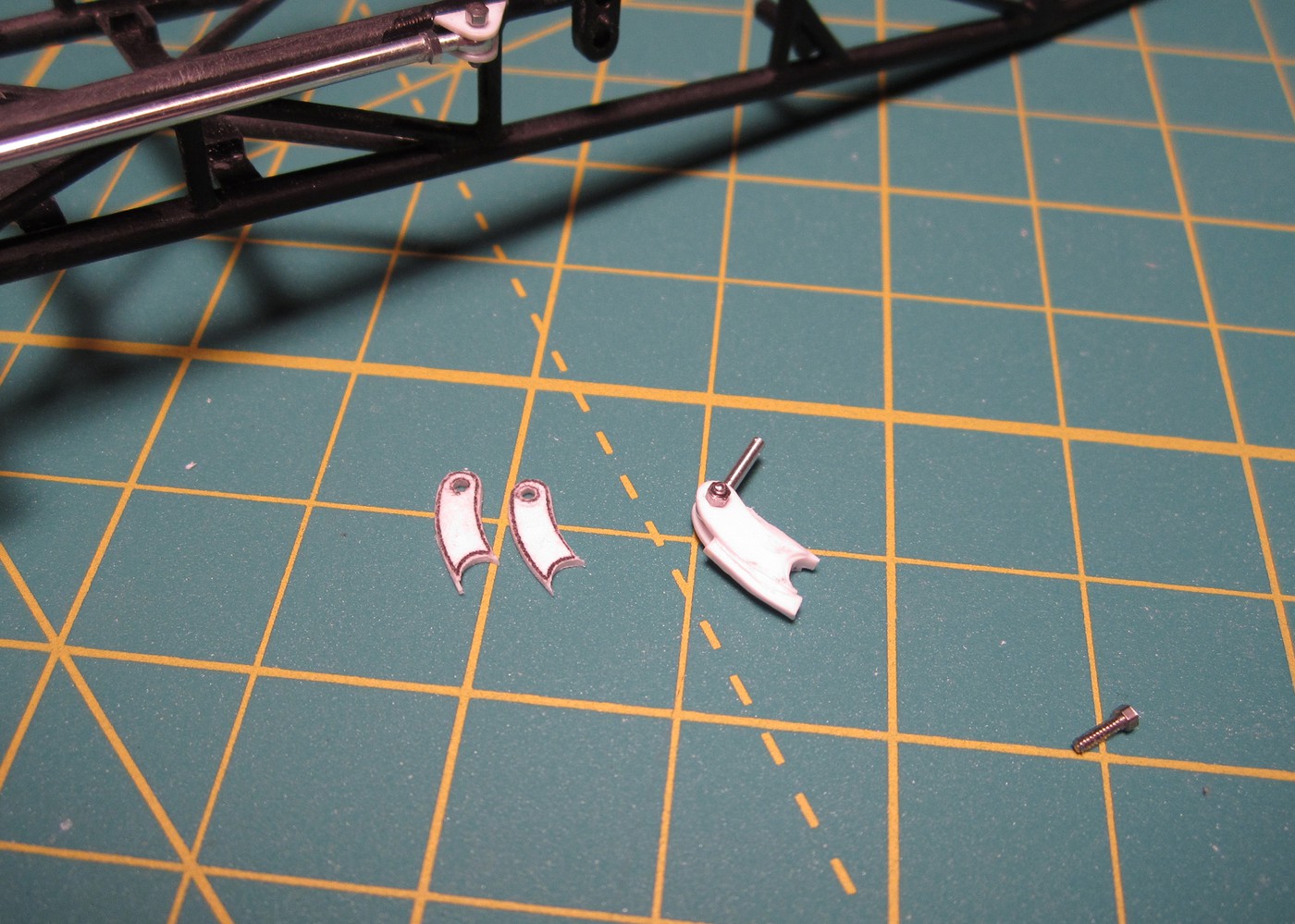

Tinkered a little bit tonight with making new flanges for the Radius Rods to attach to the frame. Going to cut and sand off the existing mounts next, the tabs that stand vertical on the chassis. I know these pics don't show much work done but I am making progress little by little :lol:
Posted Image

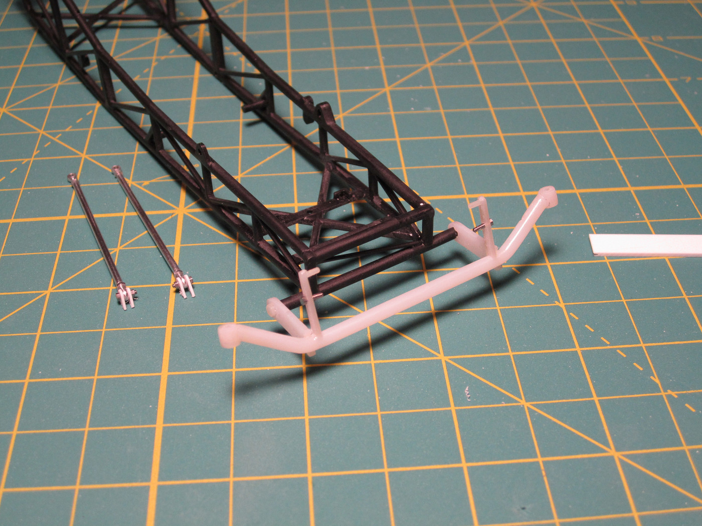

Once I get the tabs glued on to the frame I will be modifiying the mounts for the radius rod onto the front axle

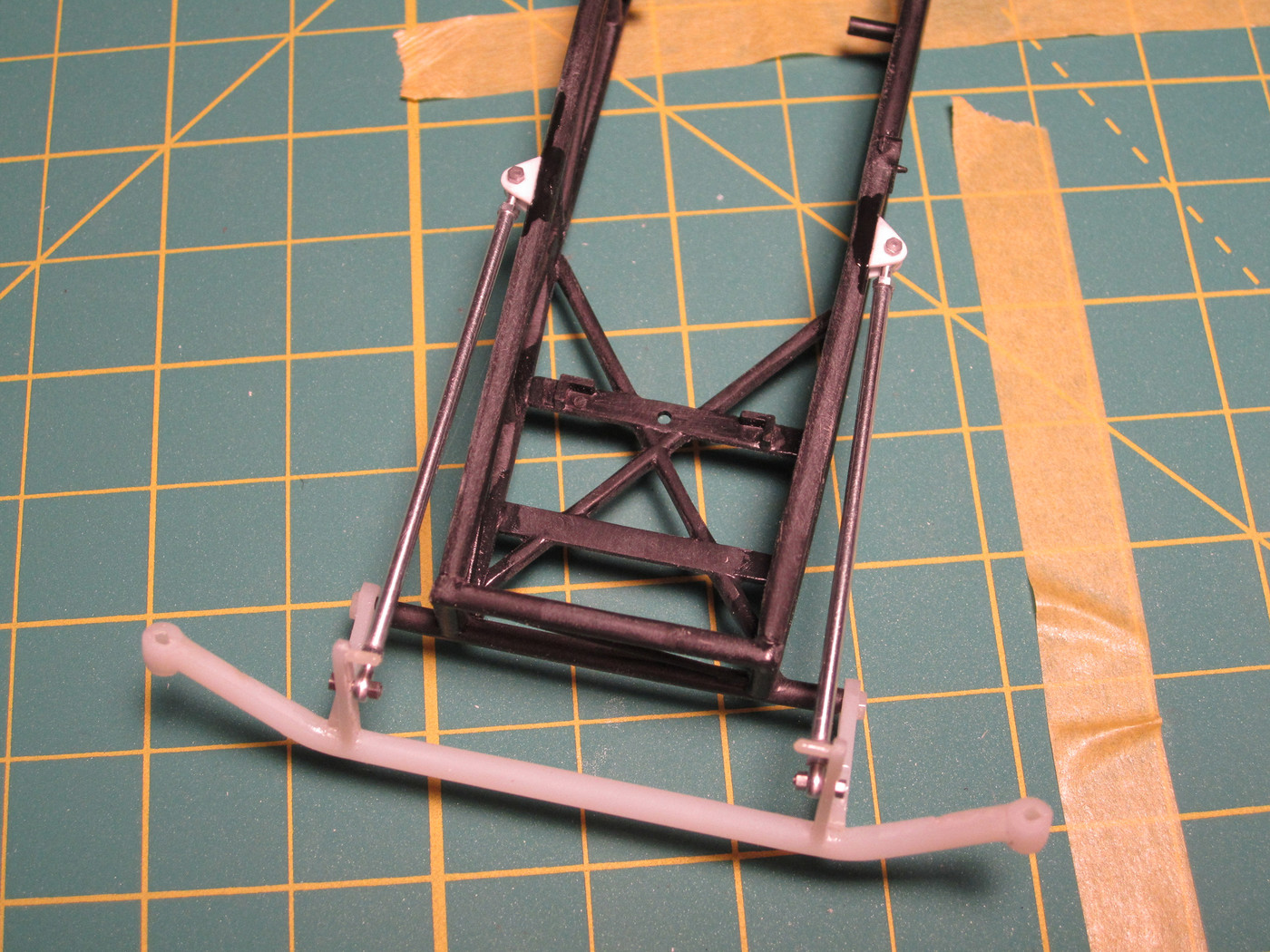

few more pics....
Removed the Tabs from the chassis:

My make shift jig...using my drill bit box to hold the parts up... :lol: what can I say it with the right height :lol:

Glued:
Posted Image
Going to leave like this over night so the glue will cure, then will remove the Radius Rods and add some more glue and supports to the inside of the tabs for a little more strength:
