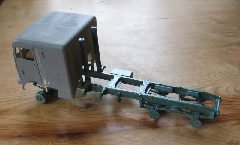

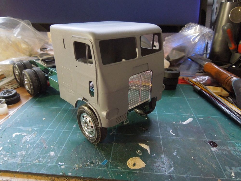

Posted 27 June 2011 - 06:16 AM
OK, go easy on me... I know a lot more about old cars than I do about trucks. :blink:
I've sprayed a couple of colour coats on the frame. I was thinking of doing the cab this colour with some kind of white stripe design. There's a long way to go on the cab yet - still unsure about what steps to use. I might just use the kit parts, but I'm thinking about filling the gaps and making some simple stirrup steps. Any suggestions?

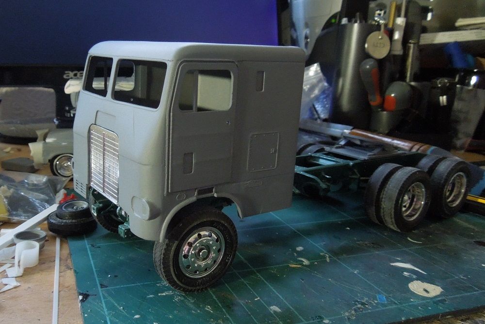

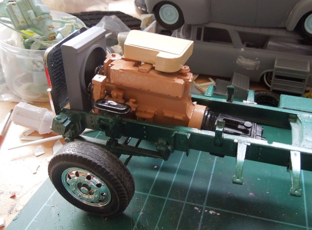

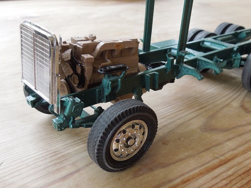

Posted 30 July 2013 - 07:52 AM
Bumping a two year old thread (a) so I can find it and (b ) because I've finally found some time to do more on it.

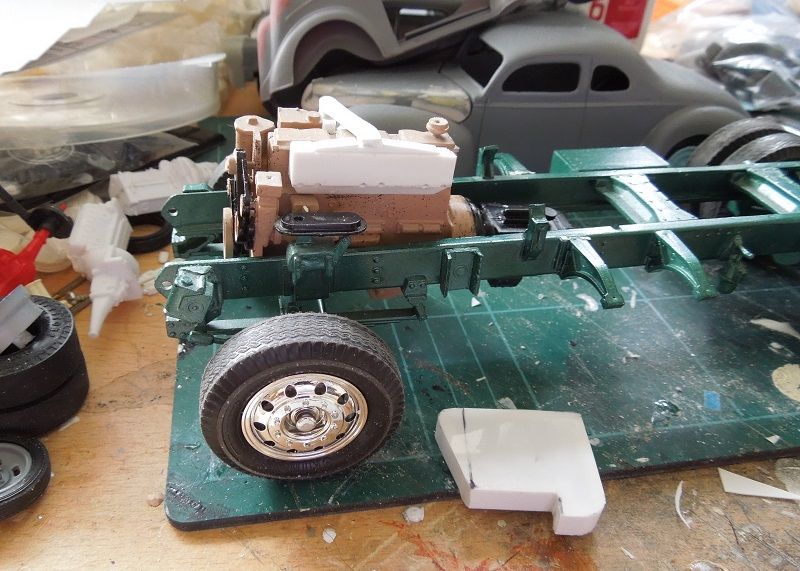

Engine is mostly complete and I've mounted the front wheels.  Rather than narrow the axle, I ground down the hub mating surface on the inside of the wheels and took some material off the brake drums.
I was toying with the idea of swapping in a DD V8 from another kit, but wasn't sure what to do with the air intake.  I wanted to add an air intake stack and frame mounted air cleaner, but couldn't find any reference photos.  How common was the front air intake?
Edited by dodgefever, 30 July 2013 - 07:52 AM.
#8 BigBad
BigBad
  • 1,429 posts
  • Location:somewhere
  • Full Name:Robert Poudrette
Posted 01 August 2013 - 01:16 PM
Nice job on the headlights! Go with the DD! Freightliner was different for the air filter arrangements... From the factory, they had a couple configurations. one with the front inlet like the kit, and you had some with a stack right in the middle in between the exhaust stacks, you even had some with dual stacks if you had a DD12V71 or an other high powered engine. I have seen one with a DD 8V92 on U-tube that has two cab corner mounted intakes. But one thing I haven't seen (yet) is a frame mounted filter on these. They usually are mounted either under the cab or behind it. For the steps, you could get some good ones from P&P resin. They are of similar design as the ones from the kit except they are closed off from behind and are one piece. They are more accurate and no hassle trying to put them together correctly.

Other mounting locations:  Cab mounted snorkle left outer corner, inset into the corner or recessed into the corner.   Frame mounted canister was available.  Freightliner was a custom builder and would build to suit the spec of the customer - so pretty much anything was possible.

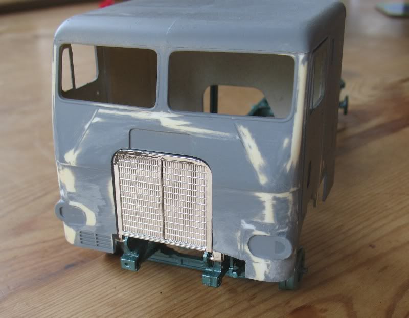

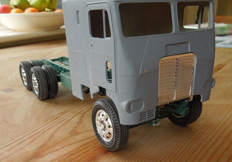

Posted 15 August 2013 - 01:12 AM
An update.  I'll take better photos when time permits.  These should show the narrowed front track and lowered headlights.  The cab still needs a lot of work...  I've decided to fill in the step openings, so that's next.  I'll make stirrup steps out of wire.

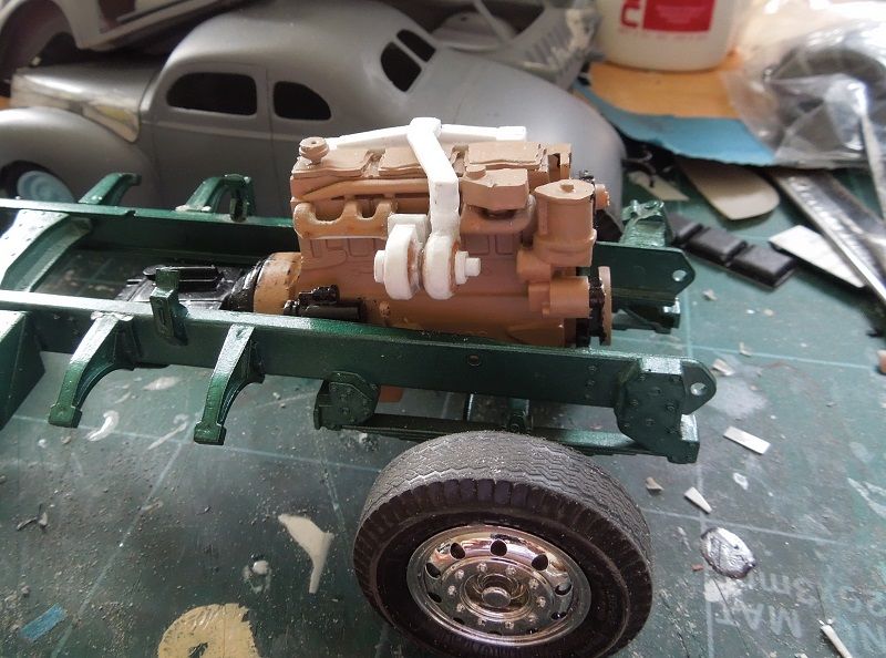

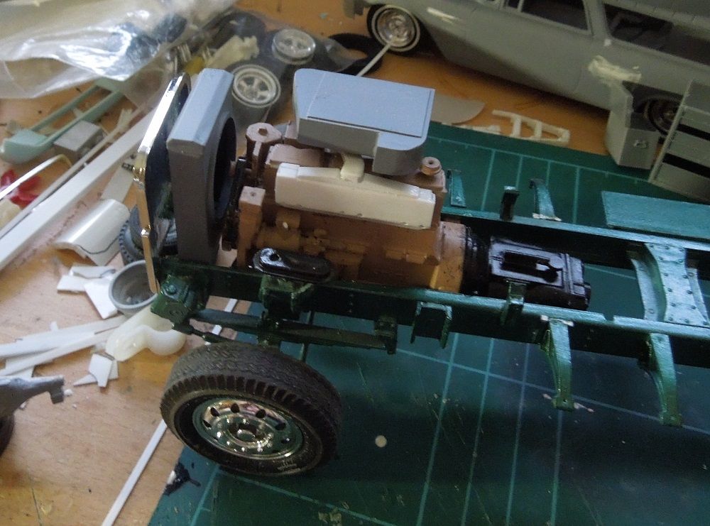

Posted 30 August 2013 - 09:34 AM

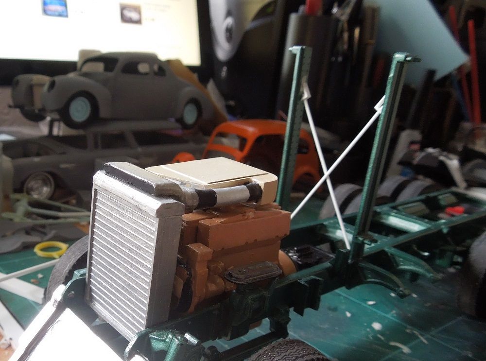

I've changed the plan on this and decided to add a turbo.  Not wanting to rob parts from another kit, I modified the exhaust manifold and scratched up a turbo, aftercooler and inlet duct.  I'll also make up a new Dynacell air cleaner with the inlet on the opposite side - there's a photo of this setup in an early '70s brochure.

Posted 01 September 2013 - 07:40 AM
Bump for some progress photos.  Turbo is installed and I've started on the new DynaCell unit.

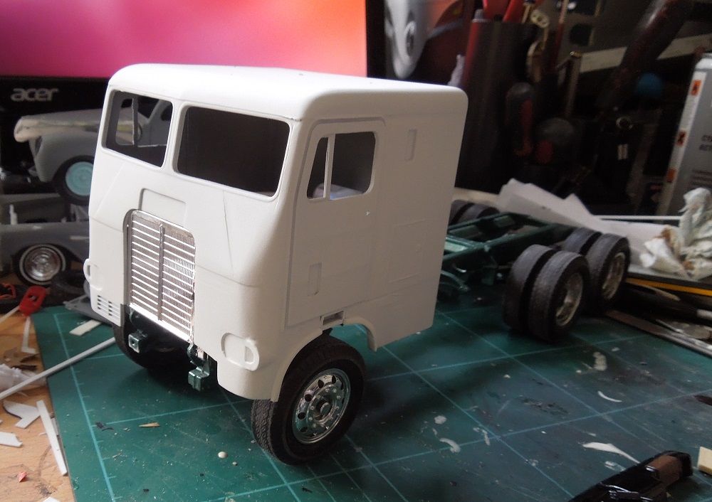

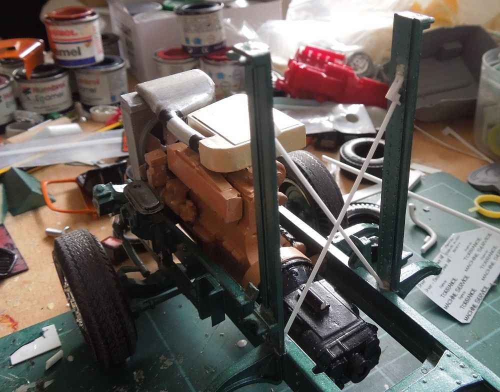

Posted 13 September 2013 - 01:08 PM
Slow and steady progress.  The cab still needs fettling, but after several fill-sand-prime-repeat sessions it's almost there.  I assembled the kit steps but wasn't happy with the fit, so I ended up filling the cab. I'll make stirrup steps.
I got a bit further with the new air cleaner.  It still needs bolt heads, but it's about done.  I've roughed in a new intake scoop and duct, but didn't take a photo...

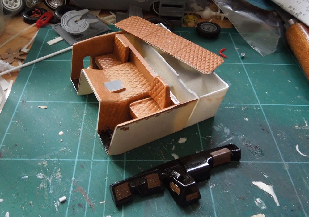

Posted 20 September 2013 - 08:37 AM
