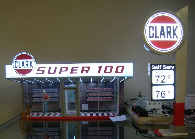

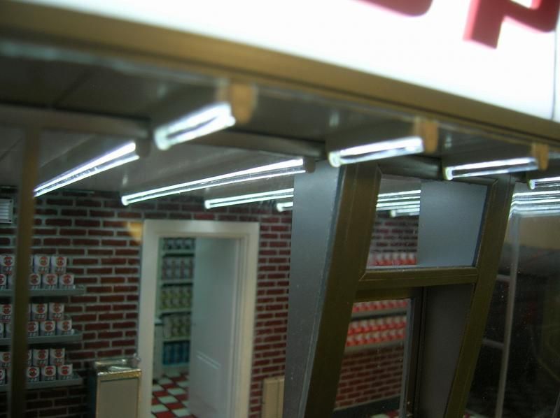

It looks like my fluorescent light idea might work. I was afraid they wouldn't cast enough light. I used a piece of .100 styrene for the ceiling, and cut slots for clear acrylic square tube. I masked a thin section of the square tube, then painted it. The protruding square tube represents the fluorescent light base. Over this I will lay a clear acrylic rod for the "bulb". The light shines through the slot (as in the picture) and illuminates the bulb (not added yet). Above the ceiling I will have a sealed off compartment containg a roll of LEDs. My concern was that the slots were too thin to give enough light, but it actually worked out pretty well. As I add more I'll post more pics.
By the way, the front small lights will work, too, they're just blocked off from the light source in this setup.
I also have "fluorescent" lights in the office and restrooms.Posted Image

OH.... WOW!!!

If this wasn't on a model forum I would swear that was the real thing!
Tom, your ability to accurately detail WHATEVER you work on is truly amazing! The work you have displayed is among the best I have ever seen and leaves me speechless and envious!
I remember the Clark stations in Northern Illinois where I grew up and looking at this is like going back 40 years for me! Like others, I am anxiously awaiting the next installment of this story!

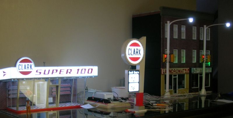

That eerie glow is exactly how i remember the Clark station on the corner of Miles Road and Hamilton Avenue (US127) just out side of Mt. Healthy, Ohio in the mid 1970s. The only difference is that all of your lights work.
