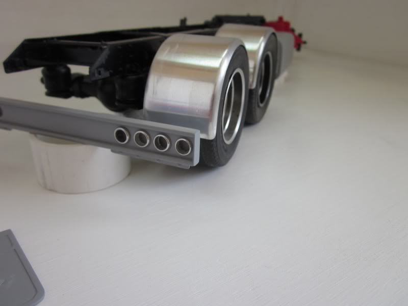

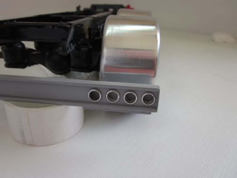

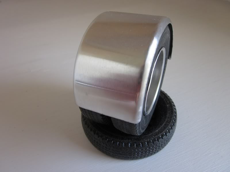

I have been working on these for awhile, making the tooling to produce the nice rolled edge was .......interesting, but I think I have solved it, these suit the KW 1/16th monogram kit, and I made them for a custom build that I have spent a few years on now, so many parts to make for it for it, oh well on with the show,
I am now ready to make all the brackets for them, these will be brass then chromed to suit
Ready to get the polish out and polish the life out of them

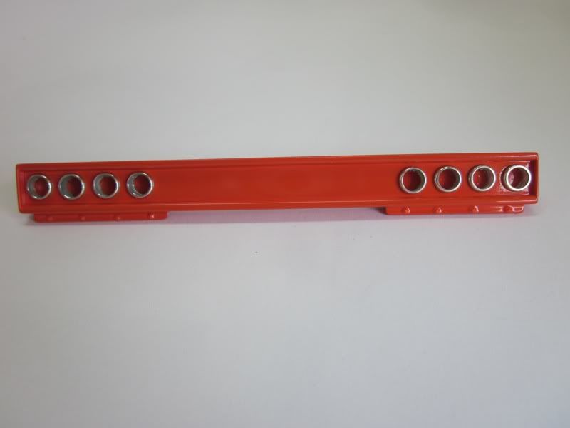

The light bar is ready to cast, I have made all the light bezels in Aluminium for this one, lot of work, but effective, also made a master for the lights as well, if I do decide to cast these, the light and the bezel will be cast as one part
Posted Image
Posted Image
Posted Image
Comments welcome, good or bad, can they be made better?

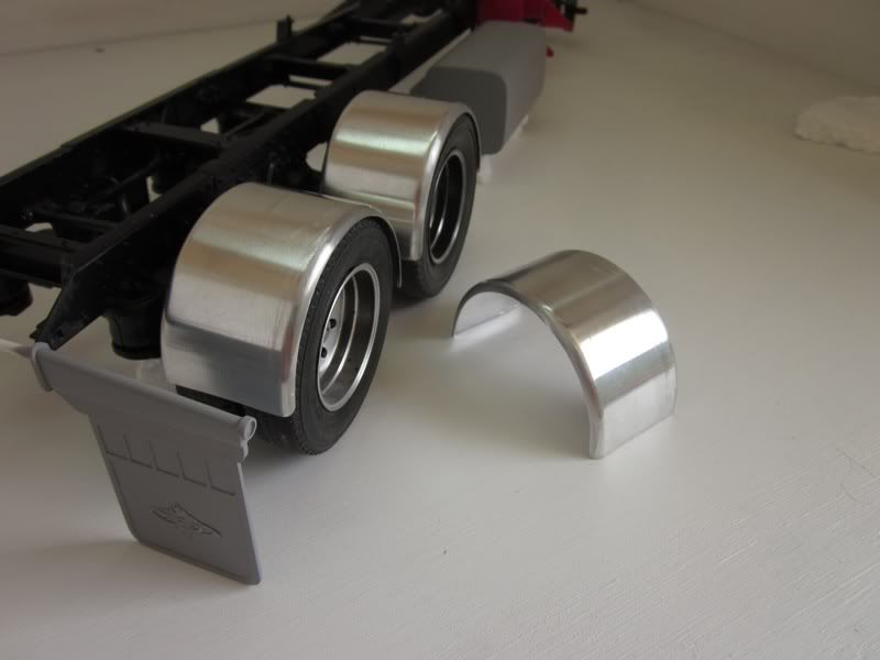

Very interesting, did you roll these just like on a 1:1? Curious to know how you were able to shrink the excess metal due to the fender curve and the rounded Lip.
#8 Tony Bryan
Tony Bryan
  • PipPipPipPipPip
  • 355 posts
  • Location:Sydney,Australia
  • Full Name:Tony
Posted 10 January 2012 - 01:00 PM
Evil, there is a trick to them for sure, and they do take some time to do, I have machined up a former to help get the shape, the Aluminium ones don't make that much "extra" as they are only 0.016" thick, the key to modelling is to trick the eye into believing what it see's, and if you can do this then you are half way there, when they are formed there isn't that much over hang on the former, but the direction change get's the eye to believe there is
I roll these on a long length first then cut to size, then form the edge
After the Aluminium ones where done, well formed, I had to try a brass one for a brass build I am doing, they are ok, but are a lot more work to do, and should be annealed before they are bent, and the

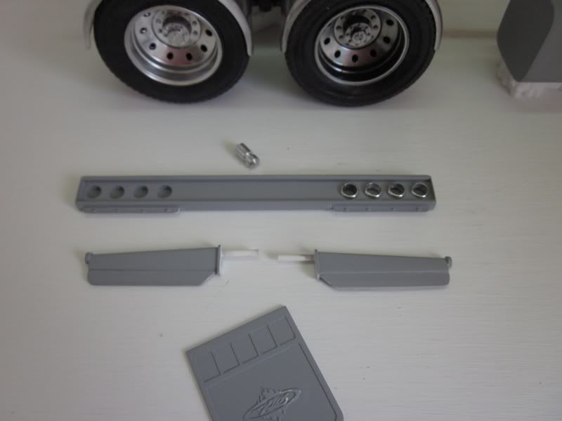

Posted Image
The Brass 1/4 guard is for setting the holes, when I am happy with the height it will be used for a Jig

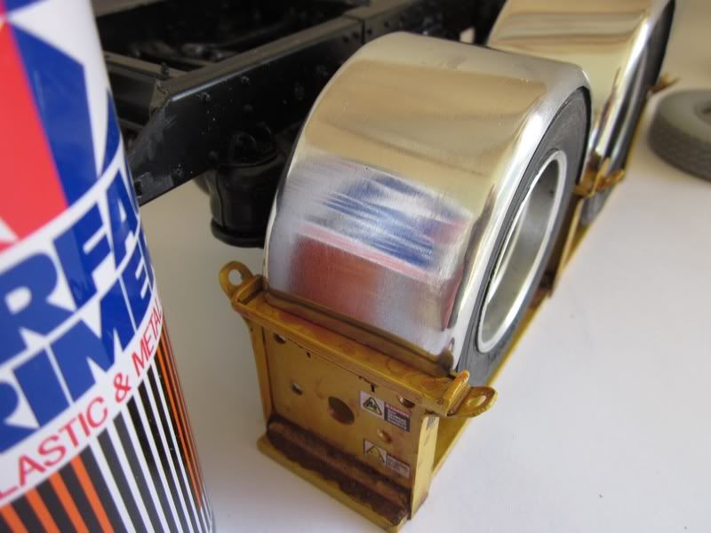

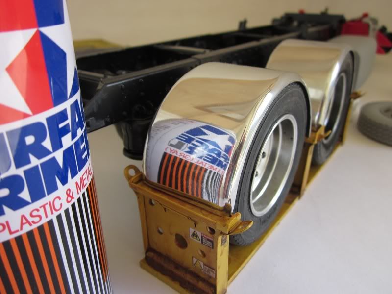

Before they where polished
Posted Image
After polishing
Posted Image
Not to bad for rejects

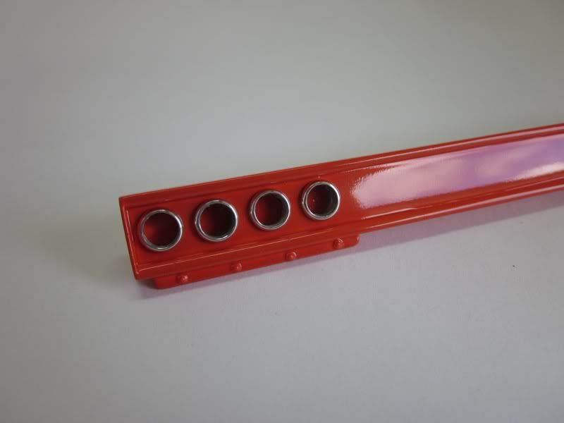

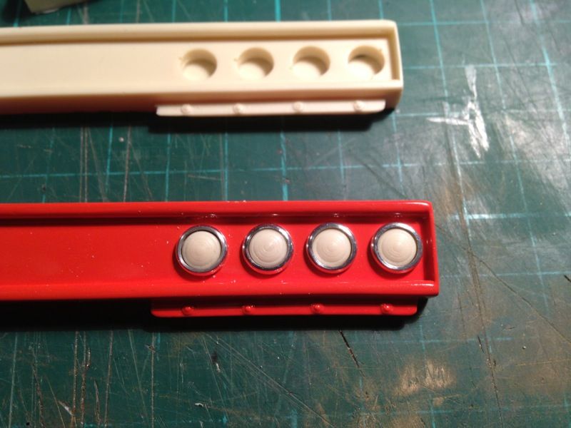

Small update for this

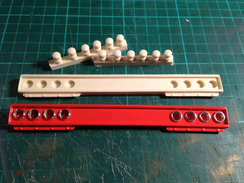

Light bar has had a bit of paint splashed on it, and the aluminium bezels fitted, now onto the lights, masters have been made and mounted ready to cast them
Posted Image
Posted Image
Finally happy with the polished guards, have made a master for the brackets and will cast these in white metal, so they can be polished also, I may get a chance to have these finished in a few days so I can start putting them together
