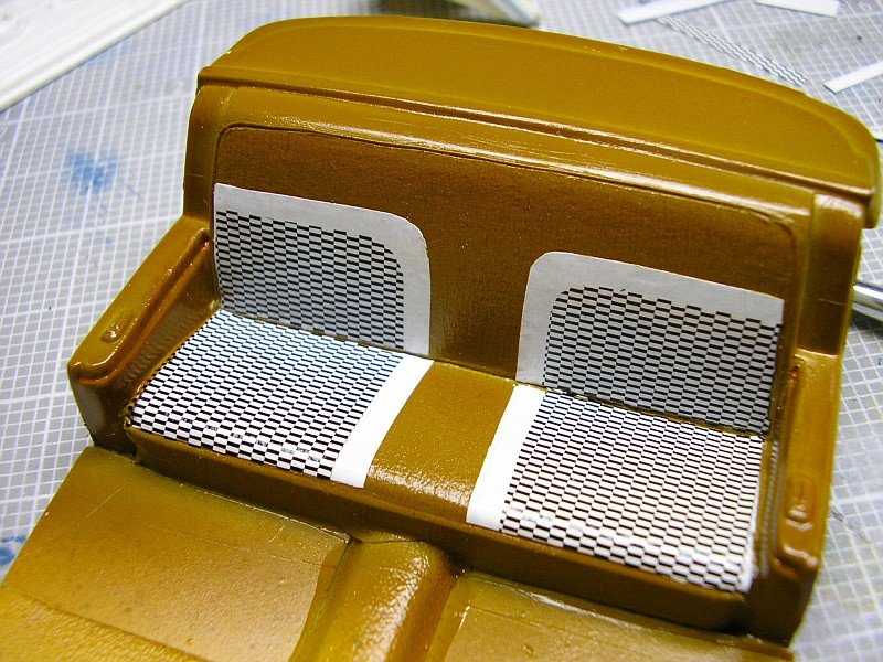

Here's the latest on the interior so far...............
I started with a base of Tamiya Dark Yellow for the seats since I'm trying to replicate the copperish color of the 1:1. This was done after I had covered the seats in masking tape to replicate a vinyl pattern.
Posted Image
When the paint dried I then airbrush Tamiya Clear Orange over the Dark Yellow. The color is actually a bit lighter than shown due to the photo being taken under a flourescent light.
Posted Image
I need a white background for the upholstery decal which will follow. I painted some decal paper with Tamiya White Primer, let dry, and then covered the areas I needed with Microscale Liquid Decal Film. This toughens up the decal paper since it was painted, so as not to make for frustration later! :D
Posted Image
Posted Image
Here is Scale Motorsport Upholstery Decal used here. I'm trying to replicate the '59 pattern as close as possible...........the 1:1 has some color in the little checkerboards.........so this is as good as it's gonna get! :) Please forgive the slightly jagged edges............I had to do all of this freehanded! :wink:
Posted Image
Posted Image

Now the front seat is epoxied in and everything looks kosher so far. I even put some mags in the front seat for "character". Pay no attention to the naughty mag on the end! :P
http://images14.fotk...P7220636-vi.jpg

Seat pattern looks super,gonna look great when that completed dash goes in
