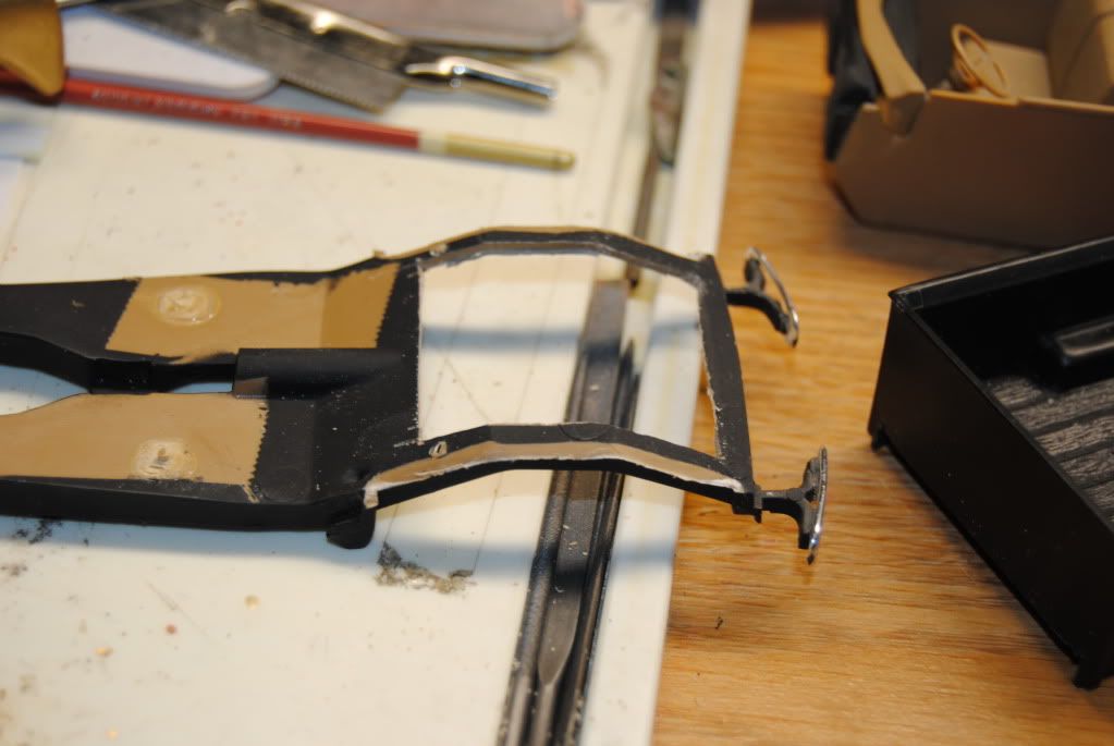

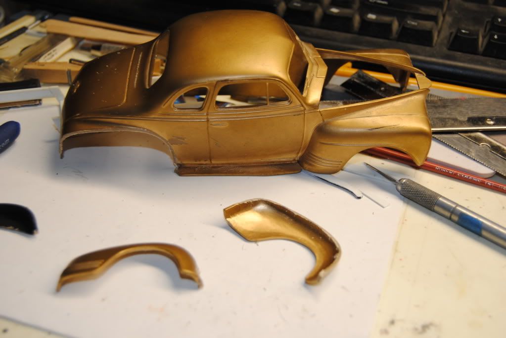

Been trying to figure out what to do with this 41 Plymouth. It's always been one of those love hate relationships. I loved it one day, then hated it the next. Decided to do a search here and see if I could find some inspiration and found some. Thor did a pickup conversion last year that I loved! So I decided to hack my Plymouth apart.
I started by removing the rear fenders.
Posted Image
Then hacked off the trunk.
Posted Image
Needed to then modify the chassis to allow the bed to fit.
Posted Image

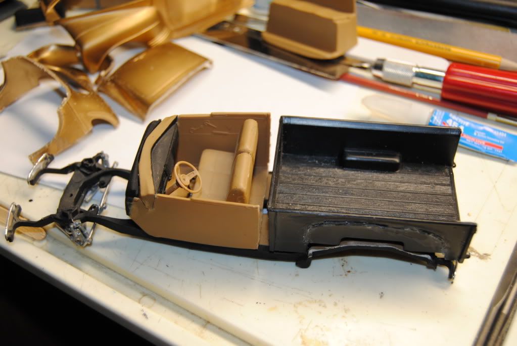

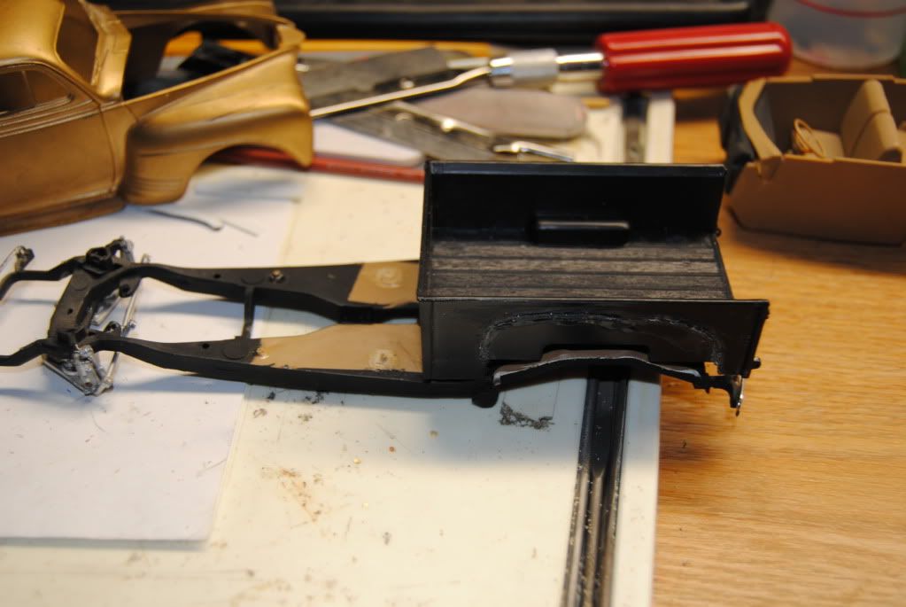

Got the bed fitted.
Posted Image

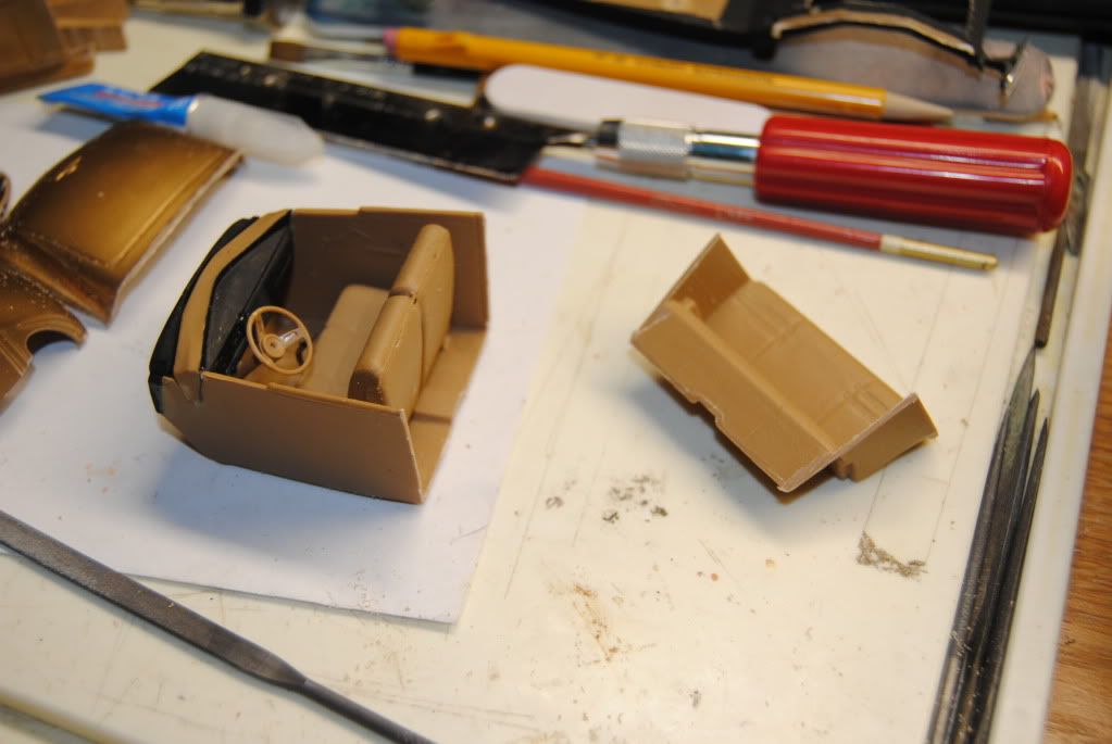

Then I cut the interior tub to fit.
Posted Image
Posted Image
More to follow.

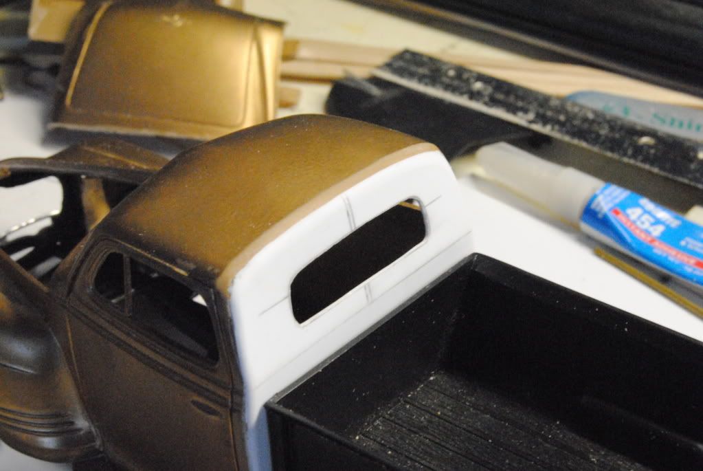

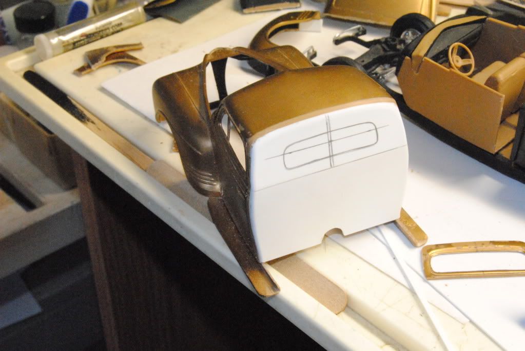

After a bunch of trimming of the rear of the new cab, I got some styrene on the back. Rounded off the edges, marked center lines for the window.
Posted Image
Rear window cut out.
Posted Image
Posted Image

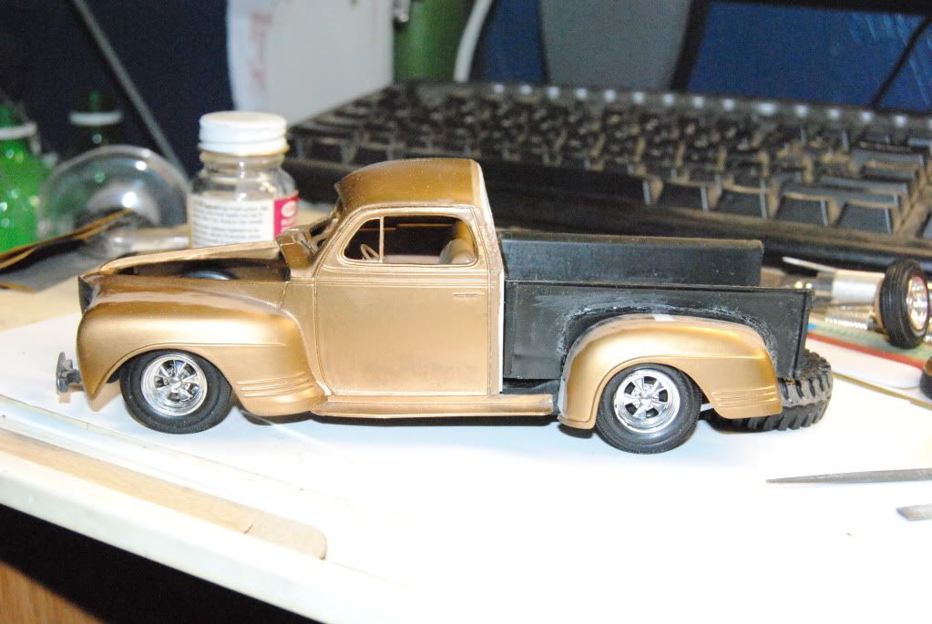

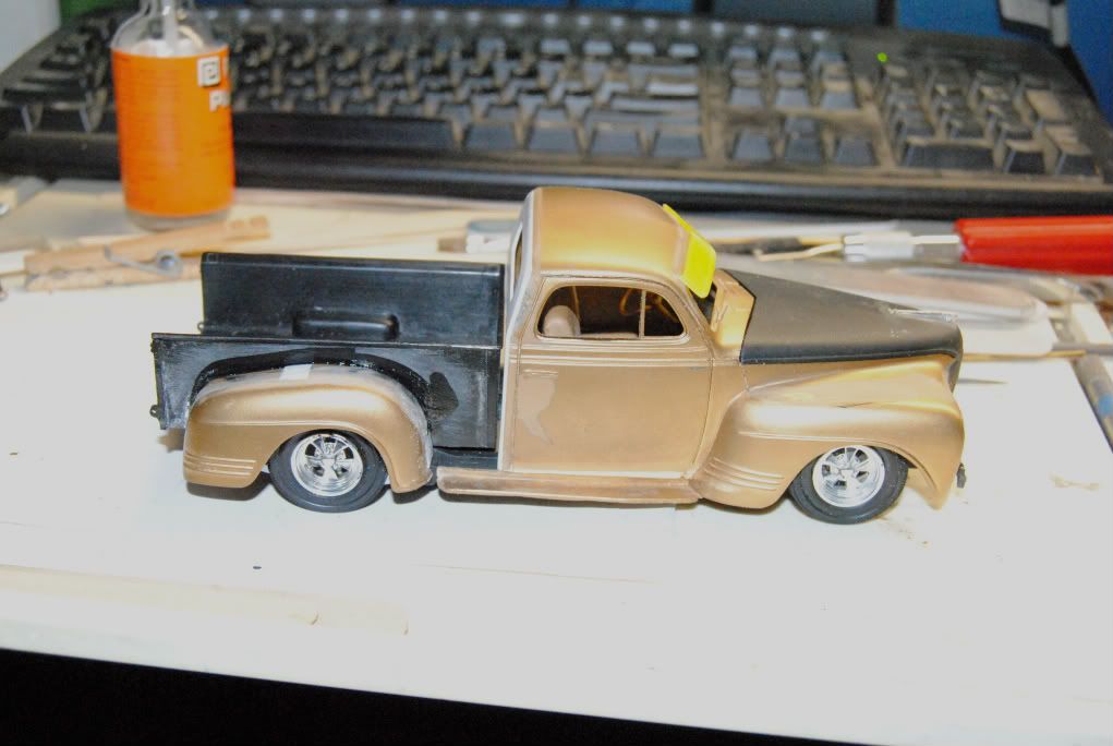

The inner rear fenders that were mounted on the chassis were cut in half and glued to the backs of the rear fenders to widen them and styrene strips added to fill in. Need to clean up the edges of the old fenders on the bed and get the new ones mounted.
The ride height was adjusted front and back. The front was moved up on the spindle towards the top. Rear had 6" drop blocks installed between the axle and springs.
Tim

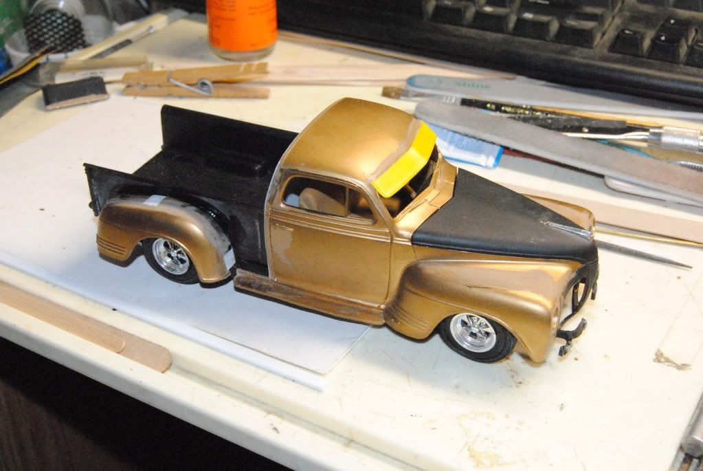

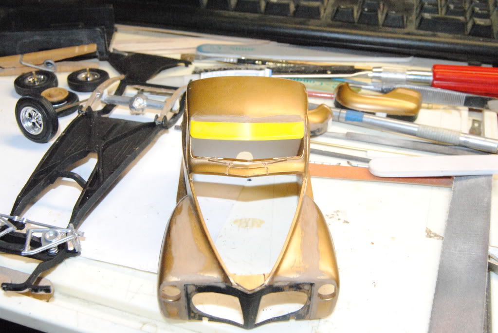

Sun visor added. I think this was a front air dam from an MPC Chevy Monza. I trimmed the sides off, rounded the corners and this is what I ended up with.
Posted Image
Posted Image
Tim

Rear fenders mounted.
Posted Image
Posted Image
Tim
