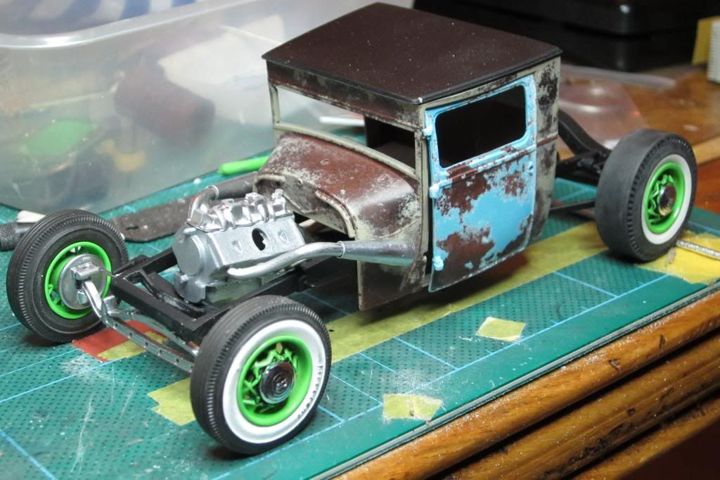

I thought I was going to build this straight out of the box. When I got all the parts out on my bench, I decided to try a few new things.
I've just done my first chop, so it seemed only natural that I should take the saw to this build and go a bit further.
First up was tweaking the chassis:
Posted Image
Then the roof got it's cut-line:
Posted Image
Wheels and caps are from the AMT 32 Phaeton kit, with M&H piecrust whitewall slicks from the AMT tyre set and Firestone fronts with hand painted whitewalls.
When I was prepping the tyres, I discovered that a soft brass brush in a motor tool takes out the shine from the recess in the tread pattern. It also scuffs the sidewalls nicely. Makes them look used.
Posted Image
Some brass photoetch for the grille:
Posted Image
The chrome surround will lose a bit of shine by the time I'm done.
After some test fitting, I've now shortened the rear end a bit and moved the front axle forward, in front of the radiator:
Posted Image
I've had a go at the salt technique for the paint weathering. I don't know why I didn't try it before. It works well.
I'll shoehorn a V-8 in to the space usually occupied by the 4-banger. I've got a Mercury flathead with some nicely engraved Offenhauser bits.
More pics soon. I'll take a few quick shots of the body once I've chipped all the salt off.

In reply to your question Brendan, I bought a small adjustable square and set the angle by eye. This is a valuable tool to have when messing with the frame. It's easy to then copy the angles on all 4 cuts. I assembled the sections on a true surface with CA and some kicker.
If I was going to build a more trad rod, I'd box the frame to hide the joins, but as this is intended to be rough and ready, I'm happy with the way it looks...!

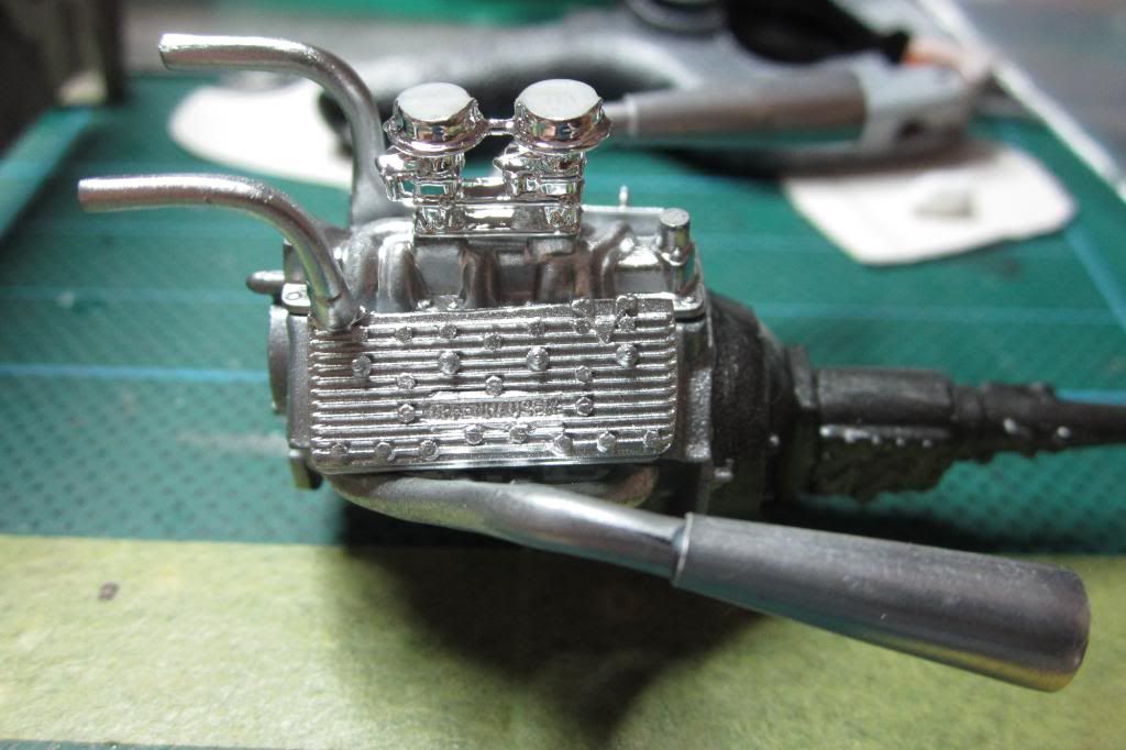

I couldn't figure out how to make the headers fit, until I saw a 1:1 car with a set-up like this:
Posted Image
I've got to make new water pipes, as the radiator is going to be much lower.
Hoping to get more done this weekend.

Very cool. Did you just eyeball the extra length on the frame as well, or did you measure out ahead of time how much length you would be adding? The last Z I did, I ended up adding length to the front seperate from the Z.
Thanks for the encouragement.
I did everything by eye. The markings are so feint on my steel rule, i gave up measuring and just went for it!
The adjustment of the rear length was to compensate for the pieces I added. After I had glued it together, I realized I could've made things easier by cutting length from the frame before I added the Z pieces. I ended up cutting the rear crossmember off and shortened the rails that way. My previous joins were too strong to prise apart by then.
