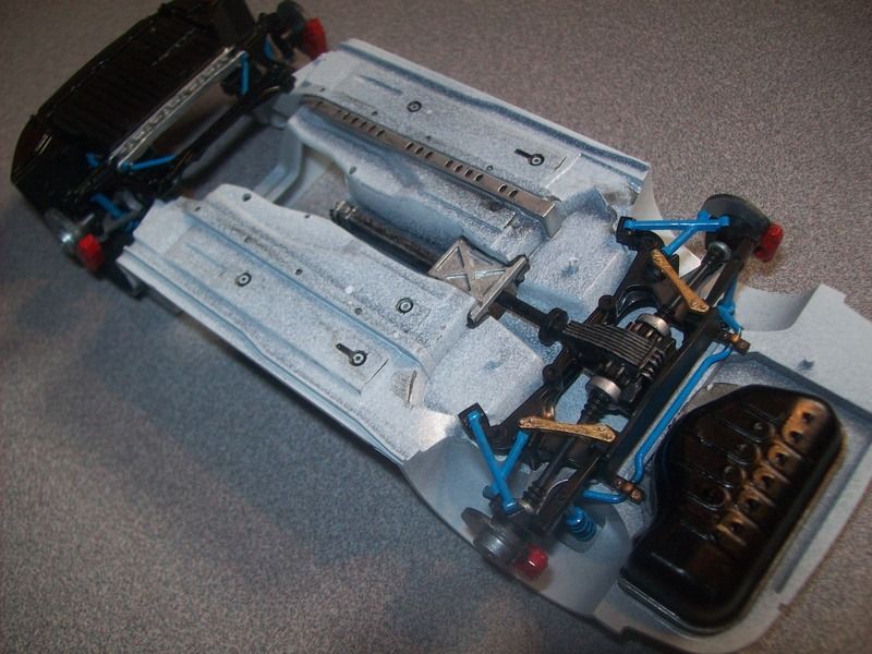

I wasn't liking the rectangular upper half of the gas tank, and the molded in straps and brackets weren't pretty either, so the area between the framerails was removed from the '69 chassis, and replaced with the same section from the '68 Dart kit, only modified. I cut off the gas tank, cleaned up the spare tire well section, filled in the new floorpan hole where the molded-in gas tank was located, and added the missing third of the well using the '69's well. Here you can see the '69 section which was added to complete the well, and the filler piece above it:
I added a .030" filler strip on both sides of the floor section, then test fit it in the chassis until I was satisfied. I also squared up the framerails a bit, filled in two sink marks, then started removing the rear torque boxes. The front leaf spring bracket "pads" have yet to be removed in this pic:
The hood got another coat of filler primer and is now ready for me to add the bracing to the underside, but the notch/gap on the fender, near the right rear corner of the hood, still needs attention:

Posted 10 May 2013 - 06:38 PM
I re-shaped the edges of the floorpan insert piece (I went after two sinks marks on the inside edges of the framerails, and ended up sanding away some thickness), re-did the spare tire well ribs, and started cleaning up the area around the front leaf spring brackets. The torque boxes were removed, which meant some shaving/thinning of the first scale foot of the framerails, patching in where the torque boxes were located, and I will need to add the cross braces to which the leaf spring brackets attach:
I have yet to glue in the insert, as the ribs and drain plugs need some more detailing and I need to finish the gas tank and the section of the filler neck which will be visible, the add some tank straps.
