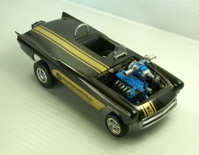

Mike- you could actually get special manifolds for putting a Roots-style supercharger on a six, but how cool would a front-mounted piece be? ;) I used a Paxton centrifugal blower on a Stovebolt I used in an Olds roadster I built years ago.
I might start on an off-the shelf project, as I haven't been able to get the Flathead six for the coupe yet. Need something to keep me going in the interim.

Chuck, you got a picture of that set-up? I want to do something different with the engine, I just don't know which way to go yet, so point me in a direction!

I think I still have the model- I'll see about snapping a photo.

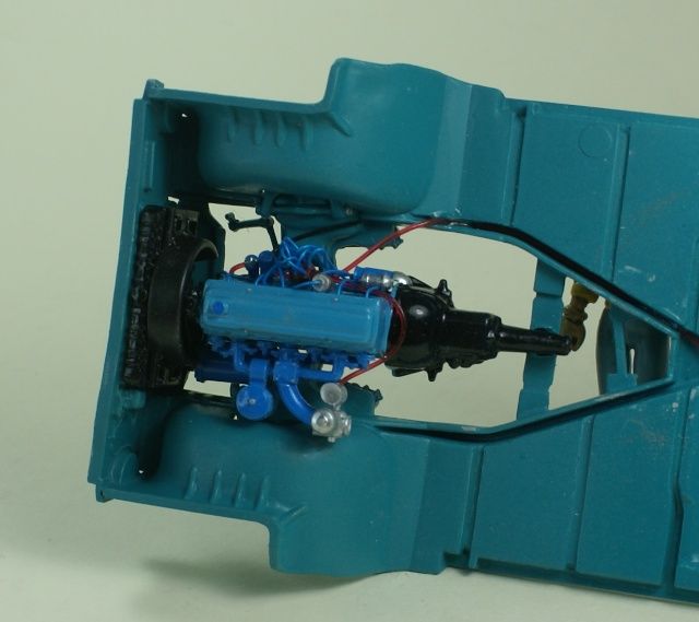

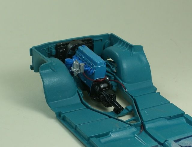

Finally, a test fit of the Slant Six in the engine bay. I will need to blister the firewall for bellhousing/starter clearance...forgot about that 'til now:

I fine tuned the firewall blister and did another test fit with the engine and trans, so I will make any final adjustments once the engine is positively located:
Posted Image
Posted Image

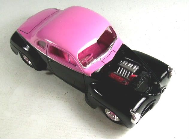

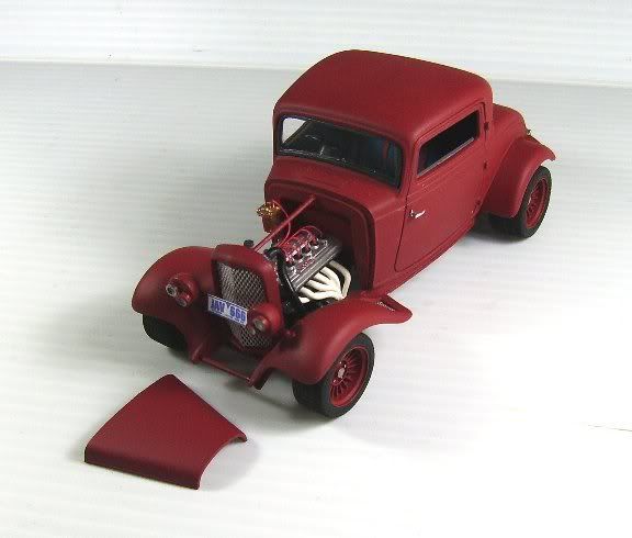

Here it is... remember, I built this about seven years ago, my standards are a lot higher now! :D
Posted Image
Posted Image
Posted Image
