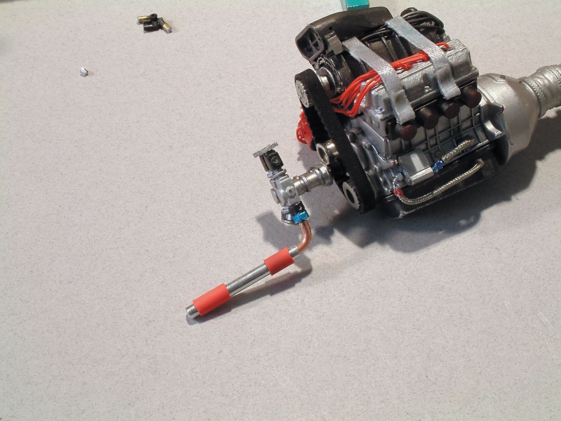

Posted 30 September 2012 - 09:49 AM
Attached File  funnel_braided_line.jpg   92.54KB   5 downloads
I have struggled with braided line and fittings and think I have found a good way to thread the line into the fitting. I have not researched this much, so probably some of you have good methods of doing the same and have already shared this. I took a scrap piece of styrene sheet, drilled a hole through it that matches the bore of the fitting and then used a larger bit to create a counter bore or funnel shape. Then I lined up the holes of the sheet and the fitting and glued the fitting in place with white glue, let it dry and then was able to thread the line through the fitting. Now I can pull the fitting off the sheet, clean off the glue and continue working. Please share better ideas with me as I have not used braided line a lot. Thanks for looking.
#69 vintagedragfan
vintagedragfan
  • 2,641 posts
  • Location:Richmond Mo,
  • Full Name:Bill Davis
Posted 30 September 2012 - 09:59 AM
thats a reat idea Dave, I usually cut it at an angle and start the point first then it goes right through (most of the time) you can also do this with wire also, works pretty well for me
