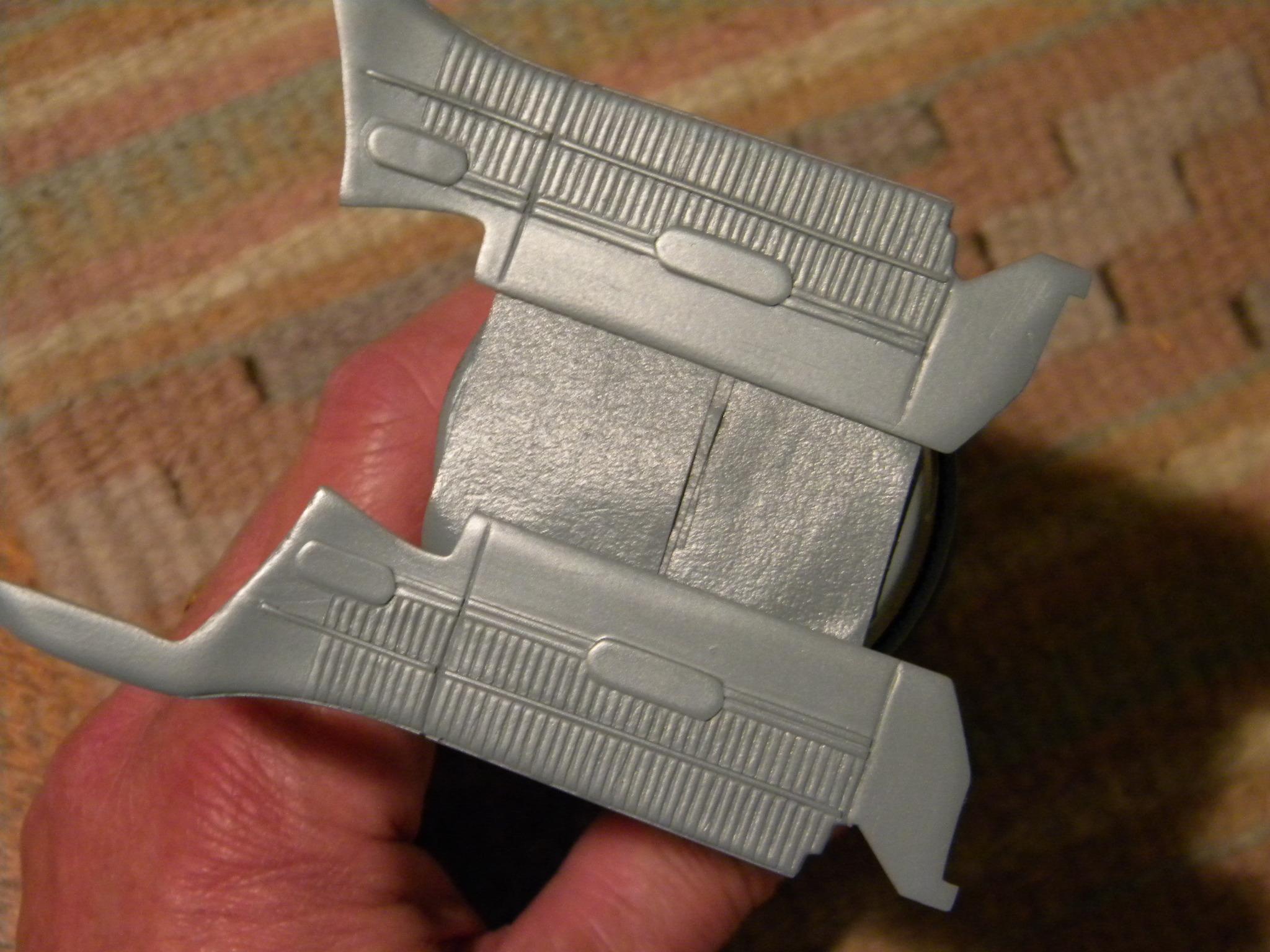

Here's something which costs nothing, but I think the small shadow line lends a bit more realism, and helps separate the seat base from the floor, making it easier to paint/texture both. A real seat base like this in't molded as one with the floor, and is never the same sheen (and sometimes a different color) as the carpet/vinyl on the floor, so why shouldn't your models be the same?
All you need to do is use your favorite scribing tool to make a small groove where the seat base and carpet meet, like so:
Posted Image
Posted Image
I have yet to scribe over the transmission tunnel in the above pic.
You can use this same technique to add definition and fool the eyes into thinking parts which are molded as one are actually separate parts, Things like consoles, seats in promo-style interiors, washer reservoirs and batteries in Monogram kit engine compartments, etc. Simply adding a little shadow line, or going even further and slightly undercutting the molded in 'part' will make a difference visually, yet costs nothing, other than a few minutes of your time.

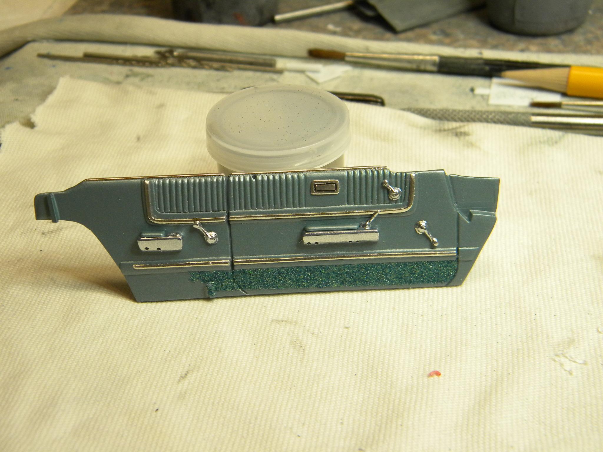

Posted 12 July 2012 - 09:04 AM
If you're really into the details, round over the seat's bottom edge so you don't leave a sharp edge...and add seatbelt clips if you're really into details...and building a '67 Dart sedan. :D

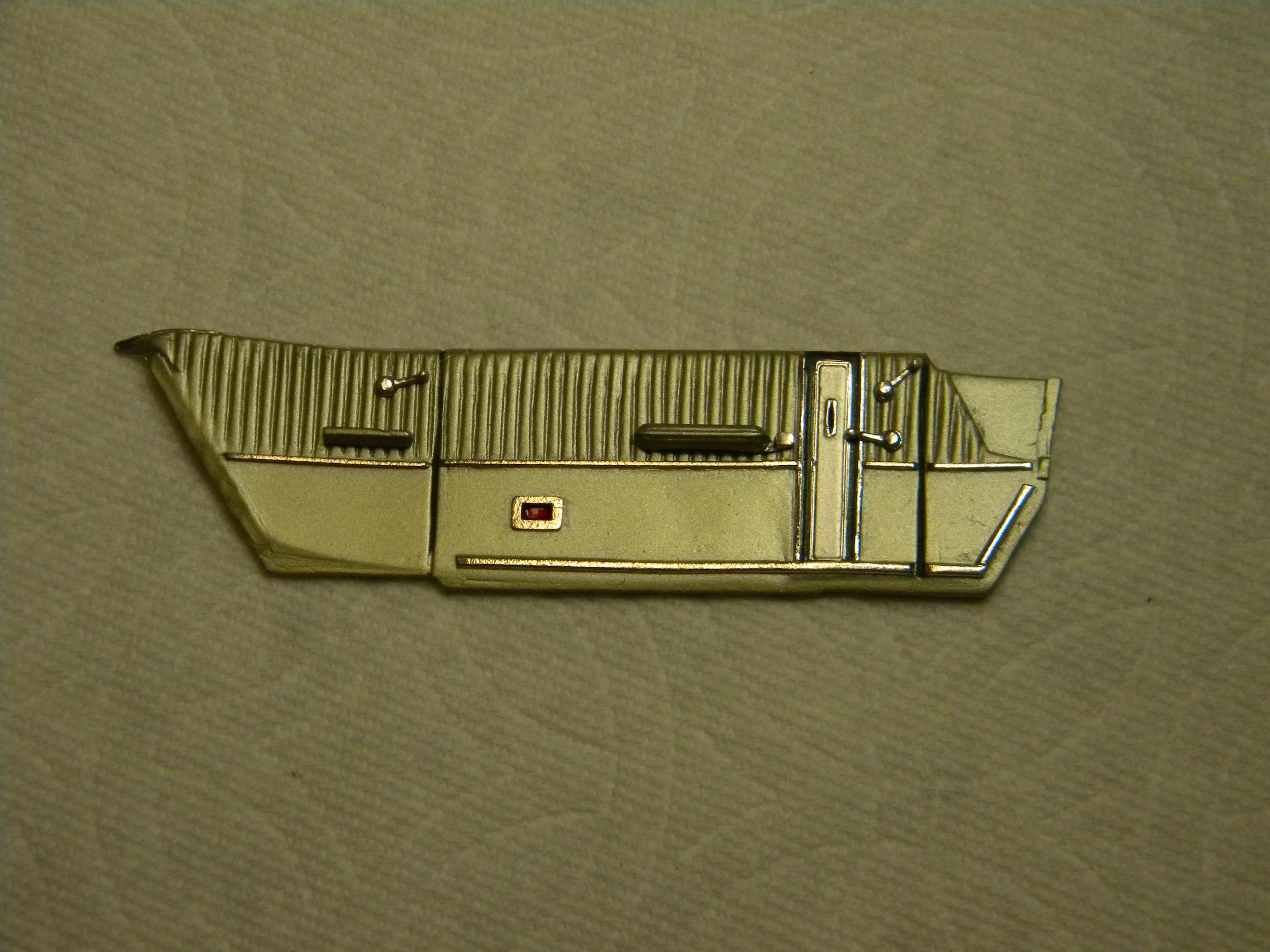

Posted 21 July 2012 - 03:56 AM
Casey you mentioned some great modeling points. "Fooling the eye" doesnt cost anything, just a little time, and adds alot. Look closely at the top of the seat back , I added wrinkles to it to make it fool the eye and look more like real upolstery.
