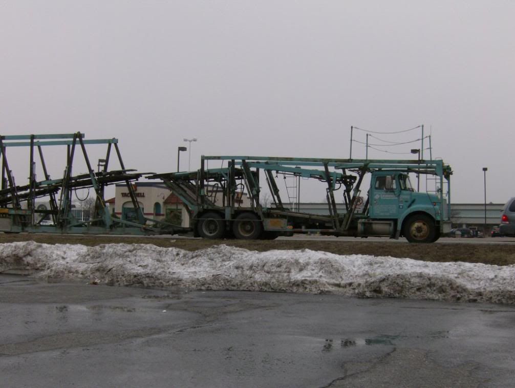

I did one of these in 3/16" scale a number of years ago. It was a lot of fun and am looking at doing it in 1/25th scale this go around. It looks like from the mid 60's to early 70's. If any one can get more specific on the year it would be a great help. I have not looked for a resin of plastic of the cab yet but if I cant find one i will do it from scratch. Obviously the trailer will be scratch built. I have about 200 detail photos of this rig from every inch of it. The trail is a Whitehead and Kales from Detroit, not sure of the year for it. The cab was retro fitted for this specific trailer either when new or some point at least 40 years ago.
Posted Image
Posted Image
Posted Image
If anyone has some information on this type of unit or know of some
kits or resins that would work for the cab, it would be appreciated.
A drawing or dimensions would be great help also.

Do some searching on net and I think that cab is available. I don't remember a kit being offered of that vintage semi but the cab is built off of the 67-72 GM body style. There were car hauler trailers available in kit form, do a search of eBay or some of the kit sellers (Modelroundup, Dean's Hobby Stop, Fred Sterns) as they might have that car hauler kit.
I am not familiar with drive trains and frames but those wheels look like what is in some of the recently released truck kits and probably easier to use.
Best of luck with your build. The real challenge will be building the kits to simulate the load on that trailer!

Dave Natale at AITM has the GMC cab kit. As for the frame and drive train you can use either the AMT Chevy titan 90 or the Astro 95.

This is a mid to late sixties GMC 9500 series,the short hood version,usually powered by a 238 Detroit diesel,and equipped with a tag axle,the 9500 series also came in a long hood version,a good many of those were V-12 Deroit powered.The same cab was also used on the later "Brigadier" and "Bruin" series trucks by GMC and Chevrolet respectively. Many car-carriers used this exact set-up as it was pretty much bulletproof for its intended purpose.............Mark
