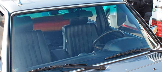

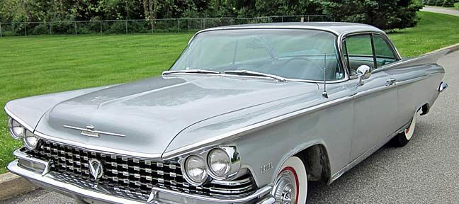

Another cool detail to add (if you have an airbrush) is that blue-green band of tint along the upper windshield. A very "50s-60s" look.
Posted Image
Posted Image
Posted Image
#17 jerseyjunker1
jerseyjunker1
  • 541 posts
  • Location:hopatcong nj
  • Full Name:Manny Solano
Posted 23 July 2012 - 09:31 AM
harry is right on the window tint. you can also use some stained glass clear color paint to get that look.craft store item. :)
