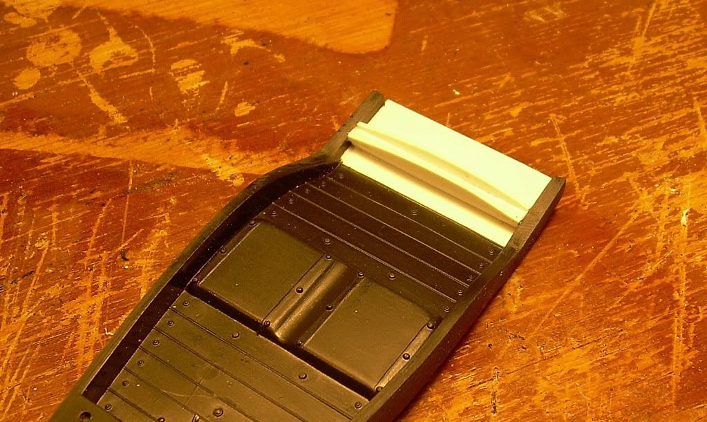

The roadster kit was the first of the Revell Deuce series. It's fairly clear that at the time it was released it was pretty much a stand alone offering, a pretty good rendition of a late billet era style car. Fashion has now eclipsed it as gradually it has been found to have its faults, mainly because more Traditional styles are now very much in vogue. As a result the wide front tires, the wheels and the four link suspension setups are things that modelers have to correct when they try to back date this kit. And frustratingly subsequent releases have pretty much failed to address any of these issues.
The front wheels and tires, regardless of style (Torq Thrusts on all subsequent releases starting with the 3-window, plus pseudo Kelsey Hayes wires on the Tudor and steelies on the 5-window) are still too wide, the kits all come with the same small-block Ford setup with a second engine in the Tudor and 5-window kits (flathead and "hemi" respectively). If you want to do a buggy spring rear end you will have to install the appropriate crossmember and spring. At the front the backdate to proper 50's style would require a more traditional I-beam unit. The most commonly used source for both these conversions is one of the Revell '29 Ford RPU "rat rod" kits or the Revell '30 Ford sedan kit. As mentioned above, you'll also have to delete the disc brakes and substitute the appropriate "juice" (hydraulic) brake setup. There are other details that need attention, too, like the fact that the dashboard has a cassette player (!) and air conditioning outlets (!!) and that the kit doesn't come with a gas pedal and the motor has an automatic transmission.
Here’s work in progress pic of the Revell Deuce chassis with the buggy spring conversion mentioned above:
Posted Image
Another approach is to not fight the base kit too hard and go for a more contemporary look, but I still think the front wheels and tires are a disaster. I also think the kit benefits from lowering the front suspension to give it more rake, which is easily done by shaving the front spring. Here's a picture of a more contemporary roadster based on this kit, done in the style of the late Barry Lobeck with the front end corrected but otherwise largely from the kit:
Posted Image
Posted Image
If you build a full fendered car many of these details are invisible and the car can be easily backdated through careful attention to wheel and tire selection and proper stance. The kit doesn’t come with fenders but they can be found in all the other variants and fit with no modifications. Here is a simple build where I kept most of the standard kit but paid attention to stance and wheel and tire choice.

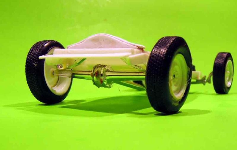

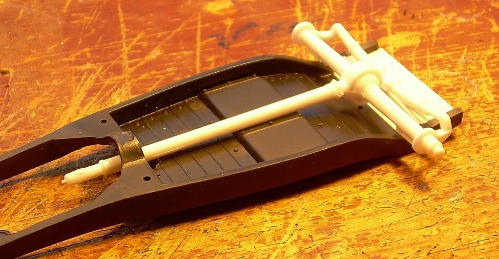

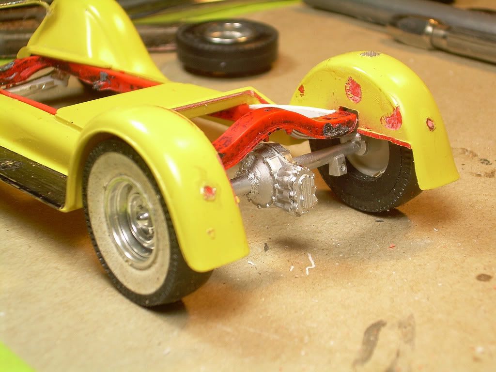

Although this is one of the venerable AMT '32 frames, the modifications to the Revell unit will be similar, and if you have the '31 Tudor kit to pirate parts from, you're halfway home. As these are scale models of real cars, the procedures are identical to what's encountered when you set out to build a full size '32 based hot rod. ( Just as an aside, I currently build 1:1 period rods at a nationally known shop for a living, so I'm telling you the real deal.)
In this shot, the rear crossmember and floor area have been replaced with scratchbuilt pieces to allow this car to utilize a '37 Ford rear end. This is more-or-less what you'll have to do on your Revell '32 to get somewhere to hang the rear buggy spring.
Posted Image
This is the Revell '37 truck axle in place. Wishbones from the '32 will be added shortly. The '37 wishbones couldn't be used because they're too long, too wide and interfere with the frame rails. This sort of mix-and-match is, again, exactly what you encounter building a real one. It's important to remember that although the model-T all the way through the '48 Fords had similarly designed rear suspension, there were differences in the placement and width of the wishbones, the spring hangers and the spring design and height. As you do your mods, you will have to make note of what these differences are and how they will effect your wheelbase and ride height. NO two hot rods will ever be exactly the same, especially period cars that were built from junkyard sourced items rather than catalogs.
Posted Image
This shot shows the raised center of the model-A ('28-'31) rear crossmember and spring. This is necessary to install a quick-change rear end in a '32. Though this is again an old AMT '29 kit, you already have this crossmember and spring in your '31 Tudor kit, and the swap into the '32 is straightforward. It requires considerable careful measurement and fitting however, being aware of the things I mentioned above...wheelbase, ride height and wishbone location.
Posted Image
Also included in your '31 Tudor kit is a Model-A rear axle. This is very similar in appearance to the '32 and later, though they are entirely different in reality. Same look but different parts. This is an acceptable unit to use for a period-look car. You may have to adjust the length of the driveshaft to fit your engine / transmission of choice. Remember too that the earlier cars (4-cyl and flathead powered) had "closed" driveshafts with only ONE universal joint in the front. All forward driving force was taken out through this driveshaft and then through the trans, engine and motor-mounts. The trans that comes behind your flathead will probably be correct for this look, to hook up as in reality with the '31 driveshaft/axle unit.
The correct brake backing plates can be sourced from a number of kits. The Revell '40 and '48 Fords have them, as well as the Monogram 1/24 '32 roadster street rod with the small-block Chevy. There are nice ones in the Monogram 1/24 woody, with spindle details that can be used to work in conjunction with the working steering of your '31 Tudor axle as shown here.
Posted Image
Glad to see you taking such an interest in doing a little more to get a correct car. Though it certainly is more work, I think you get a real feel for what the early hot-rodders did by taking the time and making the effort to get the details dialed in.
