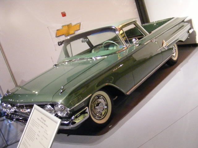

First, let me point out what bugged me so about the roof.........here is a shot of the '60.....
The windshield header curves in the right places just as I've seen from memory, and according to the bunches of photos I have of the 1:1.
Here's a pic of the '59 and it's windshield header............
As you can see, not quite the same as the '60------GM used the exact same rooflines for both model years, and somehow Revell missed the mark on getting this right on the '59, but corrected it for the '60. Now, I'm not here to step on anyone's toes that's built this kit. The examples I've seen are beautiful, especially the recent black on red one that featured a fuel injected motor. Something quite rare for a '59, and it will be the engine I'll eventually use in my version. I have to say that particular thread inspired me to start work on this one! '59 Chevys were all over the roads when I was a kid in the '60's.............you could hardly go a few blocks without seeing at least one version of a '59 (or '60) sometime along the way. So this car has some bit of nostalgic effect for me as well.

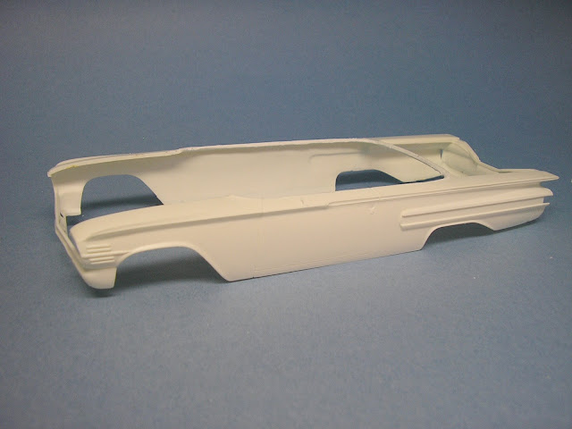

OK.........here's a pic with the roof totally hacked away..................
And just for grins...............here's a pic of the '60 after it lost it head! http://www.modelcars...O_DIR#/wink.png
Hmmmm........now what to do with this '60 body. Let's see------I've got Tom Coolidges very nice 2 door sedan roof section to do a Bel AIr.....I also have The Modelhaus' four door flattop roof section to do a four door hardtop Impala...........We'll have to see won't we! http://www.modelcars...DIR#/tongue.png

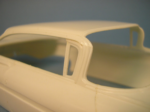

After the '60's roof was cut away, I sorta dry fitted it onto the '59 to see how well it would fit with a lot of drama..................here's what she looks like........
Not bad at all if I must say so myself! Looks to me more to my view like the 1:1 as far as the roof profile, and with some cleanup and trimming, it'll be good to go.
Of course I'll need to add that little roof vent which was exclusive to the '59, among other things, but so far the hard part is done.

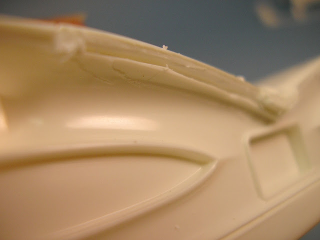

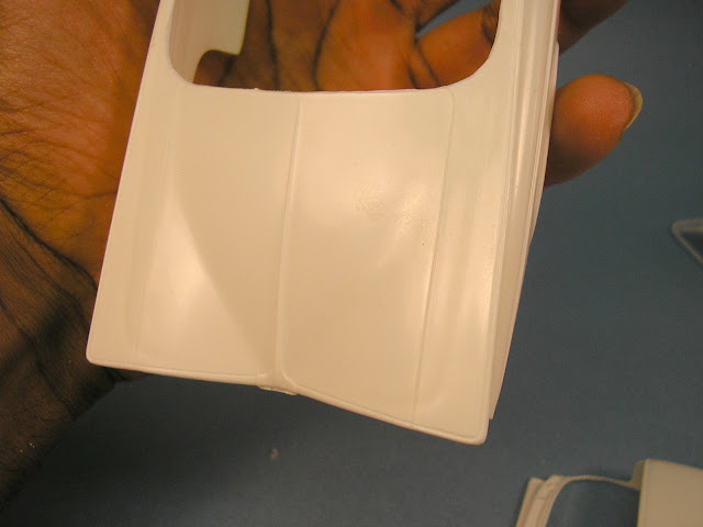

I've decided to do opening panels on this one, so one of the first things I want to cut out is the trunk. Now since doing this I've learned that this was easier said than done. My standard mode of operation is to use the BACK EDGE of an Exacto blade to cut body panels out.................
I want to cut out the trunk for another reason..............there are some NASTY sink marks/valleys that run the entire length of the fins on the rear deck! It'll be easier for me to cut the trunk away, and not attach the roof at this time to tackle these bad areas.
Posted Image
Posted Image
The trick will be to get rid of those valleys, and try to preserve the chrome trim on the sides. If worse comes to worst.......I can always replicate the trim along the fins with some styrene strip, but first I'd like to keep as much as I can.

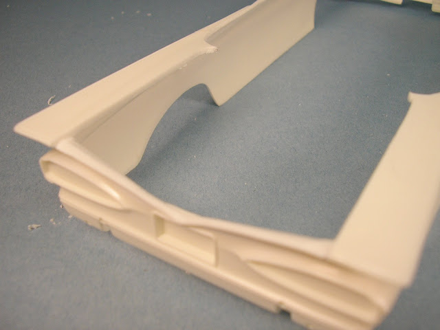

Well, now the fun begins.............as I mentioned above, the back edge of the exacto is what I used to start cutting out the trunk.
Posted Image
One needs plenty of patience when doing this. If you want to speed things up, you can always take a dremel tool on the inside of the body and grind away at the plastic around the perimeter of the opening.
One trouble spot I ran into was getting to the back end. Due to the complex shape of the rear, and the thickness of the plastic, I came close to swearing to get the exacto blade to make progress in getting the cuts made. I didn't want to use the Dremel too much as I didn't want to risk grinding through to the outside of the bodywork.
This is a pic of looking at the body on the inside rear............
Posted Image
Finally I started making progress as the knife was making its way through the outside of the body. I also was cutting on the outside following the chrome trim until the cuts "met".
Posted Image
OK..........after about an hour of near cursing, the trunk was finally free!
Posted Image

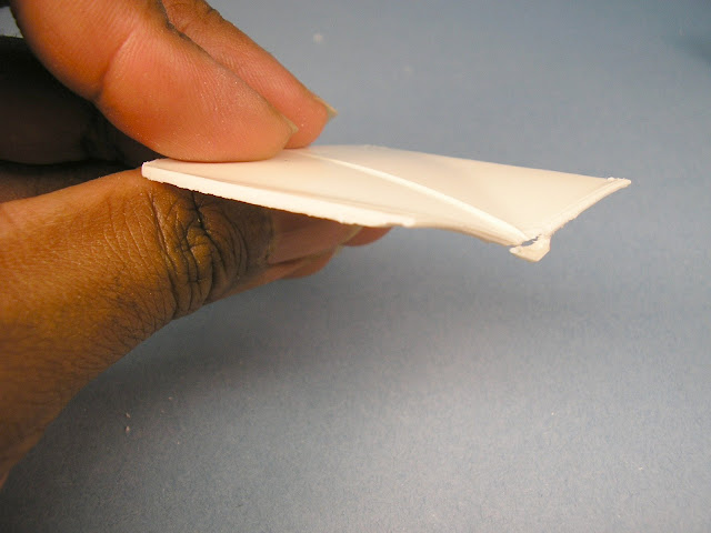

Here's the trunk..........
Posted Image
The emblem will go by the wayside.........I do have a PE piece that will replace that.
One thing I want to point out here. and this is just an observation. Whenever you cut out panels it's a VERY GOOD IDEA to thin out your panels! You're trying to get the panels to open and appear as close to the 1:1 as possible. Taking the time to thin out the panels will go a long way.
