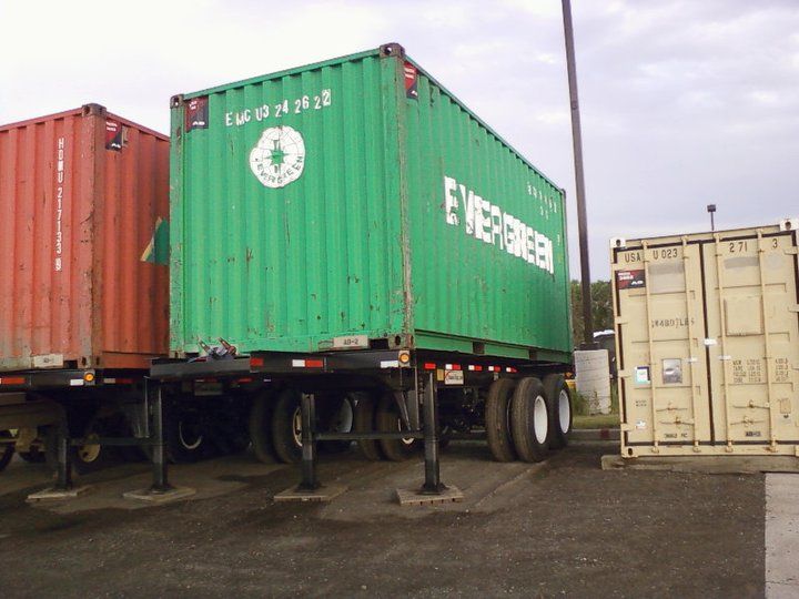

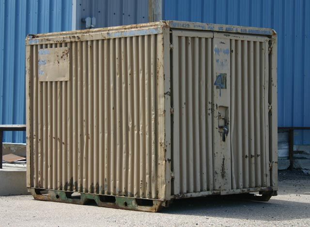

ARTEMIS1759 Posted August 15, 2012 Share Posted August 15, 2012 (edited) Military wise let me see wht I got for pics. Slight heat to put dimples in the flats and some in the ribs will do for military dents. Here you go: Edited August 15, 2012 by ARTEMIS1759 Quote Link to comment Share on other sites More sharing options...

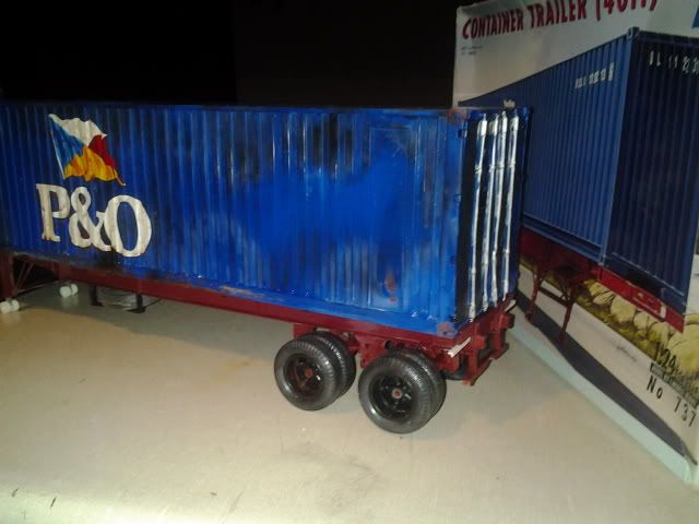

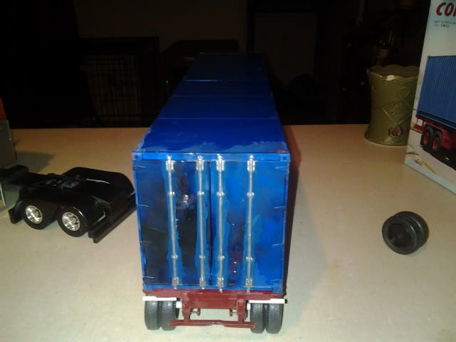

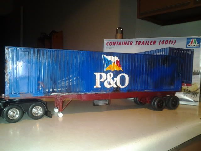

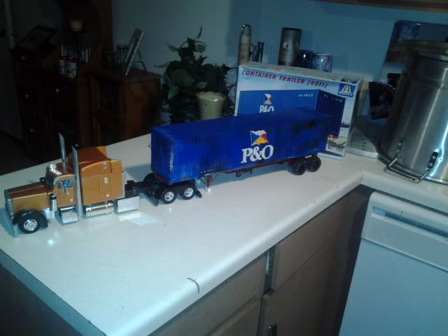

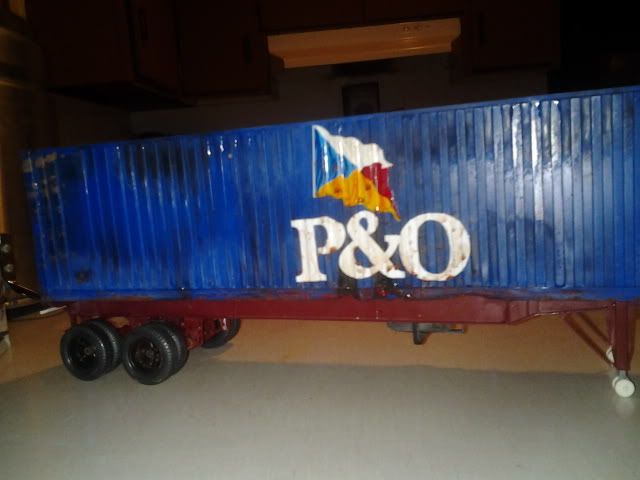

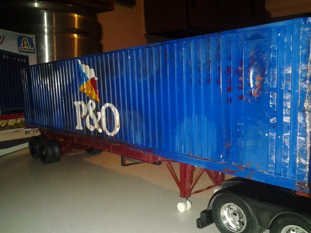

Chad Posted August 16, 2012 Author Share Posted August 16, 2012 well I used the decal set solution and was able to get them to set really nicely. after I let them dry nicely I put some rustall on the decals to kind of beat them up a bit....today after work I'm going to chip them up a bit and make them look messed up. here are some pictures of the current progress... still deciding on a color for the frame, I know I DON'T want it to match at all. I also decided to black mark the trailer using just the yellow portion of the flame from the lighter and kind of "burnt it" and melted the rear frame of the trailer like someone backed into a pole or something similar....it's a pretty beat up trailer to be honest. but it looks cool. I also dry brushed over all the areas that were "sideswiped" against something and also "bent in" the lower rub rails to make them look like they'd been bashed into a guard rail or a car. everything has been rusted as well. Chad Quote Link to comment Share on other sites More sharing options...
Chad Posted August 16, 2012 Author Share Posted August 16, 2012 I'm also thinking about "tagging it" with some graphiti just trying to figure out how to do it without it looking like freehand brushing. Chad Quote Link to comment Share on other sites More sharing options...
59 Impala Posted August 16, 2012 Share Posted August 16, 2012 Man, when I saw this pic it brought back many great memories for me. I worked at CONEX control on Okinawa when I was in the Army back in 67-70. Thanks for the memories ARTEMIS1759. By the way, your trailer looks great Chad. Dan Quote Link to comment Share on other sites More sharing options...

Ben Posted August 18, 2012 Share Posted August 18, 2012 Lookin great Chad!! Like you said, it really needs a good coat of flat clear to get rid of the shine. I would suggest some more light gray and tan (very thin) misted over it as well to make it a little more dirty. That Pete is pretty sweet too!! Quote Link to comment Share on other sites More sharing options...
Chuck Most Posted August 18, 2012 Share Posted August 18, 2012 A thin coat or two of Testors Dullcote should kill off any remaining shine. Looks great, Chad! Quote Link to comment Share on other sites More sharing options...

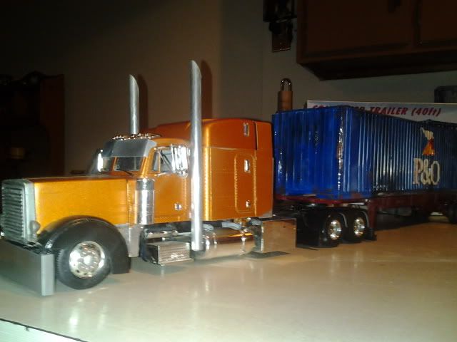

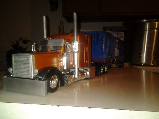

Chad Posted August 18, 2012 Author Share Posted August 18, 2012 Thank you guys. Im going tomorrow to get the testors dull coat and ive actually got some leather brown im going to use as mud....but what im going to do is actually mist dirt over it after i dull coat it. It worked great on a tank i did in Afghanistan. Thanks Ben on the pete. Its a griffendesigns 379 with normal italeris stretched to a 310; wb. Italeri wheels with lonestar tires on it and a few other goodies. Quote Link to comment Share on other sites More sharing options...
BigBad Posted August 18, 2012 Share Posted August 18, 2012 (edited) Lookin' good Chad! i like that weathering. I see you removed the fenders and changed the wheels. Did you have to do other stuff to americanise the trailer? Nice 379 too... Too bad this trailer kit isn't available anymore just like the Volvo 670-780 and the Freightliner FLD. Edited August 18, 2012 by BigBad Quote Link to comment Share on other sites More sharing options...
Chad Posted August 18, 2012 Author Share Posted August 18, 2012 I actually had to do a little more than just the tires remove the fenders... All in all i moved the kingoin forward, sectioned the suspension, mpved the landing gear forward and did a little work to the rear bumper. I was actually lucky enough to pick up 3 of these trailers at 20/kit... Chad Quote Link to comment Share on other sites More sharing options...
