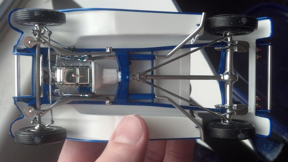

I've never had an interest in building an Ala Kart, but the modern tool kit is a fantastic parts source for kit-bashing. The front axle is very nice and can easilly have a conventional spring attached to the top of it for a more traditional dropped axle front end. (The spring from the stock axle in AMT's '29 Roadster kit is a great fit.) The wheels and tires are an excellent set of big & little hot rod tires. The wheels look even better stripped, painted and with hubcaps. (The hubcaps in the AMT '53 Ford Pickup fit really well!) The front and rear wheels also have nicely done brake plates.
The engine is a bust because of its scale issues but... In the later 70's AMT stripped down their '29 Roadster kit by eliminating the Ala Kart parts (the Ala Kart was actually changed into what they called a Mod-Rod by replacing the nose and hood with a '32 grill and eliminating the truck bed and putting a platform with gas tank on the last couple of issues.) AMT kept the Dodge engine as the alternate "street rod" engine option for the Roadster but replaced the Hilborn injector and front accessories with a race-only super charger setup. By race only this means there was no water pump or generator, just the super charger belt & pulleys. Now, while the engine in the modern Ala Kart may be undersized, it's water pump/front cover, fan belt/pulleys and generator ARE sized pretty well. By using these parts from the modern Ala Kart the Dodge in the '29 Roadster can be nicely converted into a street motor making it a perfect addition to any early hot rod model. The starter motor that is molded to the oilpan on the Dodge engine can also be cut away and the seperate starter motor from the modern Ala Kart engine put in place for better detail. Add a 2x6 carb setup and log manifold from an AMT '36 Ford kit and the over-the-frame headers from AMT's '32 Phantom Vicky and you have a great looking engine.

Boy, this one always opens a can of worms, and opinions abound. The actual truth (rarely very popular when there are so many opinions) is that there are serious scale issues (and the shape of the nose) with several parts of the latest release, which shares zero parts with the original version. There are proportion and stance issues with the original kit, and styromaniac's mention above of combining the two to make a more-correct model than either alone will produce is definitely worth considering.
I've actually measured a real 1:1 Dodge Red Ram engine and '39 Ford 3-speed gearbox (and you know, divided by 25?) as represented in the kits, and the first version is pretty close, the newer version is a joke.....it's so badly underscale. I have both versions on the shelf, multiple articles from 1958 onwards about the car, my own reference numbers and photos of a real Red Ram and gearbox and have spent (wasted?) considerable time contrasting / comparing the two. Pretty amazing that in this day of digitizing everything and the ability to have a computer do the scaling and design most of the tooling, that the dimensions could be so far off, but it is, period. The decals are not great in the newer one either, but aftermarket was available.
I've also been involved in several online arguments about the correct scaling of the newer-release engine, all of them apparently with folks who have never actually measured the engine and scaled it themselves. Measure it, divide by 25, and the numbers don't lie. The popular argument is that the Red Ram is the "small" hemi, and that therefor the tiny motor in the newer kit is correct. Uh huh. A real Red Ram is almost exactly the same width across the heads as the bigger early hemis, but a bit shorter in overall length.....which is why Barris used it....to fit in the engine bay lengthwise. The original issue engine WILL fit in the later issue car, by the way.
All that said, either kit builds up into a good looking model, and the Red Ram and 3-speed in the early kit are cool swaps in anything, though the Hilborn FI detail is a little light. The newer kit has some nice parts for bashing, most notably probably the best "dropped and filled" front axle available for building a period rod.
