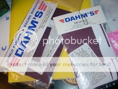

I believe both Testors and Tamiya also sell window tint sprays. I had bad results with the one I tried. The idea with the tinted plastic sheet is you don’t tint your windows, you replace them. Use the original as a pattern. No spray, no dust.
If Dahm’s Window Tint is still available, try it. This is an R/C product, very strong tint. Very strong adhesive too! Apply to the outside of your window. Down side is, not good for compound curves (for instance, a slight domed window)

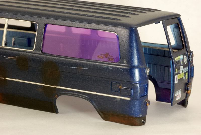

I have to agree with Dave. I needed some purple tinted windows for my daughter's van I'm building and found some report covers at Staples pretty close to th eright color. There were MANY colors to choose from. They were .005" thick. This is just a tape up to see how the color was ...
