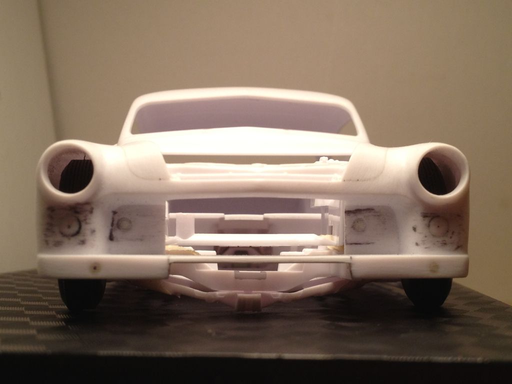

Did some work on the front suspension. I heated the lower control arms with some hot water and carefully bent them up. Had to remove some of the backing plate on the spindle to really get it up there.
Posted Image
Posted Image
I ended up having to remove more so I just removed the whole thing
Posted Image
Posted Image
But as you can see with the lower control arms being so high I'm getting a lot of camber. Doesn't show much with the wheel, that was just kinda sitting on there.
Posted Image
Edited by JasonFL, 28 August 2012 - 01:21 PM.

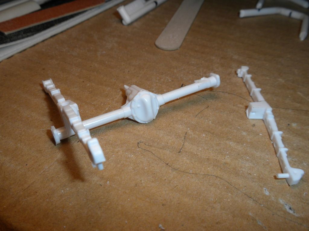

With all the camber I was having clearance issues with the fender so I made a relief cut on the backside of the spindles, and carefully pulled them forward then filled it.
Posted Image
I made some smaller backing plates out of the numbers off an old parts tree and then smoothed it all out.
Posted Image
Posted Image
Posted Image
Posted Image

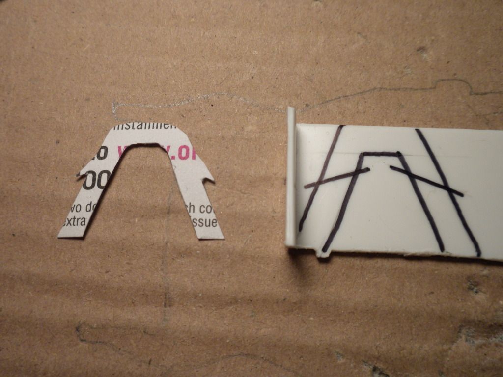

I worked on the rear notches and started getting them in place.
First I did a template. I was going to cut it out with built in gussets on top to help hold it to the frame. Plans changed a little and I gave it a clean look making the front rail of the notch a little thicker then the back to match how the frame goes from thick to thin.
Thanks to a good friend on here for donating some plastic sheets, I was able to scratch build the notches.
Posted Image
I had to cut out 2 notches and glue them together in order to get the right thickness
Posted Image
Posted Image
Posted Image

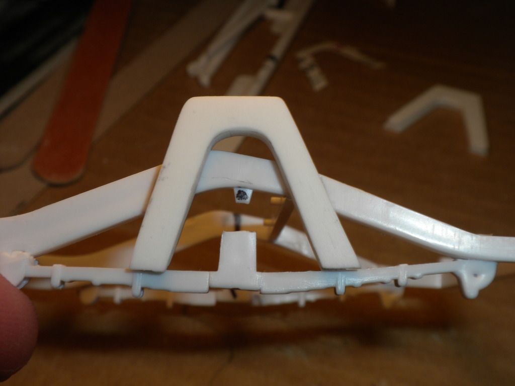

This is just about how high the notch will be when connected to the frame. The rear end will sit right where the frame is now.
Posted Image
Posted Image
I cut the leaf springs off the rear and glued them to the frame so when I cut the frame for the notch it keeps the back of the frame in place and aligned. This way it helps me keep where the center is for the rear end.
Posted Image
This is were I'm at now. I marked off the frame and cut it out. Now just have to glue it in place.
Posted Image
Posted Image

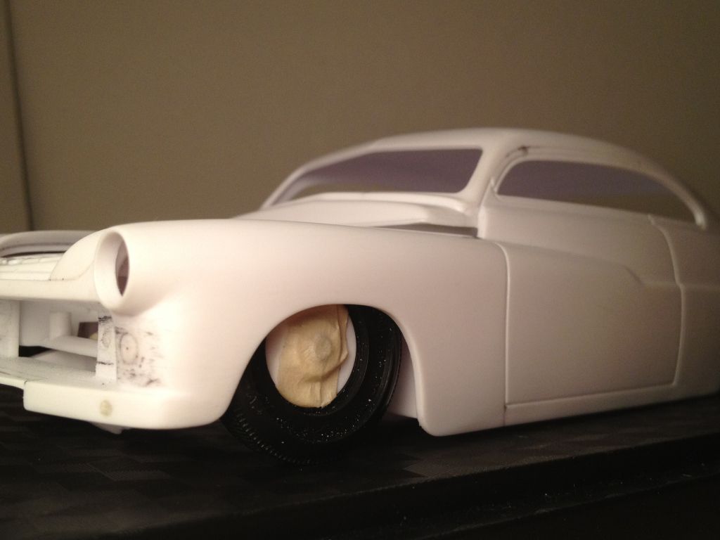

Good to see you making such excellent progress. I'd love to see the body on those wheels, see how low it is now riding.
After taking these last photos I couldn't get the camera to shoot right so I took some quick ones with my wife's phone. I'm hoping to get it a tad bit lower, I may even body drop it to sit the body on the ground. We'll see.
Posted Image
Posted Image
