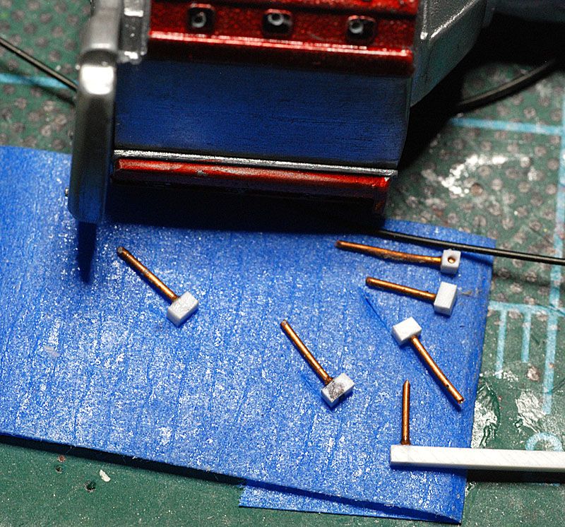

Continuing on with engine detailing the plug boots were next. I drilled some .022" holes into.08" square rod for pins into the engine and for the plug wires. Both holes were drilled int the rod before cutting and the engine pin glued before cutting off the rod. I only lost one unit! The cam covers are all drilled to receive the pins.

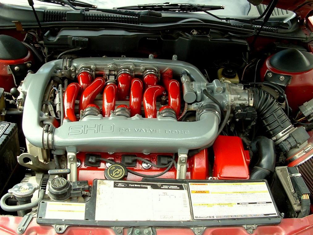

The 1:1 engine photo shows what I need to replicate. It looks like I'll have to make an oil filler cap and decal
Posted Image
Posted Image
Now that I'm on the ignition I can't find the distributor from the SHO engine. It's just a box with some ribbing as it models the cover normally used and the wires all go in one side in a group. If it doesn't show up soon I'll just make one.

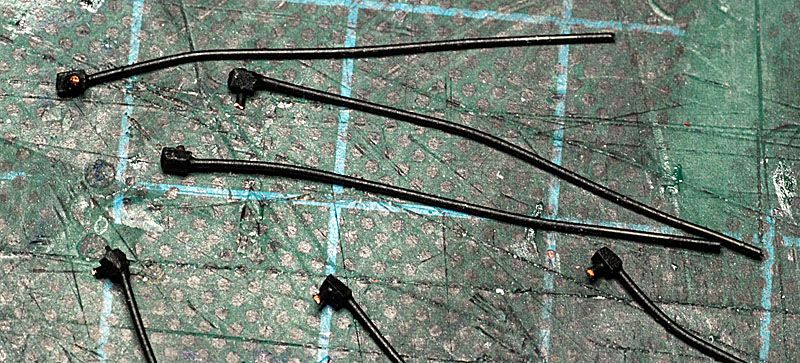

More on the plug wires. All shaped, painted and mounted on engine. Of course, one wire detached from the boot and might be tough putting back in the off center hole. Oh well, normal for the course. These were sure tiny!
I never found the ignition box so I made a crude one from plastic pieces. It'll do as it will be tucked into the fire wall and not that visible I expect.

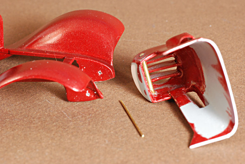

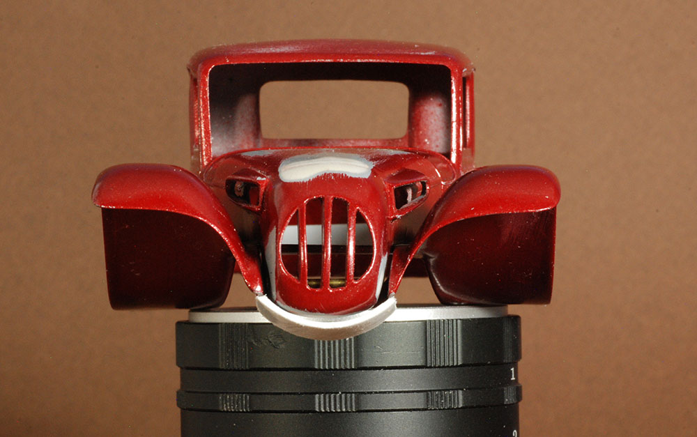

I had another paint here that was lighter and had a very fine metallic and I liked how well it went on in previous tests, sooooo ...  Duplicolor Autumn Maple Metallic in a spray can
It looks good but still doesn't have the ZING .. IT.  Suggestions are always appreciated.
The big question I have for all is what do I paint the wheels? ALCLAD chrome them again?  Everyone here has wheel opinions so here's your chance!!  :)

that tracknose sure looks great on there and the paint is nice with good scale metallic particles, from the photos anyway. maybe if you want more zing...a coat of Tamiya clear red over the top?
great piece of engineering there!

Black Chrome on the wheels. I don't normally like black chrome all that much, but, here I think it would work. Be worth testing anyway.
