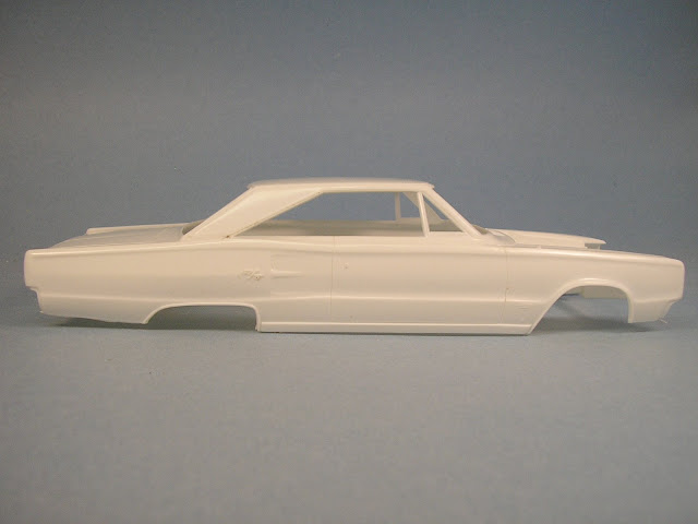

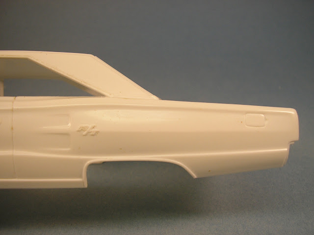

has anyone tried to correct the downward slope of the rear of the car? if you look at the body from the side, you can see that at the rear roof pillar, the body droops. any help on correcting this would be wonderful.

Here's a series of pics to show what I'm talking about..............I almost couldn't find this one..............it was buried under a TALL stack of models! :D
The eBay win model.................
Posted Image
Posted Image
Posted Image
Posted Image
And now the Revell model..............
Posted Image
Posted Image
Posted Image
The two together for comparison............
Posted Image
Posted Image
Anyway, just a little comparison to show that sometimes the "Big Companies" don't always get things right. Thing is though. we'll probably never see this corrected-----witness the two times Revell missed the mark on the much wanted CORRECT '70 'Cuda.. :(

thanks for the pictures. you can really see the slope in the rear of the revell body. i was going to let this slide on my builds but everytime i look at that kit, i see that droopy rear end. i am going to take your pictures and see if i cant come up with a way to correct the problem. didnt realize the work to be done to the roofline.

The roof on this looks way off. Too high and too short. It needs a good three to four inch chop to look right.
To correct the Revell body, I would first try adding a mm+ to the top of the quarters at the rear and taking away a mm+ where the quarters and C pillars meet. It looks like it has a little too much rise in that area anyway. Of course,you would need to also adjust the character line just below it to make it match. That may or may not be enough to "fool" the eye and make it look like it doesn't have too much droop in the rear. If that doesn't work, time get out the razor saw and do a lot of hacking and whacking. I have a kit with a primered body that I got in a trade. I may see what I can do with it.
EDIT: After looking at some photos, there's no way that idea would work! Time to get the saw out! I'm going to take a little time with one just to see what I can do with it. It will certainly be a challenge!

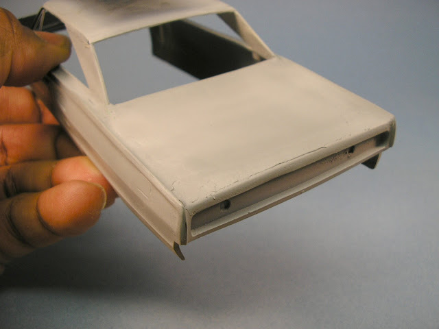

I've began correcting this body,but so far, it's taking longer to take the photos and download onto Photobucket than it is to do the actual work. So far, what I'm doing is working.

I have my body pretty much done as far as the cutting/moving/adding material and getting it glued back together. All that's left now is putty and sanding work to get the mid character line straight again. I took a lot of photos of the process,but Photobucket doesn't want to cooperate for some reason today.

I got my body in primer last night. Something else that needs work on this kit is the rear bumper. It doesn't fit well at all and it doesn't have anything to do with the mods I did. The ends of the bumper should extend upwards farther at the top to snug into the body and should be more of a square shape at the the top corner where it meets the body. It also looks a tad short in overall height. Something else I noticed while looking at photos of the real cars was that every example of the R/T had bumper guards on them. Something else I need to do some more research on is the character line above the rear fenderwell. It looks like it has too much of a swag in it in my eyes.
Here's a photo of mine now in primer. The primer is rough because I applied it in mist coats to prevent ghosting. The passenger side still ghosted in one area, but for the majority of it, no ghost lines at all. I don't know what kind of primer was on this beforehand,but it was awful! I've had this project (got it in a trade) for well over a year and it almost immediately clogged up my sandpaper when I sanded it with 400 grit. If there is enough interest in the process I used, I'll do a tutorial in the tips and tricks section. I took several photos and covered each step.
Posted Image
Posted Image
put the putty and sandpaper down and start typing

Posted 12 September 2012 - 02:14 PM
:lol: Before I do, I want to check to see how the interior will fit. It should be OK, but I want to make sure first. It may take me a while to do also because I'm having trouble posting sometimes. Right now, I'm using a different browser and everything seems to be working. Plus, I think there are around twenty photos of the process. I need to cut that number down some if possible.
boy, would really appreciate the pictures. how long would you say it took to correct the body? yours looks 100% better than the origional.really appreciate all you did.
