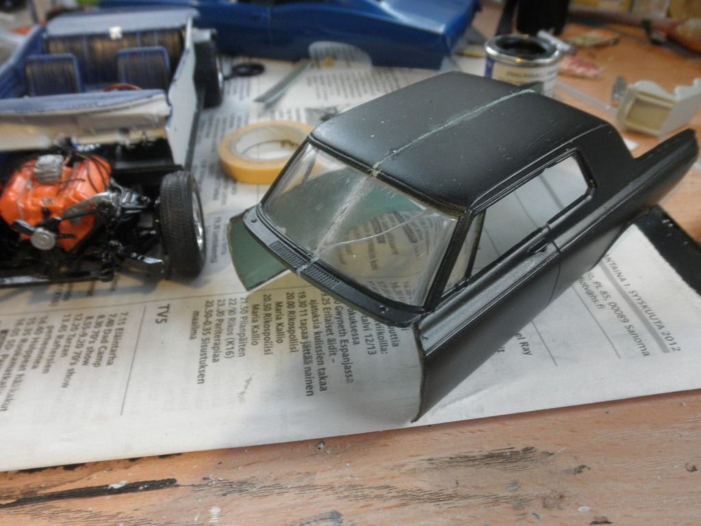

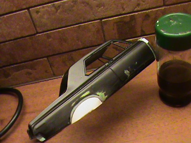

I started working today. I'm building this while parts are drying for other builds, so I guess it's not gonna be finished in week or two. :lol: But it's not going to take forever. Honestly, I've been planning to build something like this for a while, but today I decided to test my new Razor Saw. It worked nicely. Here are some pictures.
The project Basis was this Glue Bomb.
Posted Image
Posted Image

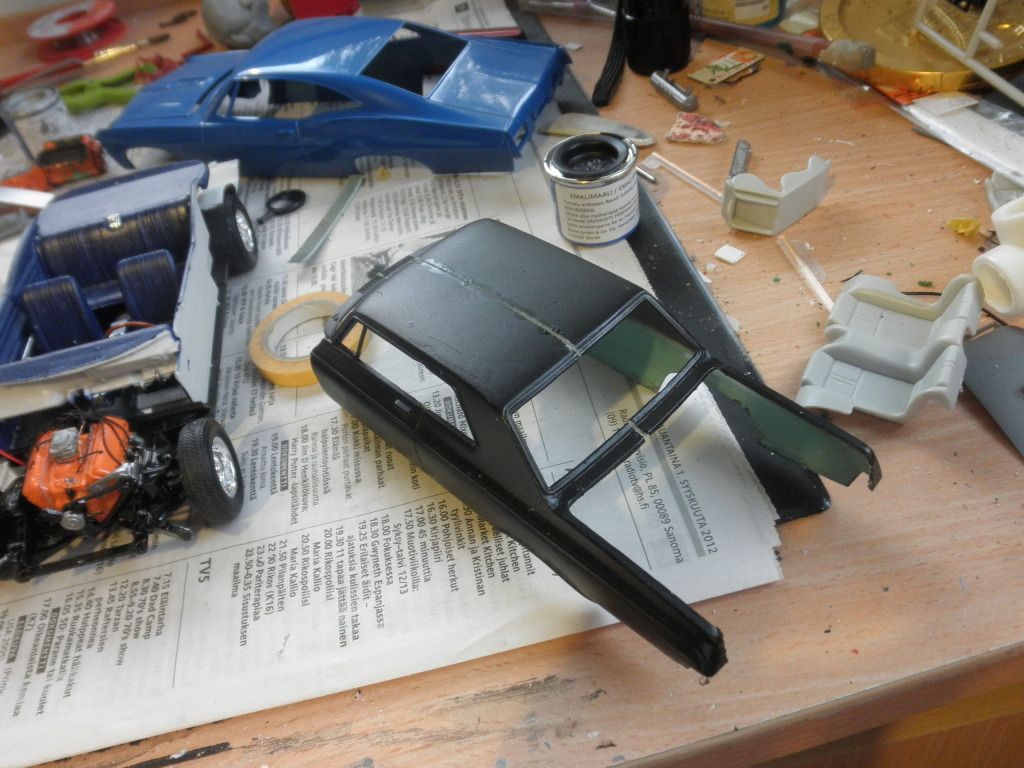

Well, of course the body was too wide, so..... ;) :P Here is the top sawed.
Posted Image
More sawing:
Posted Image

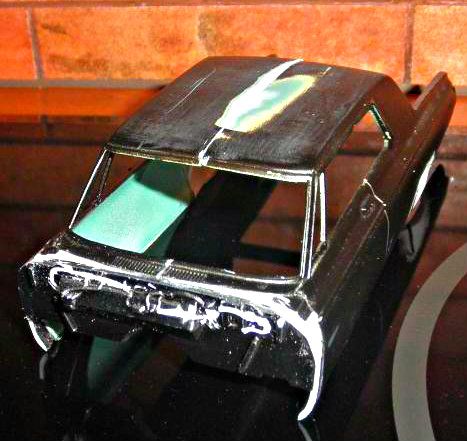

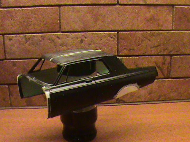

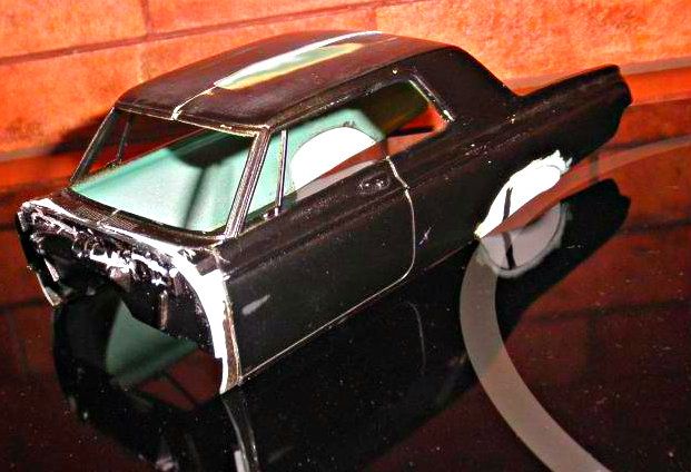

Then I glued the body halves together. Now some styrene and bondo, then it'll look better. I'm planning to fill the rear wheel openings from the body, move rear axle forward and shorten this body from rear side of rear axle.
Posted Image
Posted Image
Posted Image

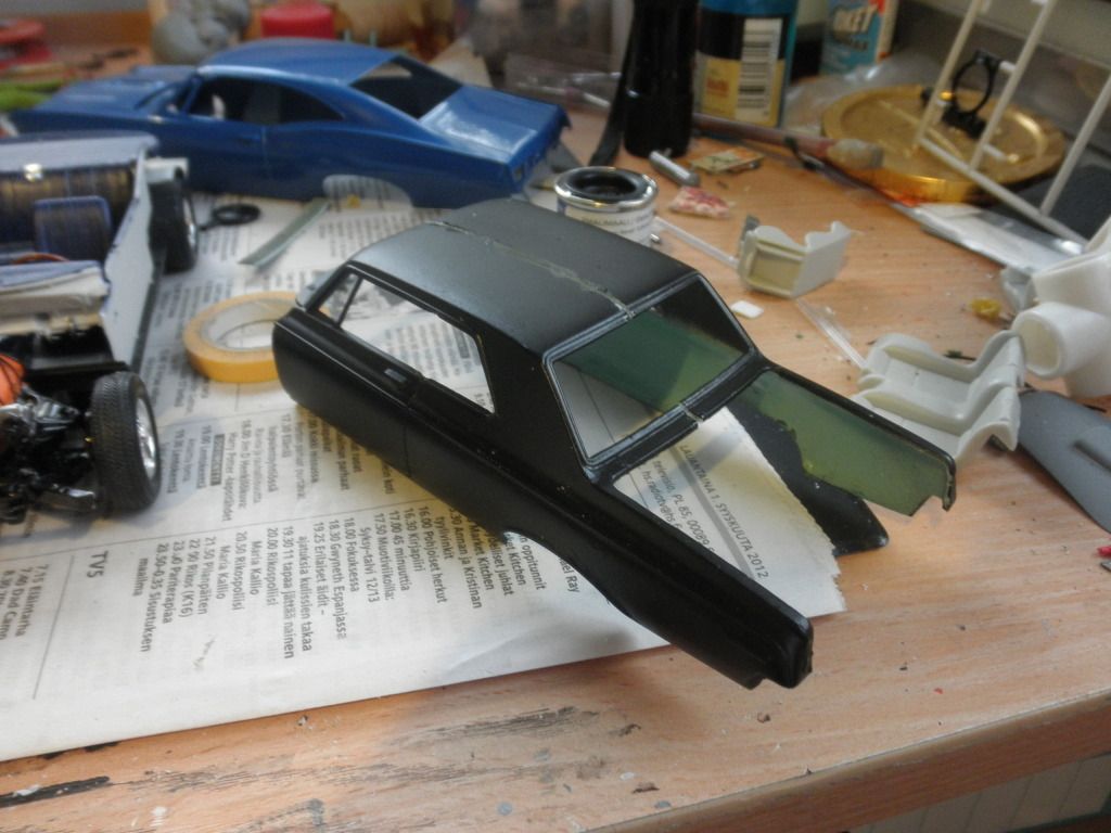

And then I started making the windshield. It's not the easiest thing to do winshield for this, because nowhere will probably be correct glass, and it's inpossible to make one from actetate. So I took the kit's windshield which had seen better days, but that's not so important, since I will make it smooth now, after narrowing and then I will heat form new windshield from acetate.
Posted Image

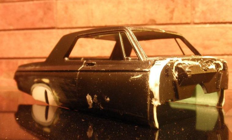

Here we go again, little more work done. I removed rear wheel openings from the body using styrene. I've also started building the firewall-area, but more on that later when I get some more done.
My camera is broken, and these pics are taken with my video camera, which don't take as good "still pictures" as normal camera does.
Posted Image
Posted Image

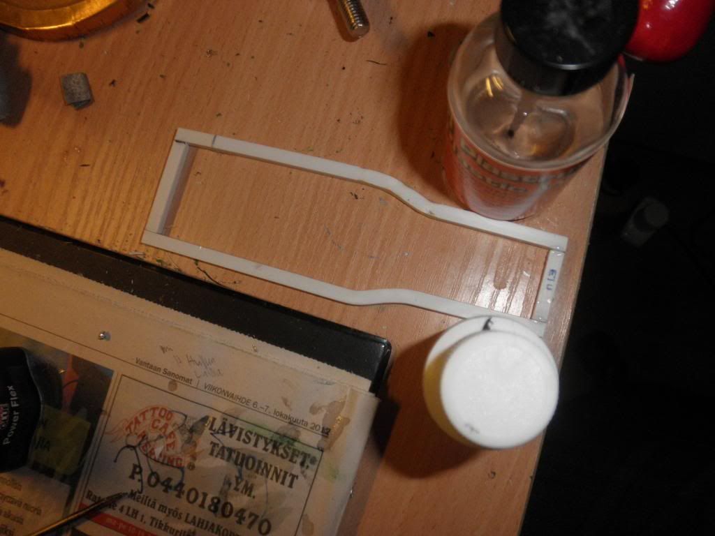

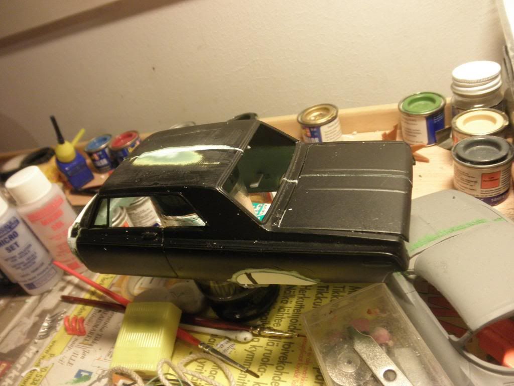

And sorry about the delay, it has been collecting dust, but today I pulled it back, and here we go again. I added little styrene to the front end to get that firewall fit right. I did not narrow it from the center, because it would not be easy to sand those putties smooth there because it's not straight part, so I trimmed the sides to match body shapes. As you can see, there's still some need for styrene.
I also started making the frame. Not much done yet, but it's coming slowly....
Posted Image
Posted Image
Posted Image
Posted Image

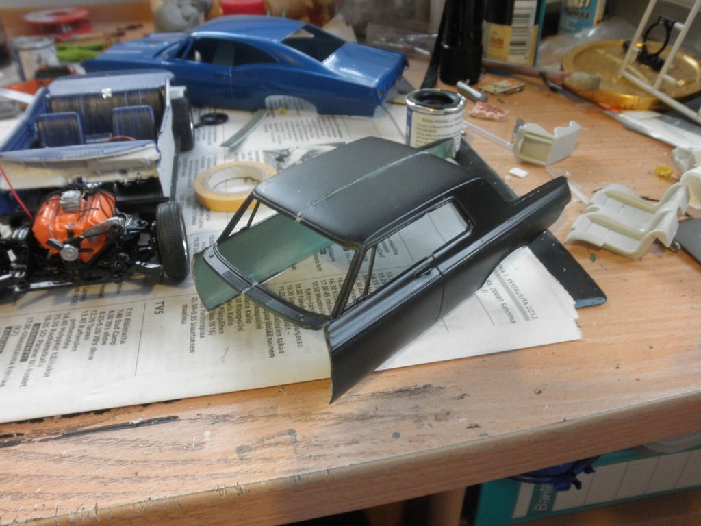

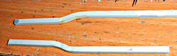

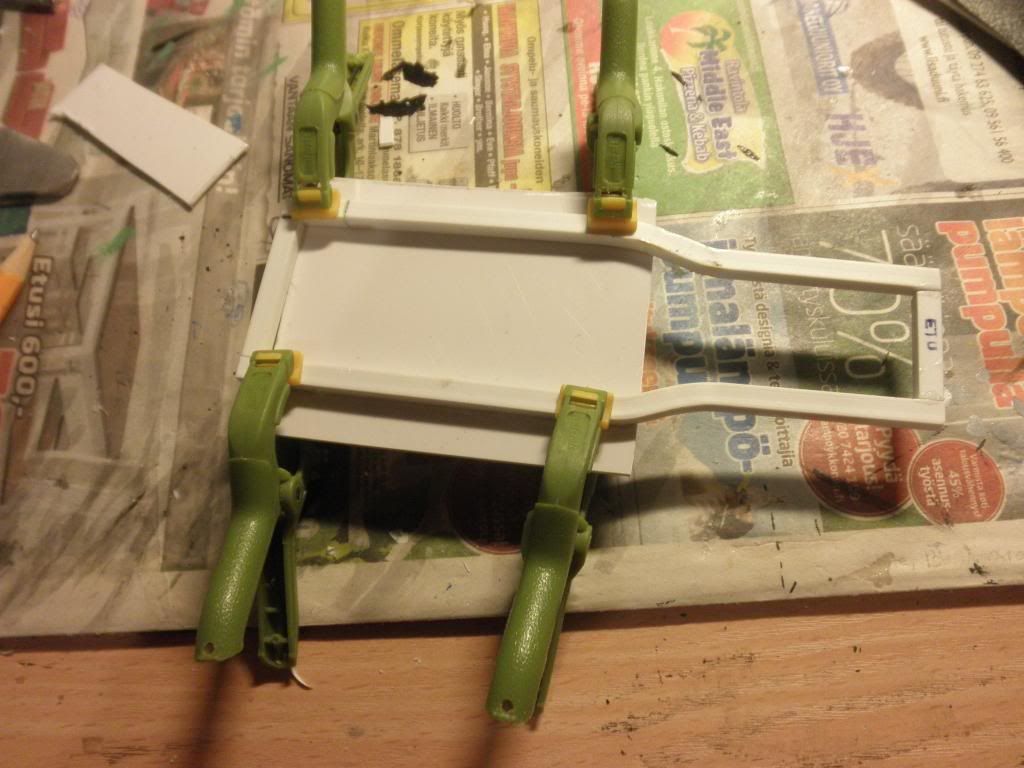

Thanks, Corey! I got some more done with it, started making the chassis. I know the frame rails are quite heavy stuff as you saw in the last picture, but that's the way I like it, bigger car, bigger frame, right? Started the floor too, it's sheet styrene and still taking shape, actually this project is still in rough stages. The driveshaft tunnel will be fabricated when I decide, what engine I'll use.
Posted Image
Posted Image

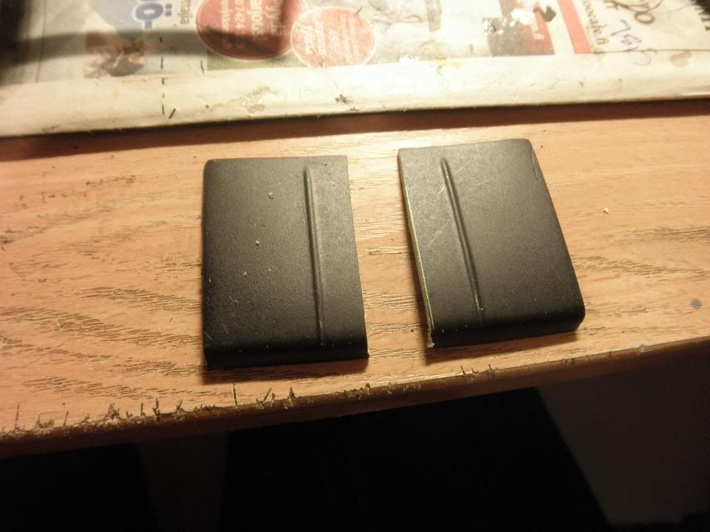

Also, here is the next victim: The Trunk Lid:
Posted Image

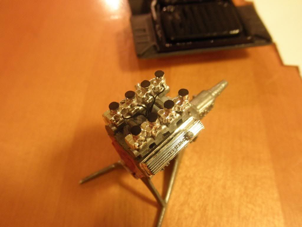

Posted 16 November 2012 - 05:58 AM
Thanks, Corey and Bruce!

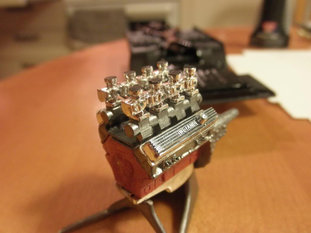

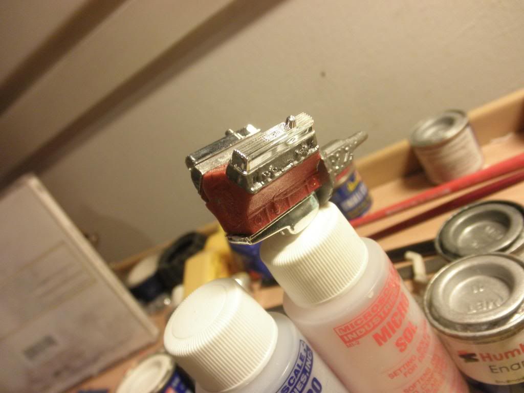

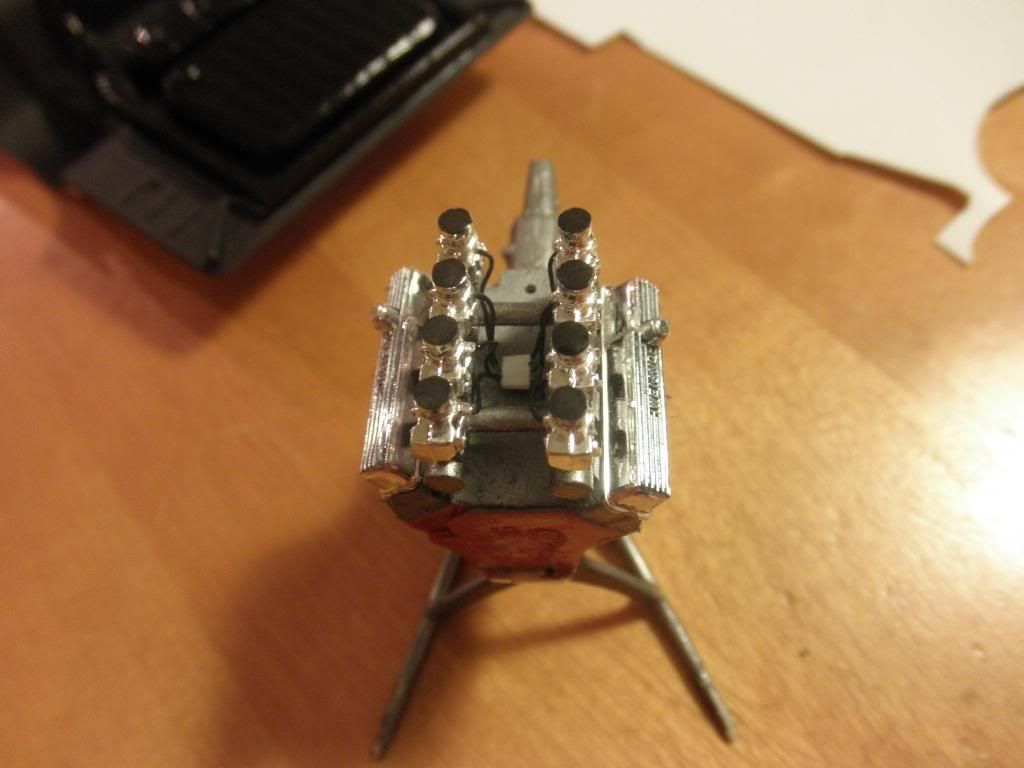

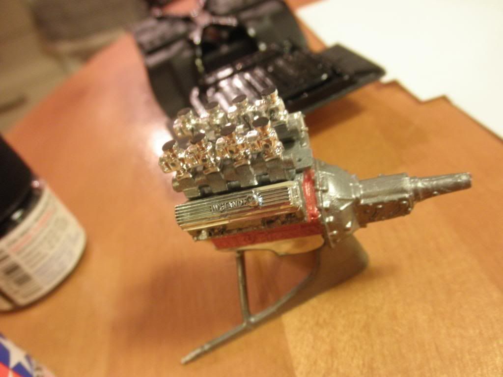

Here's some more. I got the trunk lid narrowed and glued to place. I'm planning to shave that whole trunk away, so there would be no panel lines there. Also, I found the engine basis, it's a Mopar and I guess it's Small Block. Not sure though. I've painted it that color few years ago, and it's going to stay in that color too.
Now I've been building the engine bit more than the pictures show, I should have the update soon before I finish installing and connecting carburetor fuel lines.
