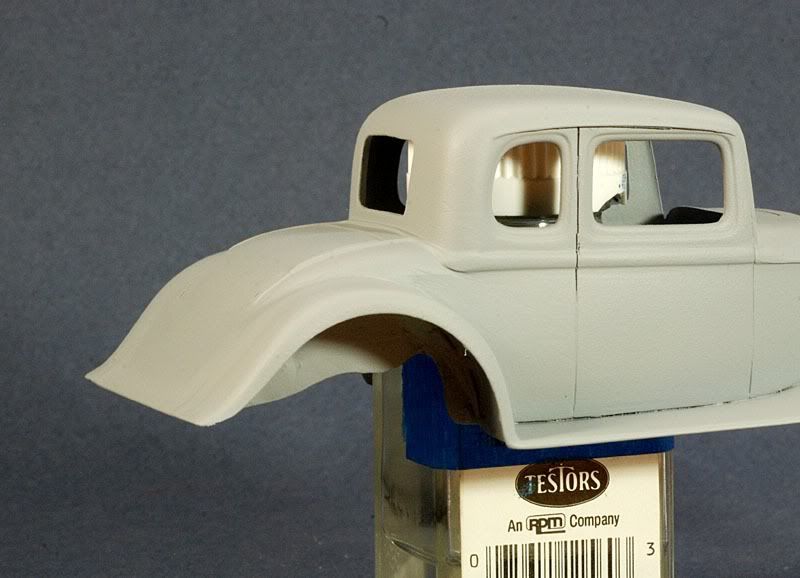

I have to bend some .03" sheet to match the end curve on some '32 Ford fenders as shown in the photo. I want the fenders to extend across the width of the body. I want them to have a set so they won't put pressure on the joint. I'm guessing a hair dryer or hot water will soften it to bend the shape and a dunk in cold water will set it.
So, I'm asking those with some experience on this to give some insight and any recommendations you may have to accomplish this.
Thanks in advance.
Posted Image

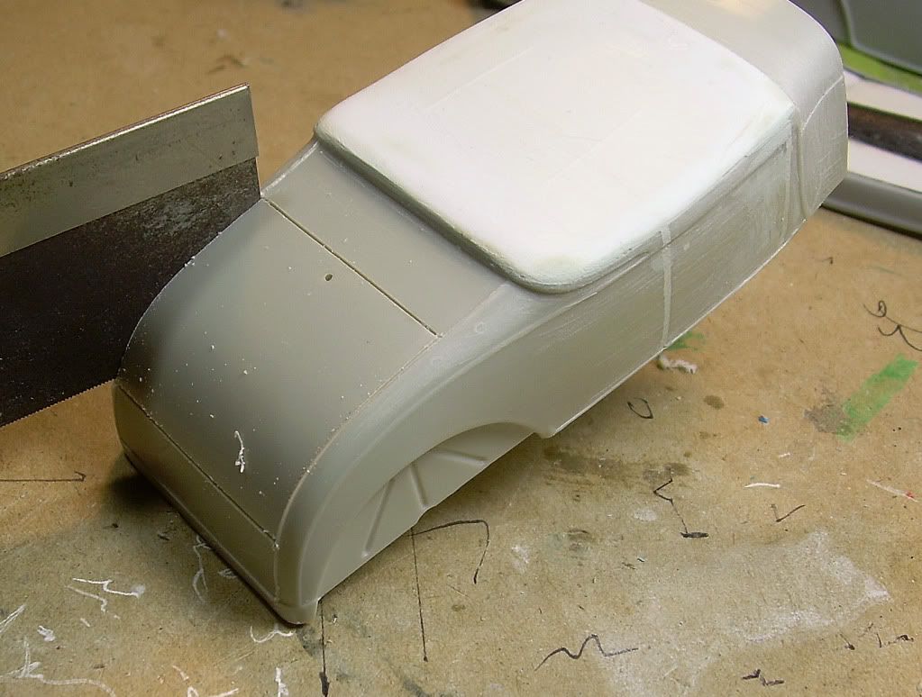

I formed this one-dimensionally curved .030 firewall by simply shaping it carefully with my fingers. Polystyrene, like many materials, has an 'elastic limit' that, once surpassed, will make it tend to hold an introduced shape. All this means is that you carefully bend your styrene sheet FARTHER than you want it, and it will spring back some, but not absolutely back to flat. Practice and you can get it to bend and stay exactly where you want it.
Posted Image
It's trickier to get it to hold a two-dimensional curved shape (a compound curve) but within limits, it's entirely possible. I made this compound-curved hard tonneau the same way....bent it carefully in my fingers PAST where I wanted it, and when it sprung-back, it stayed as I'd intended.
Posted Image

I want to thank you all for the suggestions and discussion. I ended up using a combination of boiling water and the old dry 'elastic limit' bend that was really all it needed and it stayed as I epoxied it in place. Sanding showed that it is flat all the way across .. nice .. and I'm a happy camper.
Posted Image
