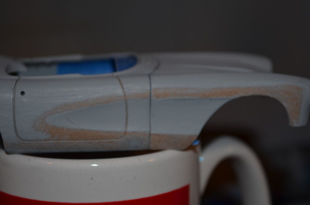

Here's a little update. I added the trim on onto the car and frankly...I'm not really happy with it, but not sure what I can do about it. Tips and suggestions would be really helpful on this. (The gloss is the wet primer.)

I'm going to let it dry and take another look, but so far...I'm thinking I'd be better off just sanding it off and leaving the car without that trim.

What did you do the line with, putty? I think it would come out alot sharper with either a small half round or round rod. It doesnt have a super sharp turn to it, so it shouldnt be that hard to do. The other thought I had was do a negative relief.. the inner round part of the trim you should do out of a piece of sheet styrene and then sand the edges slightly rounded off. I think that would look very innovative and badass. Just my 2c.

You were closer to getting it right without the trim, like you already said. Before the trim, the left side (driver's side) of the coves looked good, but the line didn't really flow right on the other side.
What I do when I'm trying to match body lines on separate panels is use real aluminum tape (the stuff I use is for emergency aircraft skin-repairs, but it's also sold for HVAC ductwork, and the thin stuff they sell in auto-parts stores will work pretty good) on the backside of the panels to keep them aligned while I file and sand and shape the two parts to match. Try to get continuous curves that don't flatten out in places. I know you can do it, because, like I said, before you put the trim on, the left side of the car looked really good. If you can hit it once, you can hit it again.
Another trick I use is to make a template from plastic or aluminum sheet with EXACTLY the curve I'm trying to get, and use it to keep checking my shaping-work. It also insures both sides come out the same.
This is a real bugger of a skill-builder, but keep at it and you'll be pleased in the end.
Brandon, I used .020" round rod. I created a cardboard template but that didn't work out well.

Whatever you are using for that molding. Only use straight pieces and only put bends in it where it needs to be bent. Find some kind of tubing the same size as that curve and bend it around that. Glue that first and then work your way to the front of that car glueing a bit at a time. But would strip it right down to plastic and do that first because the glue won't stick to paint as well as plastic. And use liquid plastic cement. The glue you used looks a little gooey.

Jon I used round rod and Testor red label liquid cement for my grill trim .I used a little super glue at the start to hold it in place.Use one piece to do the whole thing ,them after it dries go back and cut the door lines back in.Use a straight edge to line it up while the glue is still wet I did the peak down the hood the same way and puttied it in later .Hope that helps some :)

Okay my idea is this. Tape the fenders to the body REAL well. Nice and tight with the sides perfectly aligned. Then add the round stock in one continuous piece. Be careful not to get glue in the door crease doing this. This will keep you from having alignment issues. Use super glue. Tack the beginning and wait a couple minutes for it to set. This way you can pull lightly against it to keep the lines straight to the next glue point. After all is said and dried, cut the fenders away with a saw and do the same to separated the pieces over the door crease.

That's what I tried, but obviously didn't work out well. It's probably due to my shaky hands from drinking a gal. of coffee a day. Sooo... I have a new idea and I think I'm going to stick with it. First, I should tell you all that I sanded those nasty looking body lines off and saw that my body lines for the coves are slightly off and will need a little work. Second, I'm going to leave it at that. I'm sure all of you have seen the movie "Cars" from Disney/Pixar. Lightning McQueen was painted with the '57 Corvette scheme and he didn't have any trim around the coves. At this point, I think it will look better if I just do the body work and make the coves look perfect with sharp edges and just paint it with no trim.
Below are a couple pics of the sanded area around the coves. You can see that there is a little tweaking to do, but are, for the most part, straight.
Posted ImagePosted Image
Comments and suggestions are always welcome.
