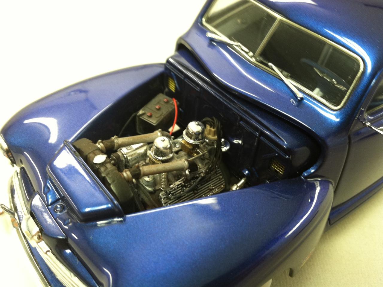

Actually this will make it a lot easier
Posted Image
Posted Image
This is pearl blue mixed with clear over the aluminum metalizer
Posted Image
Pearl blue mixed with clear over tamiya black laquer
Posted Image
Pearl purple mixed with clear over tamiya black lacquer
Posted Image
Stop light red metallic and clear over aluminum metalizer
Posted Image
Stop light red metallic and clear over testors gold lacquer

I don't know, folks, but results like these are hard to argue with . . . and my recommendation is when in doubt, buy the DVD and check it out for yourself. Follow the four P's and you will undoubtedly get similar results to these:
Posted Image
Posted Image
Posted Image
Posted Image

Rich-very nice of you to take the time to post your snaps-much appreciated. The 55 with clear, even in this 'raw' form looks terrific. I'd like to go that way.
All your spoon samples clearly (pun intended) show how the base makes a huge color difference. With clear added, the light reflections are pinpoints-very nice.
Although I can, I'd rather not use a polishing kit to 12,000 on the final coat. So if I can get a color + clear topcoat to look like that, I'm a happy dude.

Cato no problem. But let me specify the Chevy and the spoon samples don't have clear coat over them, or polished. That's straight from the airbrush. The clear was mixed with the actual color to make it a little more transparent. I polish it regardless how smooth it comes out anyway it makes it look that much better.
