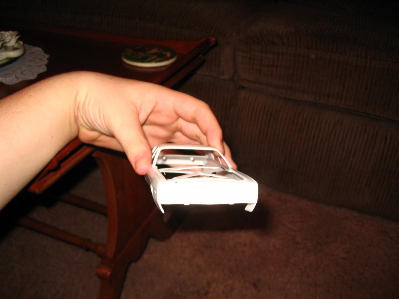

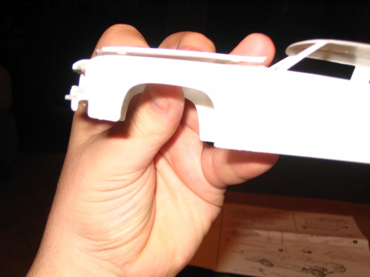

The hood sits lopsided, the problem is the molding on the cowl panel piece, is it supposed to be removed or does it stay?
Attached File  IMG_18051.JPG   124.76KB   27 downloads
Attached File  IMG_1808.JPG   59.22KB   33 downloads
Attached File  IMG_1810.JPG   73.52KB   28 downloads
This is the new Round 2 kit and i just bought it today.Thanks in advance.

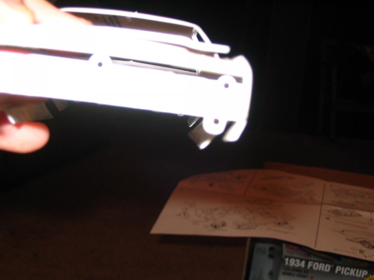

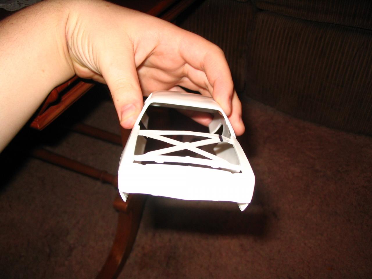

I have another bad one, Round 2 MPC Monaco (Roscoe's car). Same deal as Caprice, anyone else had this happen with these two?
Attached File  IMG_18391.JPG   84.03KB   24 downloads
Attached File  IMG_18381.JPG   74.04KB   18 downloads

l have never built this kit. does the insructions call for it to be removed.? if the hood sts high in the back it may have to be removed...

The strip up front needs to be removed. The cowl piece must stay or else you won't have anything to glue the bottom of your windshield to. The cowl should straighten out once you get your firewall glued in.

It's an MPC kit, so there are always (well, it seems like always) some small fit issue. These kits have been around the block, and in MPC's heyday, they were molded and modified and molded hundreds of thousands of times. As a result, things don't always line up and small fit issues arise - sometimes the small issues make rather large problems. I am currently building MPC's Gremlin and it is riddled with minor fit issues - mainly because, like so many MPC kits - it was modified yearly to make the new annual kit. You will need to heat and massage that plastic to get the cowl down where it is supposed to be - do it now before you get paint on it or some assembly done. I also have the Caprice kit and mine has some minor body "bends", but I pretty much go into an MPC kit figuring things will be a bit of a challenge.

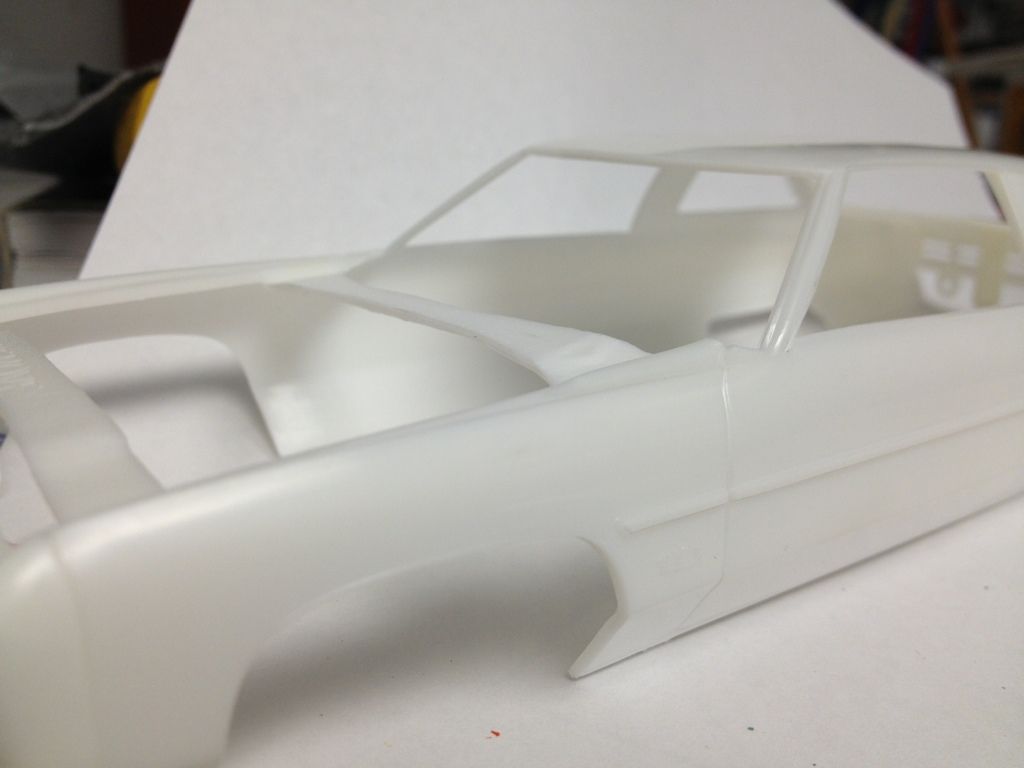

...look at the picture posted. It clearly shows not only that the bracing is in place (which needs to be removed) but ALSO the cowl is bent on the driver's side.
Oh, my error again. I see my ways...wrong kit for comparison - that kit doesn't have the cowl molded in. So...hehe...I thought bottom shots were the Caprice. BTW, I looked in on one of the Caprices I have:
Posted Image
This is what I thought I saw above - a bent cowling preventing the hood from sitting level. Now, my point? These kits (70s annuals..) are not perfect - expect some additional work.

For your second question you've got to remove the bracing before the hood will fit correctly. I don't have the Monaco kit so you will have to look in the instructions and see if they show the body with any bracing left in place but it looks like all of that will be removed.
