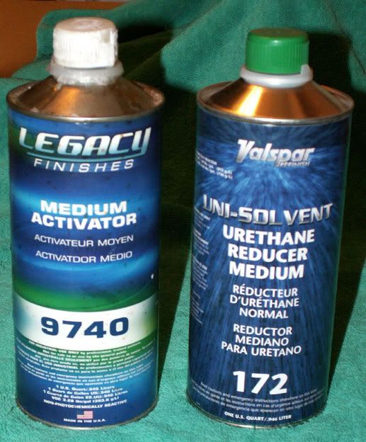

That said, I know you currently only use real HOK paints, but do you recall ever using any clear that worked well over enamels and lacquers?
Well, many will work (shelf Aerosols) as far as laying down, but over time they all yellowed.
In the DieCast Customizing world people who Rattlecan use a lot of Krylon Triple Thick Clear and say they like it.
Like you said, I found a product that always works and never disappoints, HOK Urethane Clear, and for those who want to save and get the same results,
Try this Clear also by Valspar,
Posted Image
With this Reducer and Catalyst,
Posted Image

Cadillacpat, how do you keep your activator from hardening? How much did the above pictured cost?
I buy a Quart ( you can buy Catalyst in smaller Pints) and pour 6 ounces or so into a smaller container.
This way I'm only opening and closing the smaller amount and the larger amount remains sealed.
Prices can easily be found using Search on Google,
Gallon Clear is $55
Quart Catalyst is $37
Quart Medium Reducer 172 is $16

$108 for all that, how long, or better question, how many bodys can you clear coat ?, for 1/24th/25th scale
That's not something that can be accurately predicted just by the total amount of ounces.
Martin I suggest you add up the amounts of Clear, Catalyst and Reducer that it normally takes you to Clear a 1/24 and divide it into the total ounces of the Gallon and a half of products pictured in my reply.
Those of us that AirBrush all do it slightly differently.
Stored properly and transferred to smaller containers for daily use, these products can haved a very long shelf life, even years of use.
