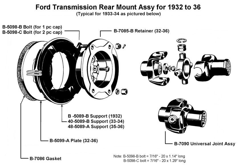

....in the Tardel hot rod book, the transmission looks like it's sandwiching the K member and bolting through to the little bumpy thing on the end of the torque tube.
Q: is that a correct conclusion?
Ummm, basically. There are running changes from year to year on how the old Fords were built. They were learning how to build cars by building cars, so to speak, and improvements were happening hot and heavy. The photo below is a '35 Ford gearbox, I believe, in a '35 Ford. The K-member has evolved into an X-member, but the function is the same...impart torsional rigidity to the chassis while supporting the gearbox and wishbone end. You can see the rubber mount that the gearbox pokes thru...
Posted Image
...and here is a GENERAL view of the mount itself. It bolts to the chassis at the sides, and you can see one of those bolts (silver) in the photo above.
Posted Image
This is a K-member. Front of car is to the left. Trans pokes thru hole in crossmember, mount is similar to the one above, but different.
Posted Image
Just to muddy the waters even more, this is how easy it is to mount a later-model gearbox in a '32 (or an A bone or a '33 thru '48) if the box is designed for a mount under the tailshaft....assuming an open driveshaft.....
Posted Image This trans could be bolted to a flathead and happily use the front mounts illustrated on that beautiful car posted by Drew. The front mounts are far apart enough to counter rocking of the engine due to torque reaction. This trans mount would NOT be a good idea with the more centered front mount on the truck flathead in the rusty shot I posted above. The optimum solution would be to re-work that front mount to carry out to the frame rails on either side, with a biscuit on each end.
