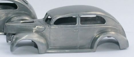

Here’s a shot of a stripped Fat Fender.
Posted Image
Posted Image
It doesn’t matter which issue of the Fat Fender you choose to strip, they all look the same without paint.
The casting is rough and requires about an hour of elbow grease to bring the body around to acceptable condition.

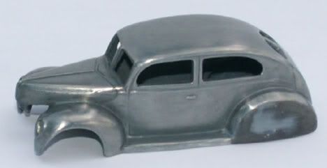

Here’s the same Fat Fender from above after filing, sanding and rubbing with Steel Wool.
Posted Image
Posted Image
From the pictures you can see I’m taking my Custom a little further than some might take theirs.
I’ve drilled out my headlights for Rhinestones.
I’ve removed the running boards to accent the fenders without harming the door handles or simulated chrome trim, and,
In upcoming pics you’ll see I’ve opened up the hood to insert a BoneShaker engine.

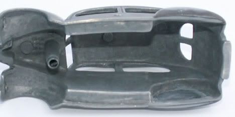

Here's an inside look of how the fenders are filled in,
Posted Image

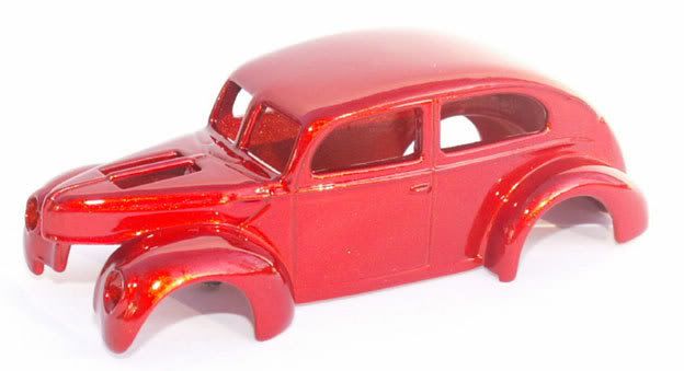

Here's one Raked and Chopped awaiting a snorkel breather from one of those Nitro Muscle Machines.
Posted Image

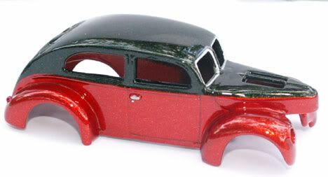

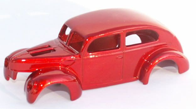

Here's another,
Jewelers Saw and 1/32" Brass Rod readies the hood for a BoneShaker Engine,

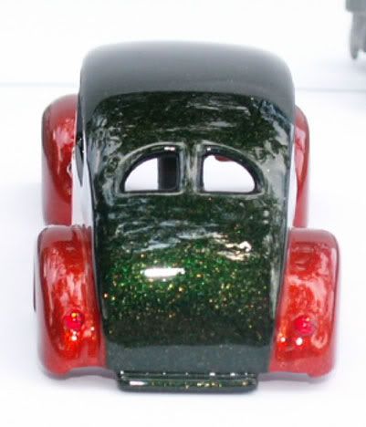

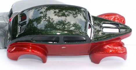

Primered and shot Shimrin White, then Zenith Gold,
Entire body shot in Tangerine Candy with Aztec Gold Pearl Powder,
Taped and the upper half is shot Black then cleared with SpringTime Green Pearl Powder.
Tape is removed and its cleared entirely with HOK Urethane Enamel.
The black now shifts from Black Pearl to Green Pearl.
All Products Used Are Exclusively House Of Kolor, Of Course!!!!!!!!!!!!!!!!
Posted Image
Posted Image
Posted Image

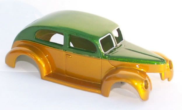

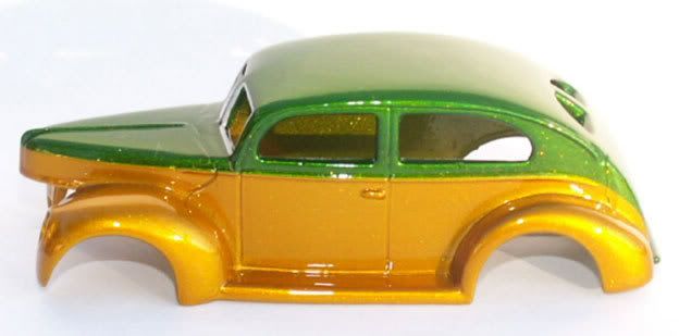

Here's a Fat Fender ready for Rhinestone lights and taillights.
Primered, and based with HOK Zenith Gold.
The whole car is shot with HOK Candy Pagan Gold and Brilliant Gold Pearl-Ex Powder Pearl.
She's taped off and the upper half is lightly scuffed with ScotchBrite for good second stage paint adhesion.
Then HOK Organic Green Intensifier with Spring Green Pearl-Ex Powder Pearl is laid down on the top half.
The colors go well together and this one is moving on to further details.
Posted Image
Posted Image
