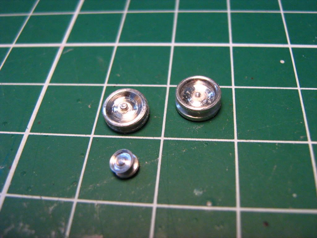

I turned some aluminum rod for the engine pulleys, but I can´t figure how to make the belts.
so I think i´m gonna use the kit pulley arrangement.

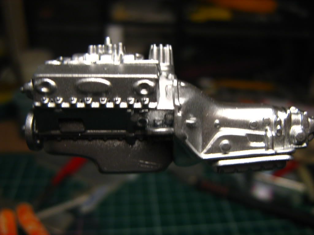

Painted the transmision in aluminum, also paint the engine block to find any flaws.

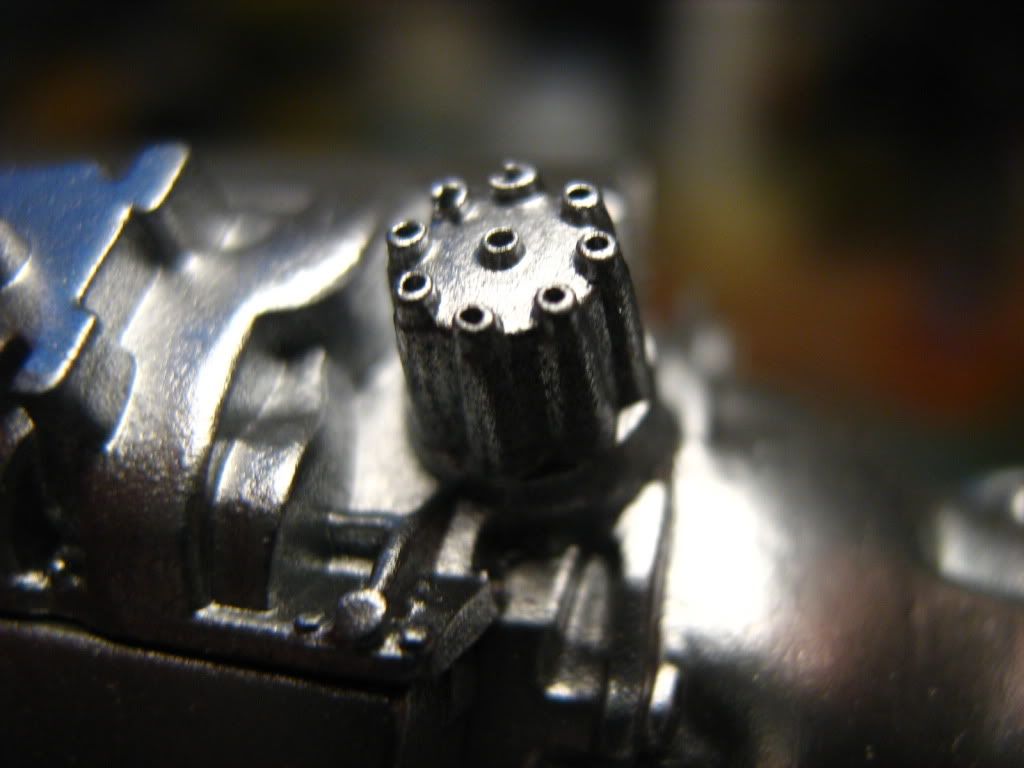

The distributor cap was drilled too.
Wich is the best way to make the spark wire boots??

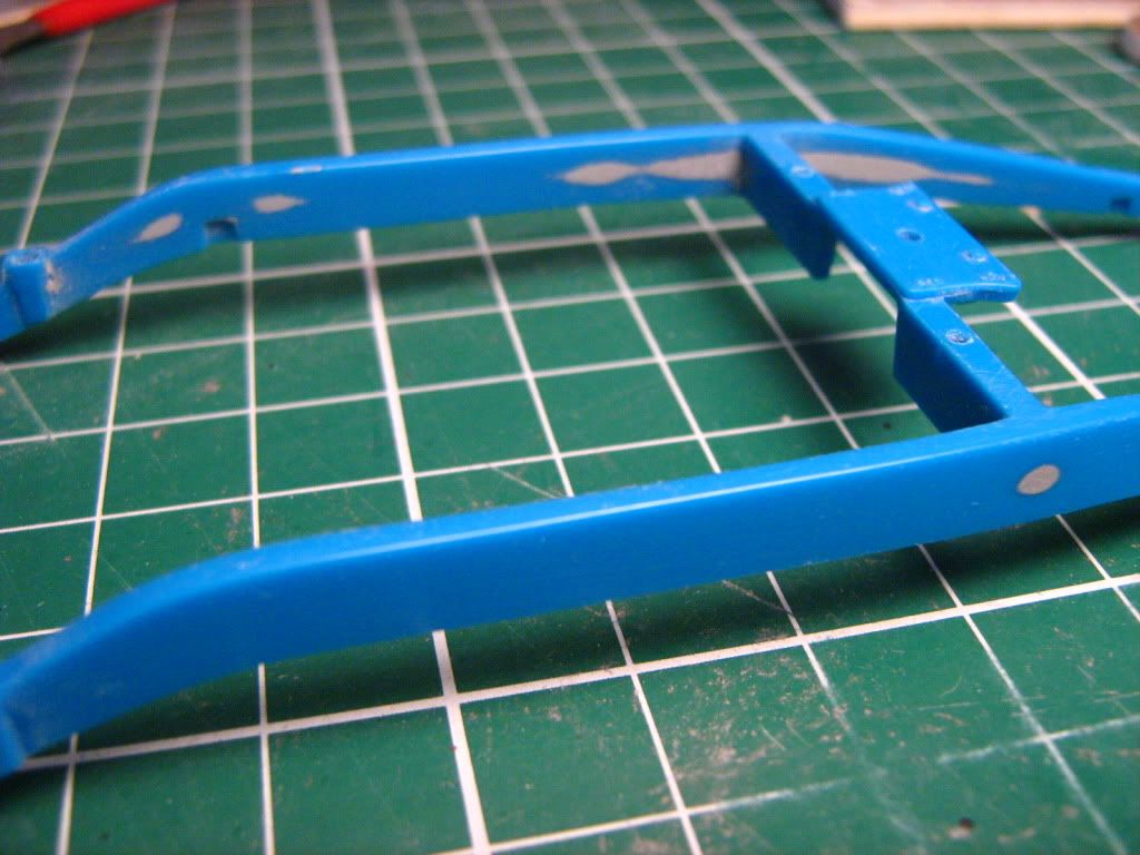

the chassis has too many sink marks, mold seams, ejector pin marks, etc.
It has to be filled, sanded and cleaned.

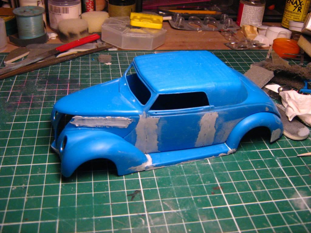

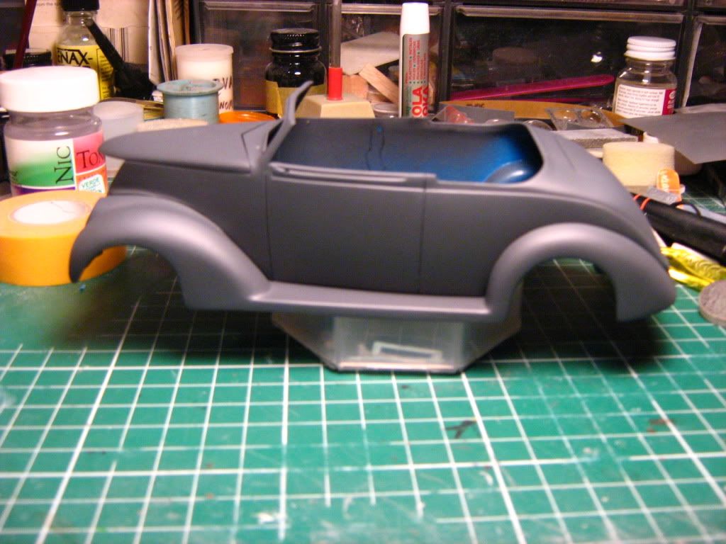

Minor update.
After sanding ( a lot ) discover many low spots, fill them and dry fitting the body.
Next..... more sanding!

I made another set of pulleys for this model, and delete the AC one.
I hope this set will looks better.

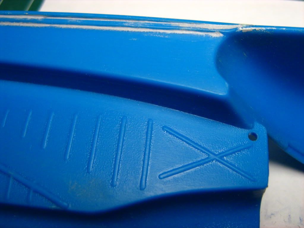

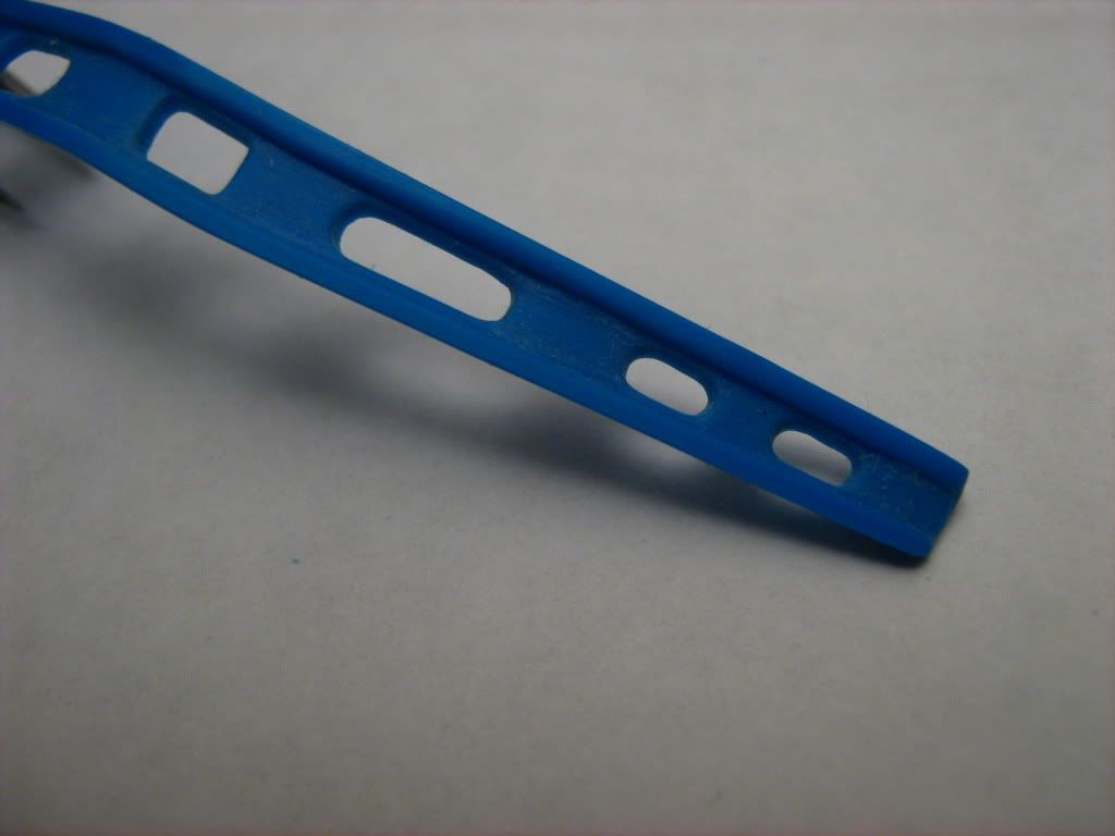

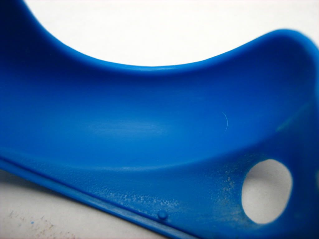

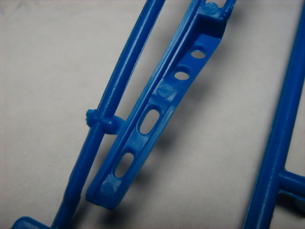

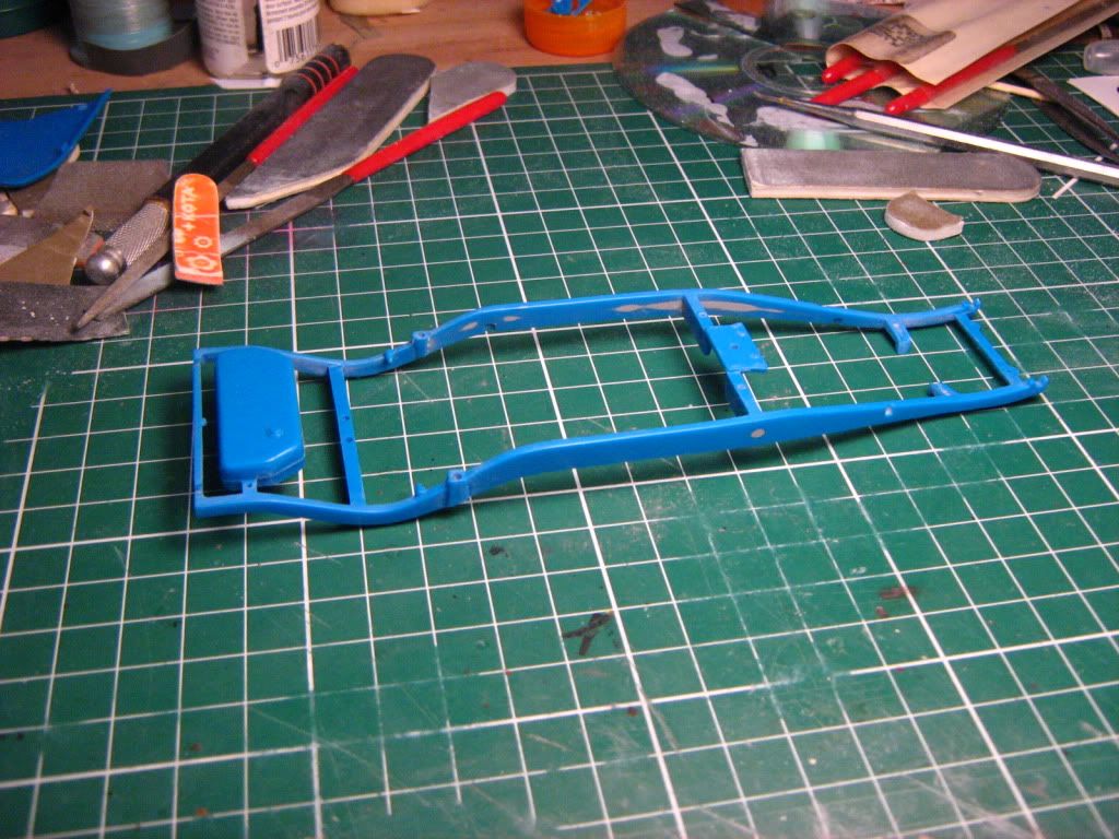

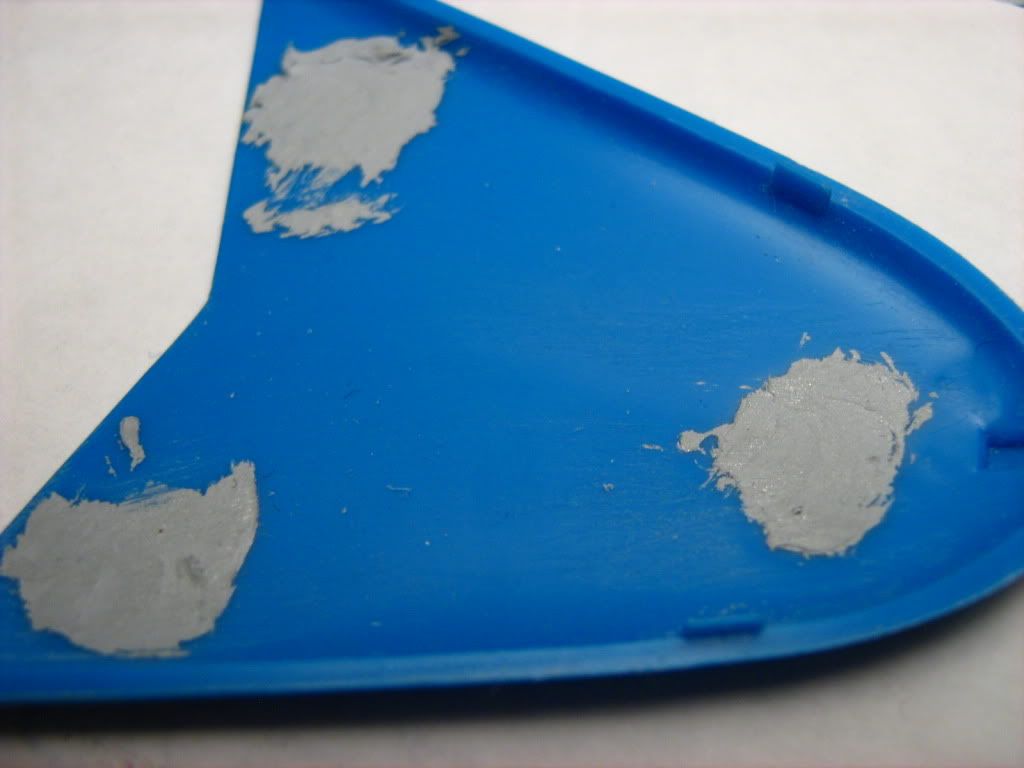

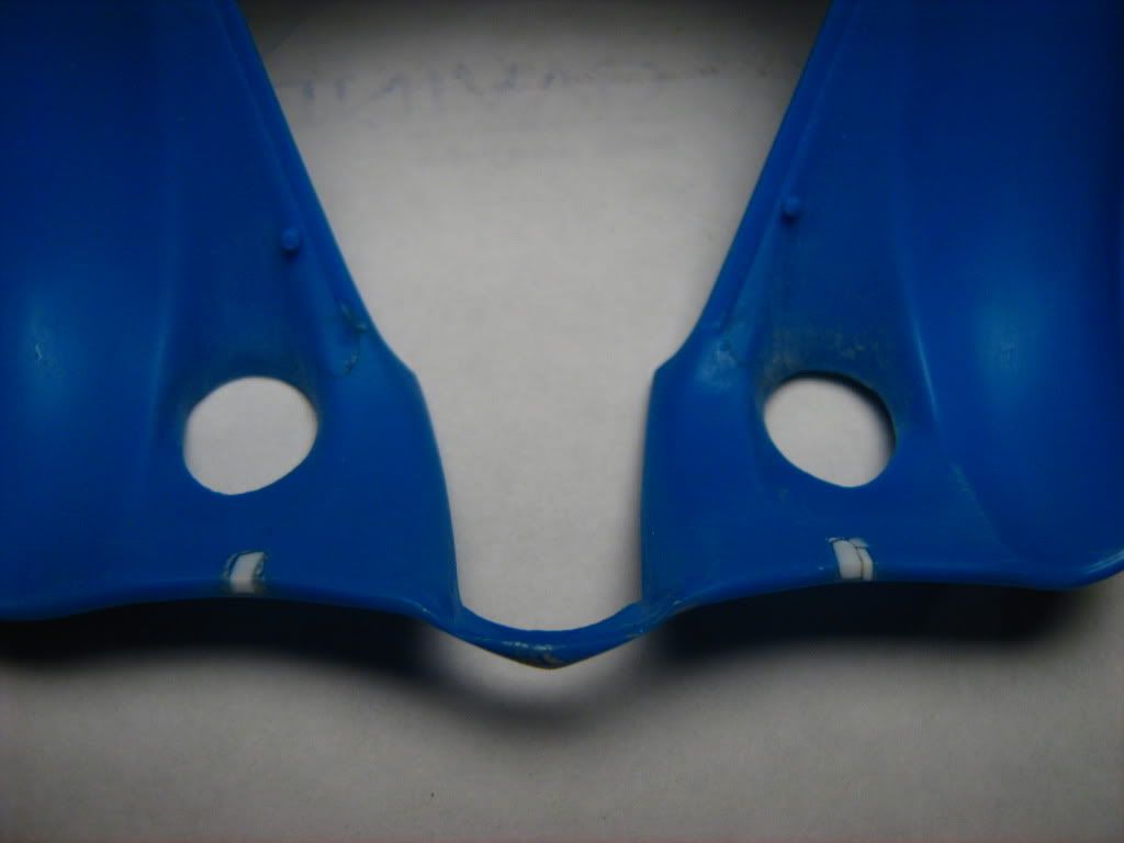

I have some troubles with this model, the big parts have many, many ejector pin marks, and the small parts have lots of flash and even some ejector pin marks.
I never see so many ejector pin marks in a small area on any aircraft model.
I have to fill and sand too much, my dear scale car modellers you have all my respect!!
did I mention that this kit have too many ejector pin marks?
Posted Image
Even this small area will be visible.
So sanding and cleaning is in order.
Posted Image

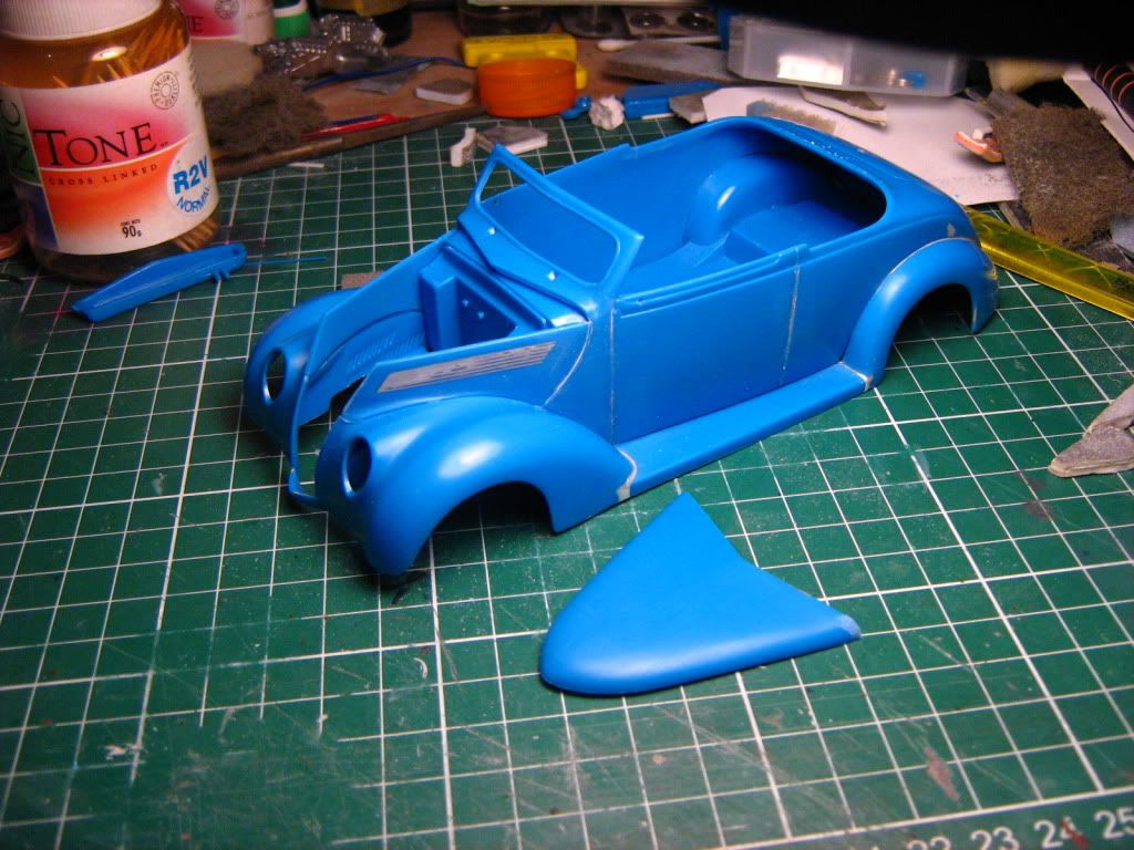

Under the hood there are more work to do.
Posted Image
I cut the gas tank to make the cleaning and paint work more easier.
Posted Image
There are some notches that need to be filled, because I´m not planing to use the bumpers.
Posted Image

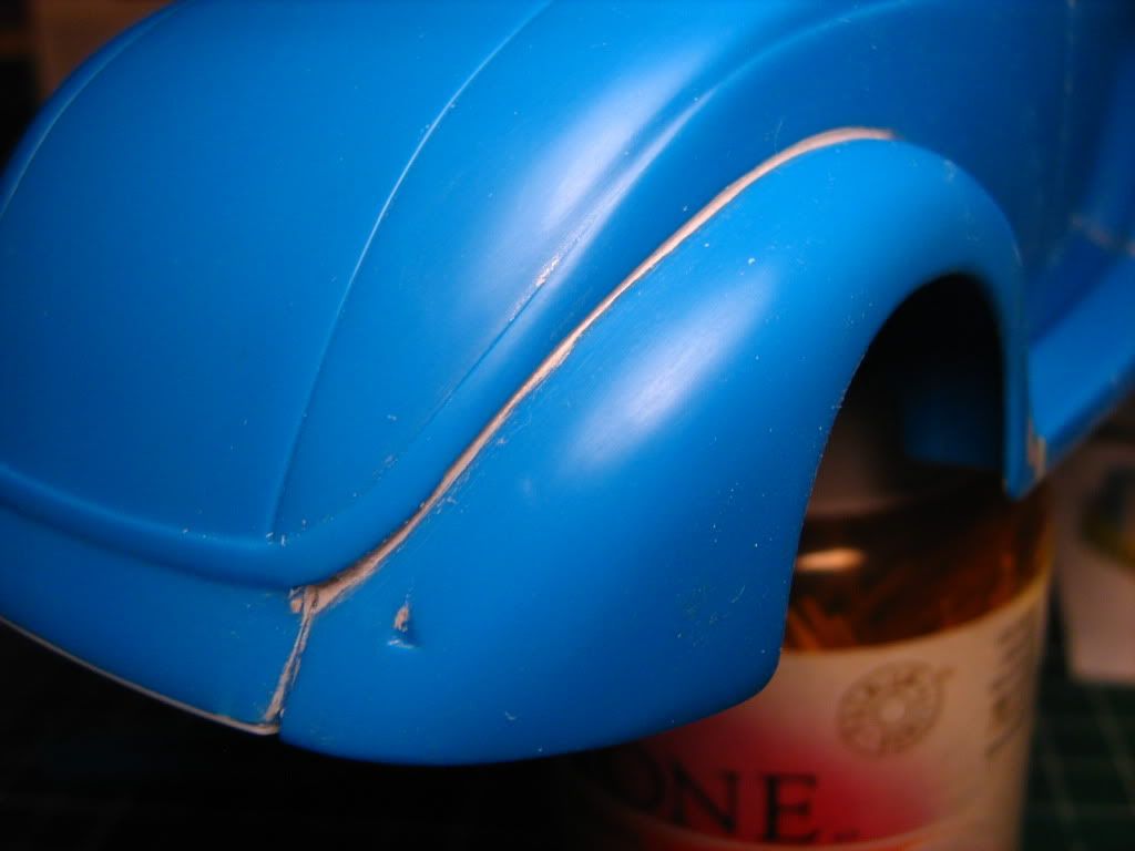

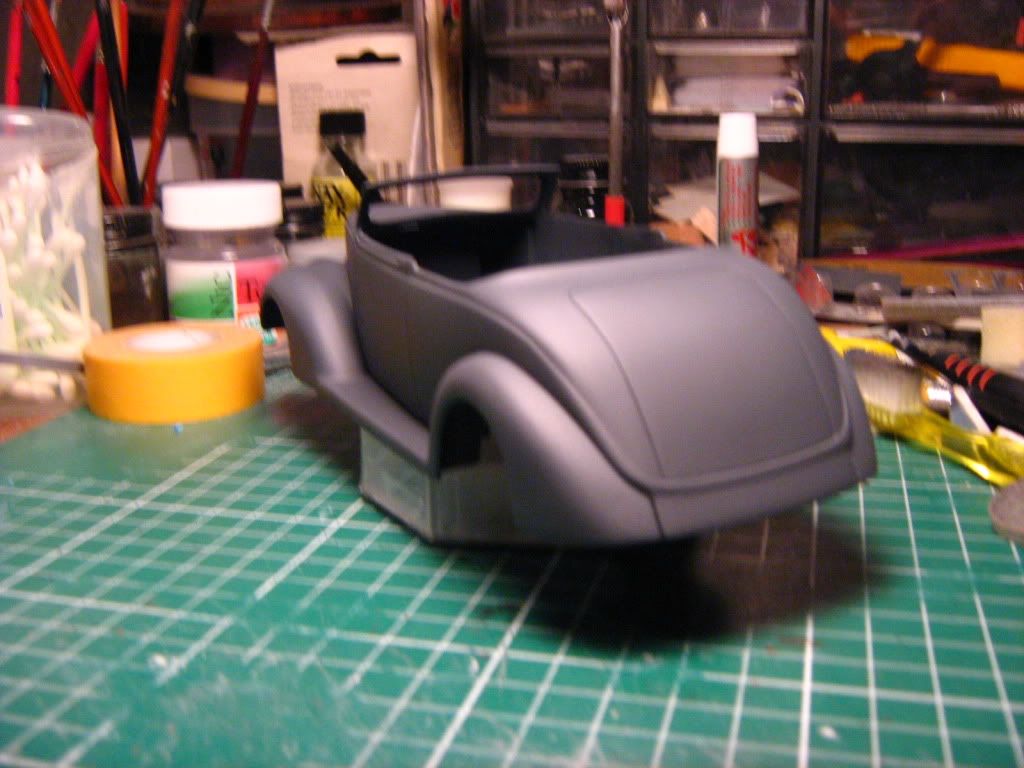

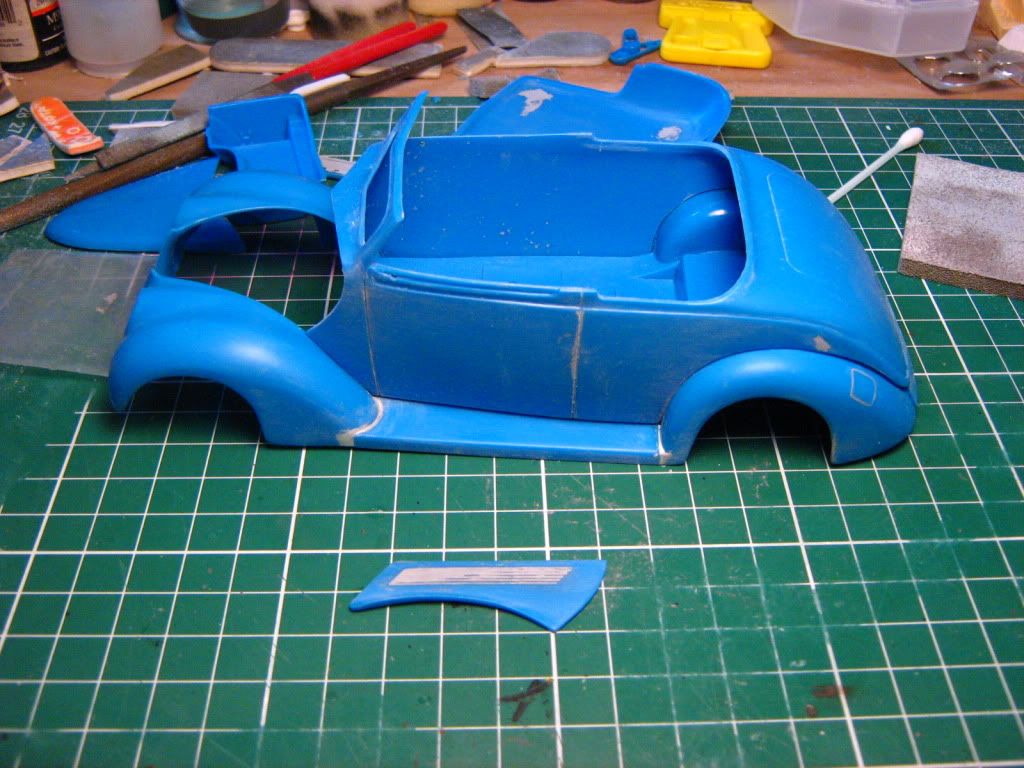

Ok. I glued the splash panes, the side panels and the upper body to the lower body.
Posted Image

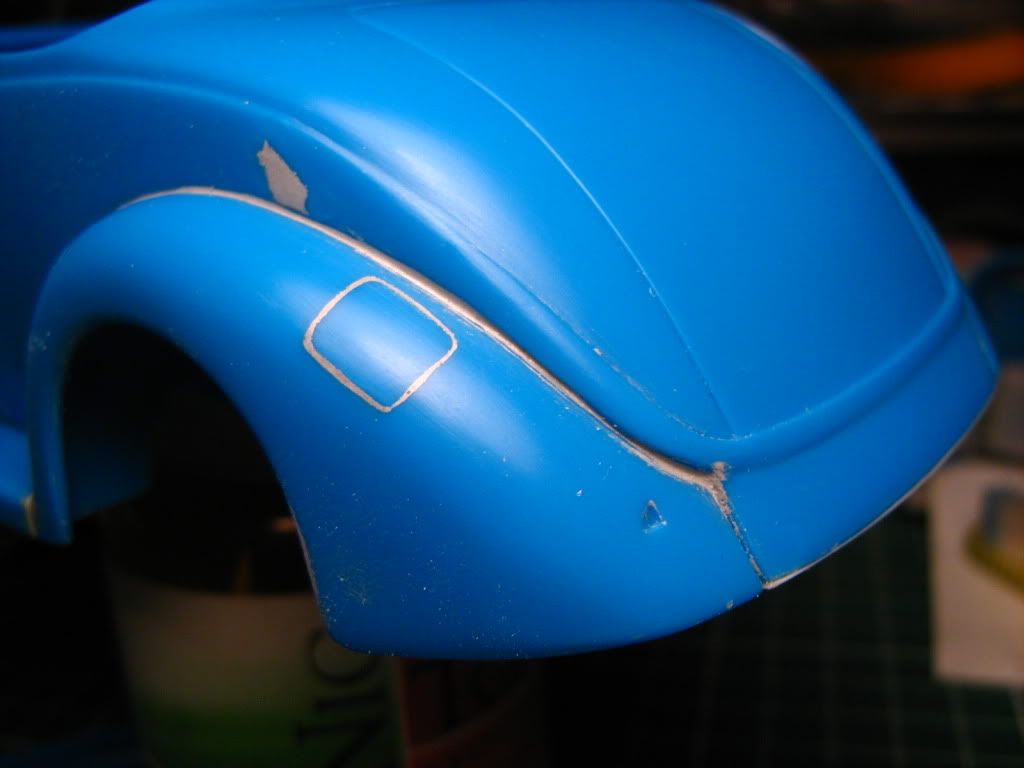

Almost nothing fits well in this kit.
Specially the rear of the upper body, it leaves a very notorius gap.
I use basic tamiya putty to work this out.
Posted Image
Posted Image

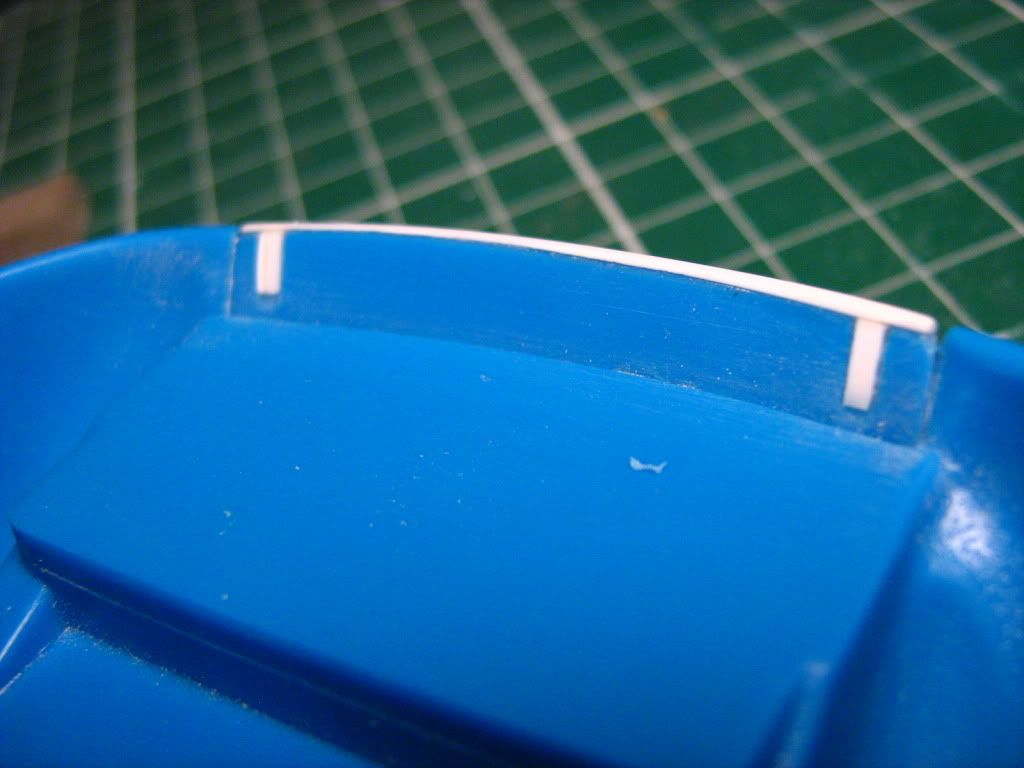

due to the bad fit the rear edges doesn´t line up well, so I add a thinplastic strip.
I glue it with super glue and then sand it to get the proper contour.
Posted Image

If you have glued the body to the fenders good luck getting the interior installed!
The underside of the floor and fenders are supposed to be textured as it represents a spray-on undercoating that is used to protected the underside of the car and prevent rocks from getting thrown up by the tires and causing a small dent from the inside out. Very common on full-scale street rods. Of course, if you wish it to be smooth that is okay as some street rods are this way too. Just pointing out it was intentional, not a quality issue.
This kit was orignally tooled in 1987 and at that time was conisidered one of the best street rod kits ever made with detail not previously seen. Even so, that was 25 years ago so the production techniques have no doubt improved since then.
Good luck with your project!
