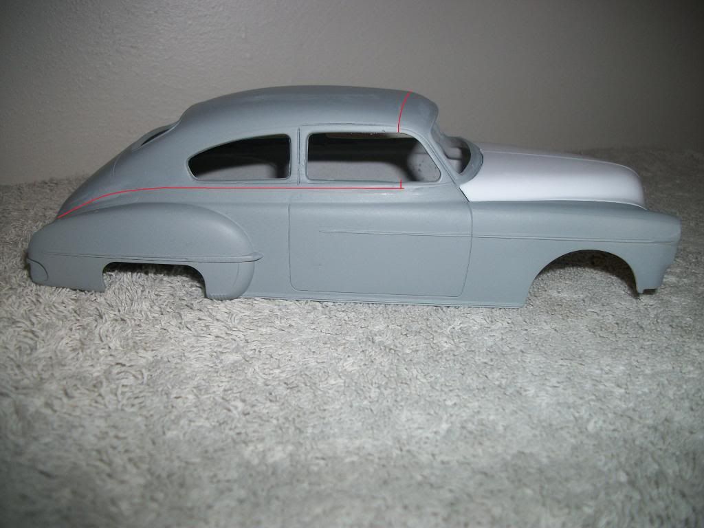

Looks good so far. I see you cut the roof behind the windshield opening to preserve the original Olds shape. Same solution I came up with. I'm still working out the right cuts for the rest of it, but mine is chopped, so the top of the windshield moves back, which in turn corrects the joggle in the rear of the door shut-line resulting from the AMT doors being shorter than the Revell.

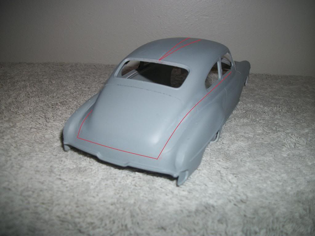

That sure looks good. Seems to be a pretty nice fit overall. It's hard to see where you mated it at the rear .. might you take another shot with the mating lines in pen or pencil for us old timers with bad eyesight to see how you did it? :)

Thanks for all the positive feedback! Here's a couple of pictures of the cuts I made. The wedge cut in the roof was made so I could narrow it in the front since the AMT roof is a few mm wider on both sides and it wouldn't match up with the portion of the Olds roof that I kept.
Posted Image
Posted Image
I hope this helps, I'll do my best to answer any questions. ...Billy

Thanks for the pic with the cut lines. :)
