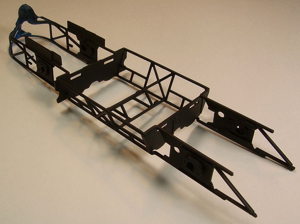

Thanks for the interest. There's a lot to this model. The one I'm building is the re-release before the current re-release, it has some old-tool issues, but I still love this kit.
Got some black SEM self-etching primer on fhe frame. It's a little fragile to take the usual scrub with Comet, but I got lucky and the super hot SEM primer bites this particular plastic just enough for good adhesion, but doesn't craze it. There's some re-work necessary to get the roll-hoop entirely accurate, so that end isn't fully primered.

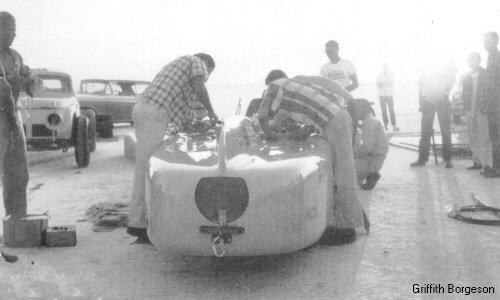

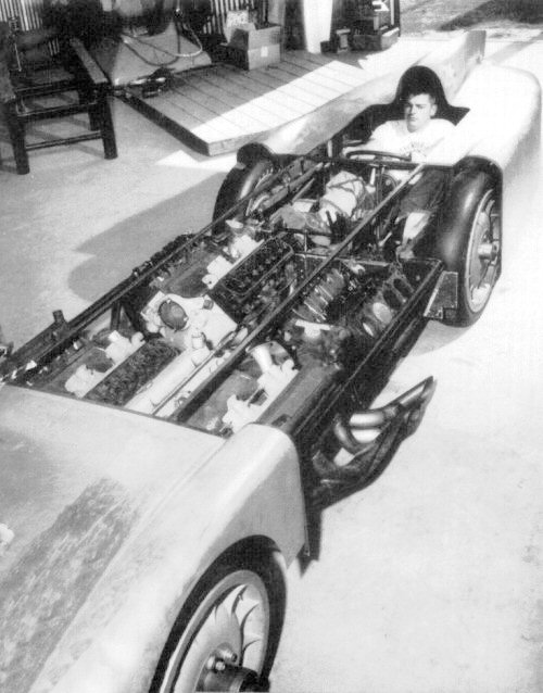

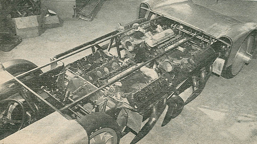

A few pics of the '59 car,

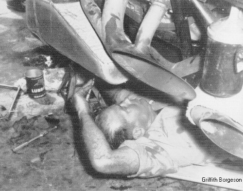

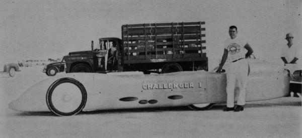

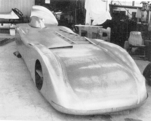

Posted 04 November 2012 - 09:43 PM
And a few more in the bare aluminum finish.

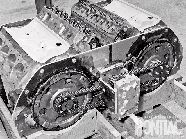

Bill, do you have a '59 Pontiac push car to finish off the diorama ??
Attached File  chall12.jpg   37.79KB   35 downloads
Edited by doggie427, 04 November 2012 - 11:14 PM.
#15 Ace-Garageguy
Ace-Garageguy
  • 9,050 posts
  • Location:Down two, then left.
  • Full Name:Bill Engwer
Posted 05 November 2012 - 06:46 AM
Thanks for the pix, Wayne. There are a couple I didn't have and I appreciate it. That mocked-up chain-drive transfer arrangement didn't make it to the running version of the car if I remember correctly. Power went from each engine into a conventional clutch, then into a side-shifter LaSalle gearbox, and from there into a Cyclone quick-change with one axle blanked off (4 clutches, 4 gearboxes and 4 quick-change rear ends). Engine synchronization was by very careful adjustment of hydraulic throttle linkage. And no, I don't have a '59 Pontiac, but I've kinda been watching the glue-bome listings for a starting place.

Nice start to the project. I didn't know that you could use self-etching primer on plastic without crazing it. Did you use any special application methods to prevent it from crazing?
#17 Ace-Garageguy
Ace-Garageguy
  • 9,050 posts
Posted 05 November 2012 - 07:20 AM
I got lucky on this one. I've had some really bad crazing on some plastics, none on others. Two that crazed horribly were the light-gray 38110 AMT '53 Studebaker, a fairly recent Revell '70 Chevelle and a Corvette C5-R. This older Revell Challenger H-1281:200 kit is molded in metallic blue plastic. I sprayed some test sprues VERY wet first with no reaction, and the frame came out just like I wanted it to.
All I can say is be sure to experiment on sprue from the kit you're doing, first.
