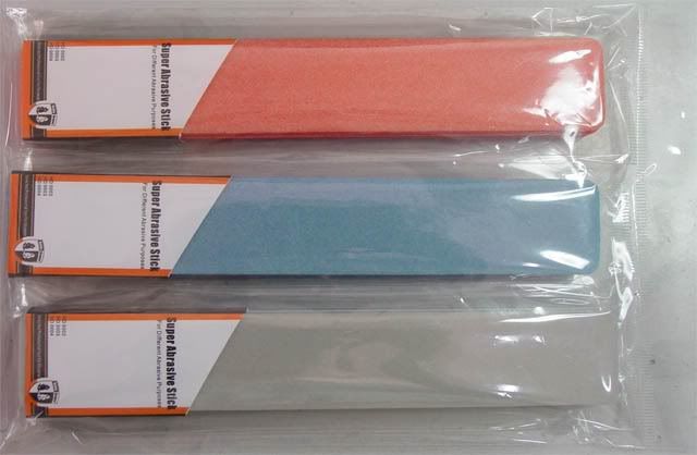

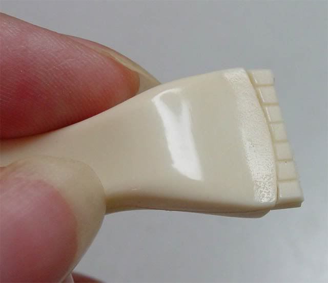

Hi,all,take a look at the polishing sticks below.What do you guys think?
one is for basic polishing(orange stick),the other one is for fine polishing(white and green stick)
Posted Image
look at their flexibility and pliability.
Posted Image
Posted Image
Posted Image

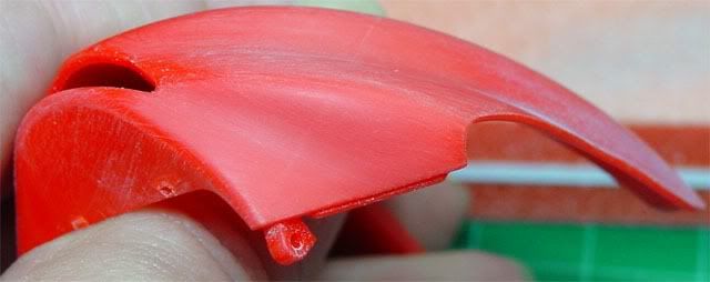

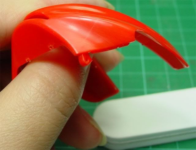

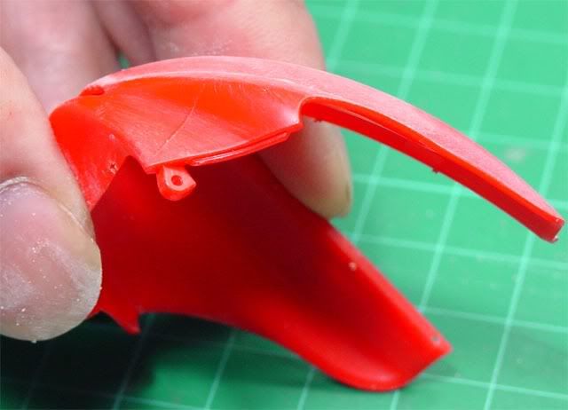

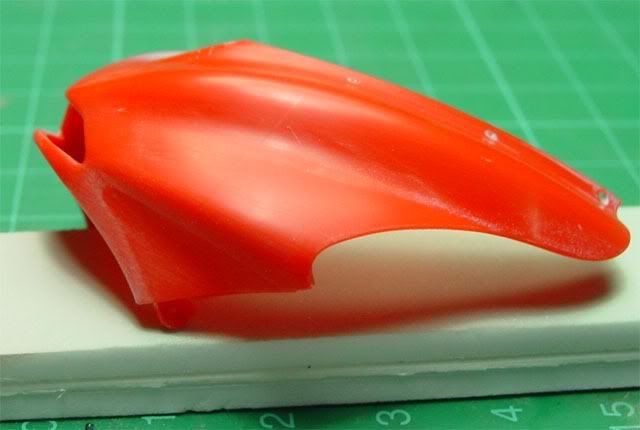

choose a part at random
Posted Image

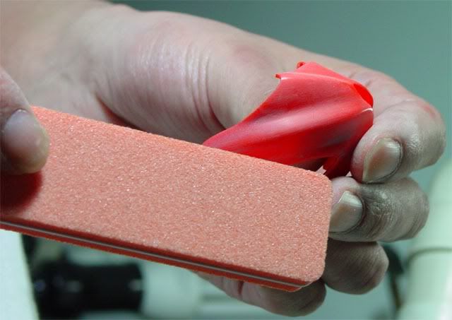

use the orange stick to polish
Posted Image
feel it is like Tamiya #600-800 polishing paper in a way,but more comfortable and easier when apply ,because the wider connection between the kit part and the stick makes the polishing work more efficient.Reduce about 50% of the boring polishing work time effecitvely.
Posted Image
take a look at the dust on after-polishing-work stick
Posted Image
magic result after wash it with water.(big suprise!)It means modelers may use the stick for more times!!!
Posted Image
#2 laurelflying
laurelflying
    MCM Member
  • PipPip
  • 21 posts
Posted 20 June 2006 - 12:23 AM

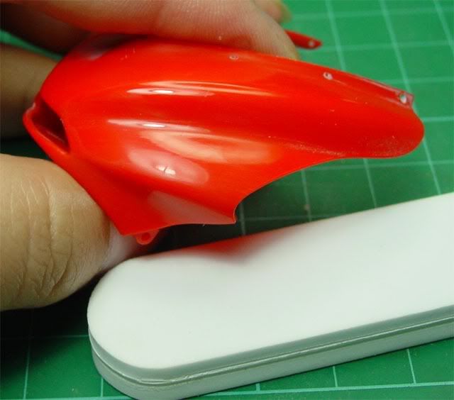

Then I was going to use the green side of stick B
Posted Image
Posted Image

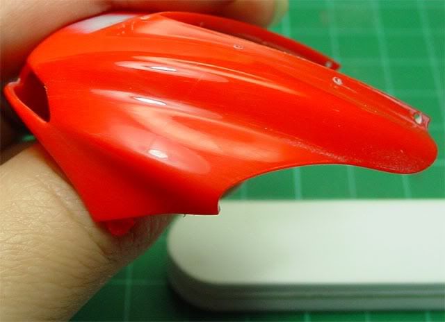

The result after using green side .Then I gotta to use the white side of stick B.
Posted Image
see the result after using white side.
Posted Image
Posted Image

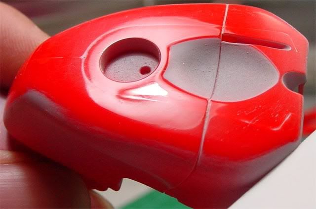

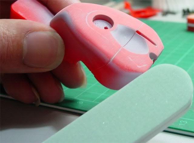

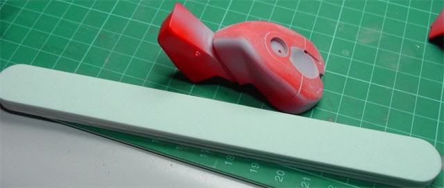

chose another part.Pay attention to the seaming scar in the middle
Posted Image
Used the already wahsed stick A again.
Posted Image
look at the result
Posted Image
cleaned it by my fingers
Posted Image

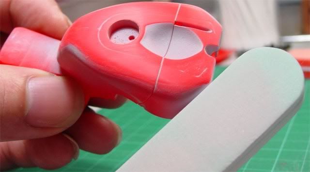

After using the green side of Stick B
Posted Image

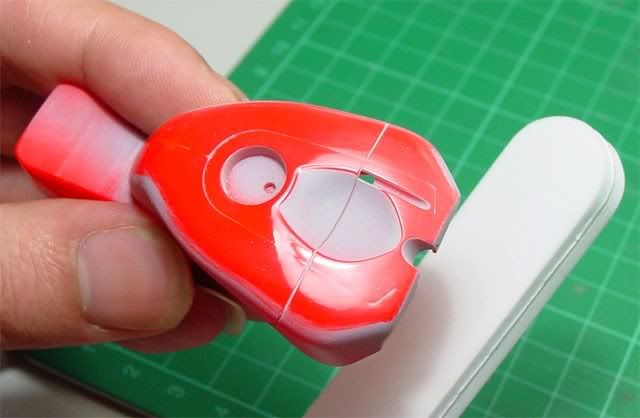

After using the white side of Stick B
Posted Image
Posted Image
Both of the Stick A and Stick B are double sides to polish

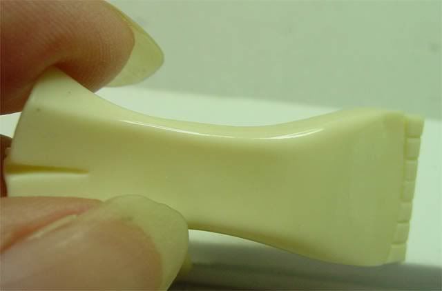

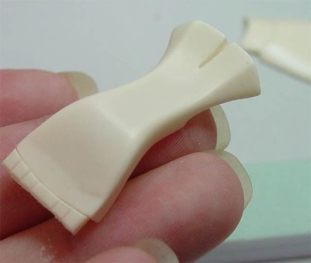

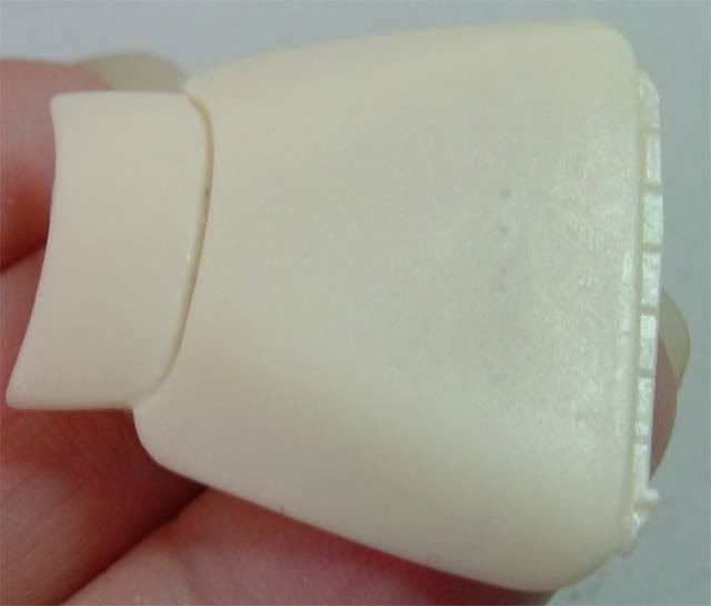

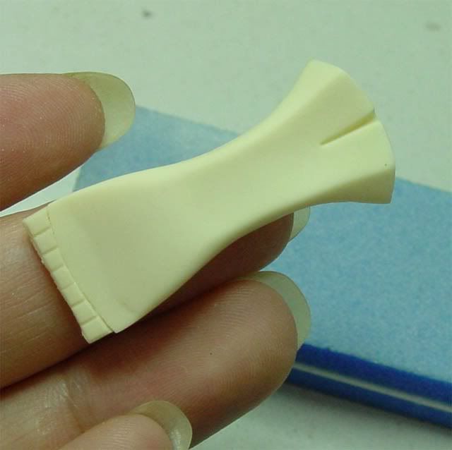

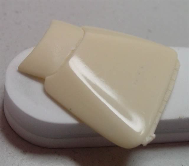

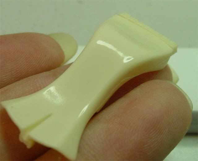

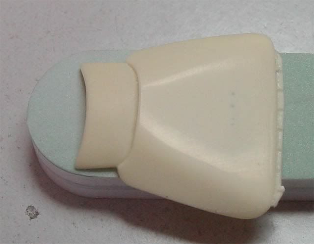

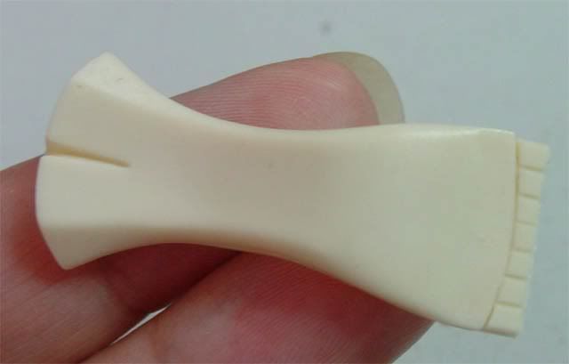

these sticks may apply on resin parts ,too.Happy modelling!
original part A
Posted Image
after using blue(nuetral) abrasive stick
Posted Image
after using green side of polishing stick
Posted Image
after using white side of polishing stick
Posted Image

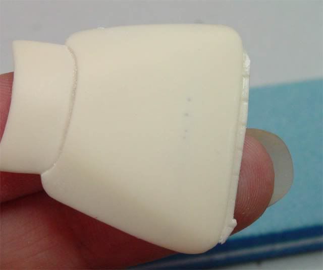

Original part B
Posted Image
Posted Image
Posted Image
Posted Image
Posted Image
Posted Image

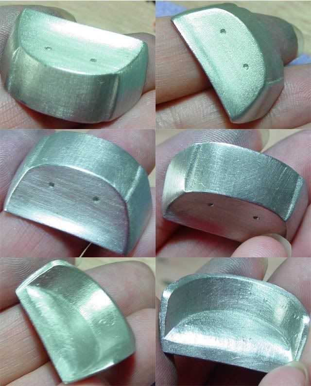

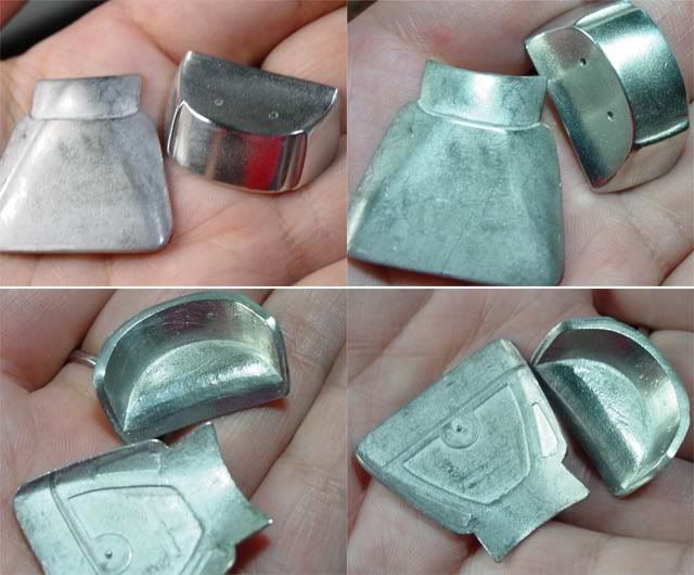

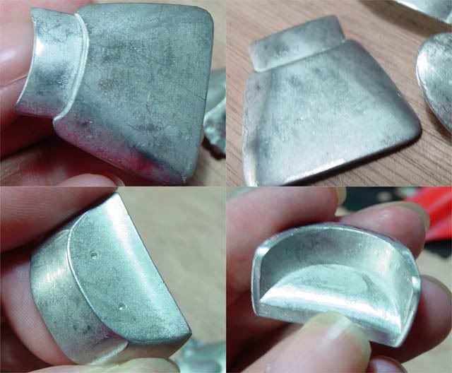

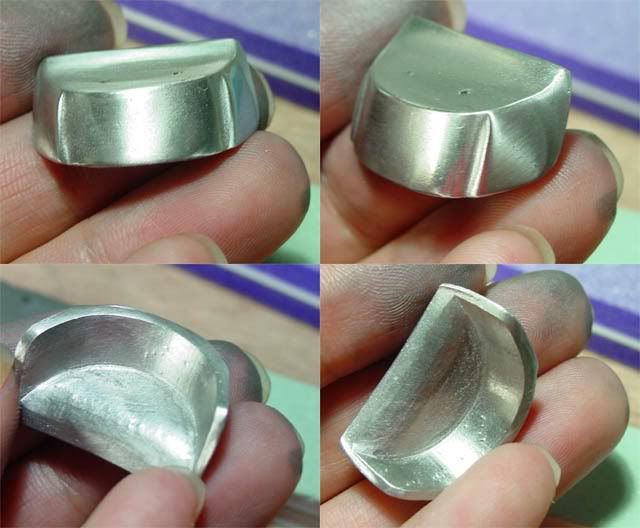

Original metal parts
Posted Image
After using stick A(purple one,not included in this package)
Posted Image
Posted Image
After using green side of stick B (notice the color is slightly yellow)
Posted Image
After using white side of stick B (now it is real steel color)
Posted Image
comparation with original parts
Posted Image

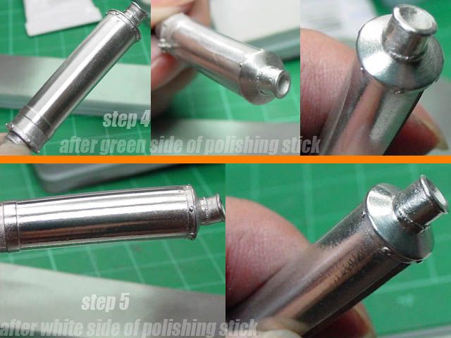

Posted 23 June 2006 - 09:06 PM

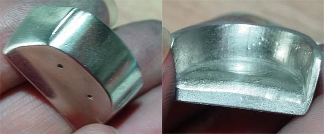

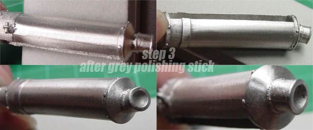

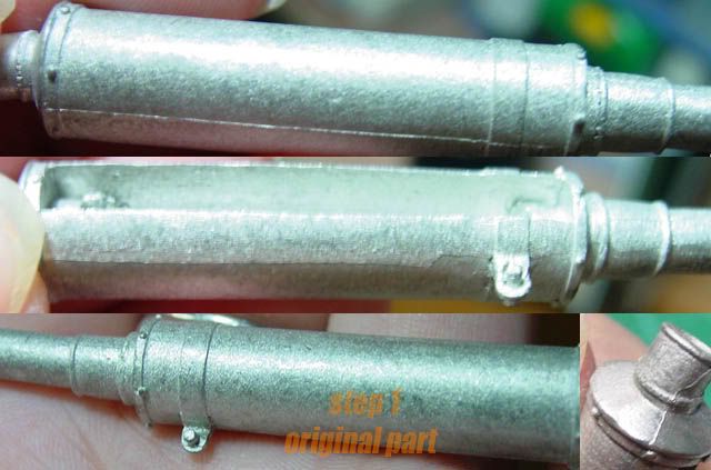

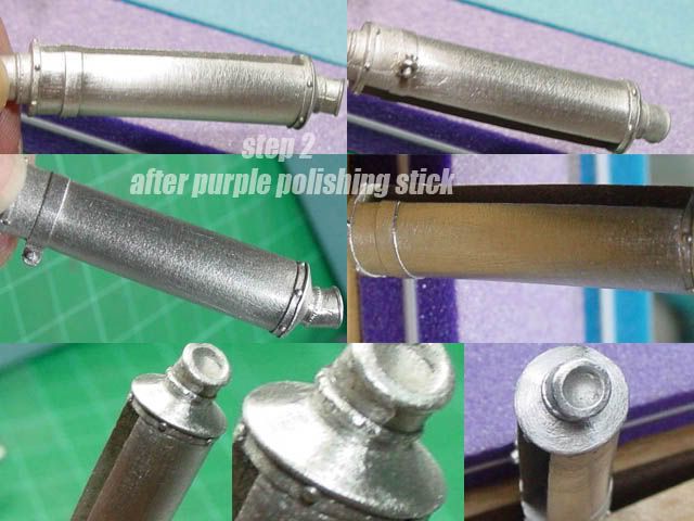

I tried those sticks on another white metal.Effect are great as always.Share with you.
step 1 choose an original part.Notice the mold lines and huge grains on the part
Posted Image
step 2 after purple (extra coarse)polishing stick (mold lines were removed mostly,but grains were still big)
Posted Image
step 3 after grey (Fine)polishing stick (deep and fine polishing,grains were smooth now)
Posted Image
step 4.5 ,4 after green side and white side of the polishing stick(after green side,the shine was a bit blurry.after the white side,the shine turned to be real metal shine!)
Posted Image
