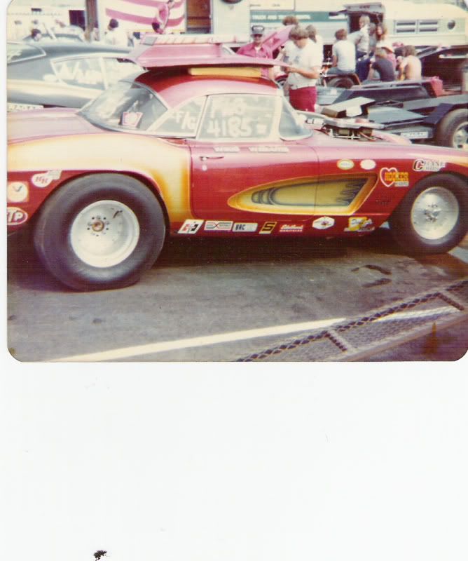

I'll be following this, since I'm planning a very similar project.... This was my cousin's car back in the 70s:
I'm interested in how you handle the top on this...great work so far.

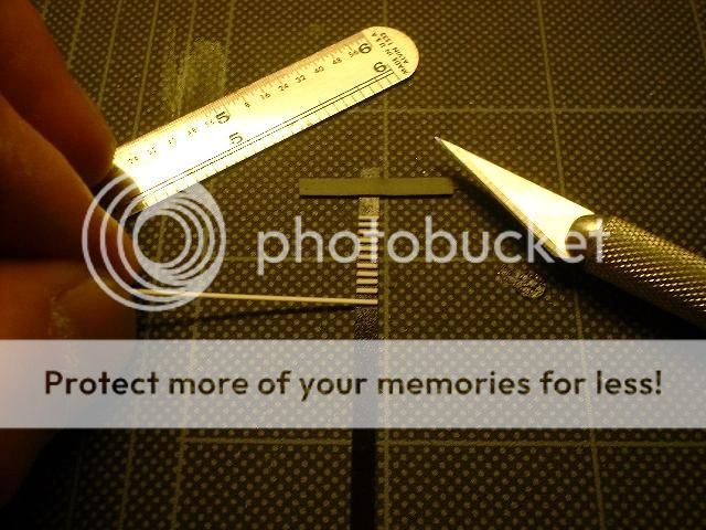

While waiting for paint to dry...thought I'd scratch up a blower belt.  I used .005 Evergreen as the belt stock and then .020 Evergreen rod for the teeth. I laiid a piece of tape on my bendh and dribbled some Model Master liquid glue on it. Then chopped off a whole bunch of pieces of rod about 2 - 3 times longer than the width actually needed...just to make it easier to hold them!  Then I glued them all on piece by piece...
103_0966-vi.jpgHosted on Fotki
After they dried I then just cut off all the ends with the Xacto knife...
103_0969-vi.jpgHosted on Fotki
103_0972-vi.jpgHosted on Fotki
Looking at this pic I think the teeth look too thick...and by measurement, they are. I talked to Roger Lee and he told me his 1:1 blower belt is 1/4" thick at the root of the teeth with 1/4" thick teeth. So in 1/25, the teeth should be only about half this size. So I plan to sand them down some to make them more in scale...
