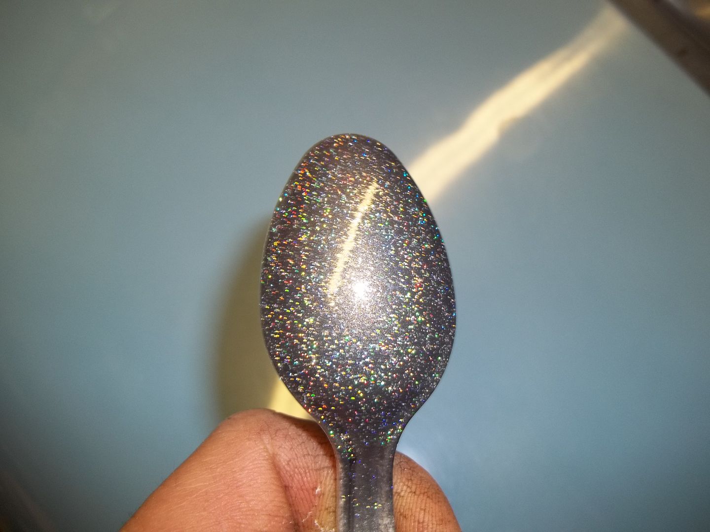

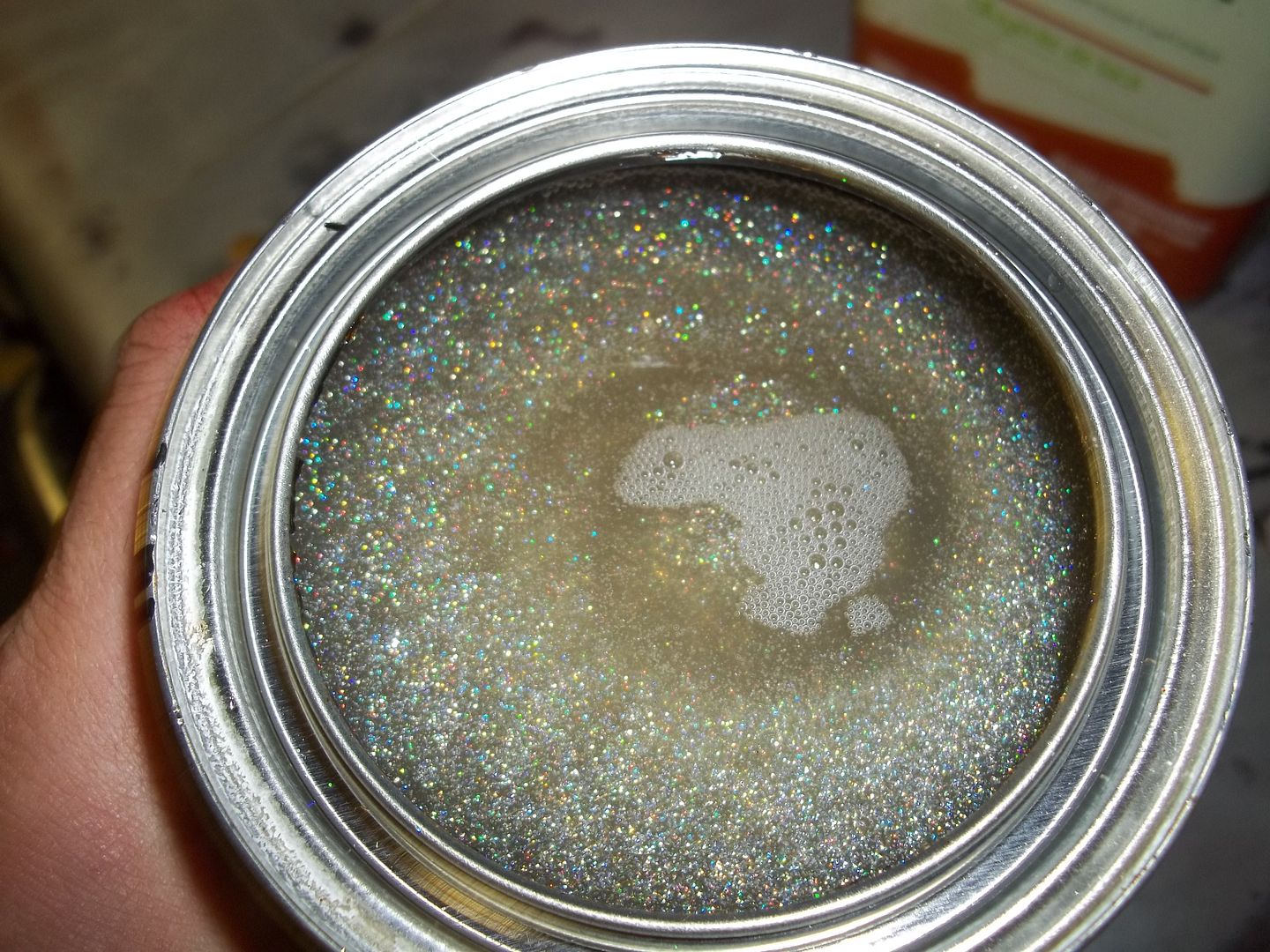

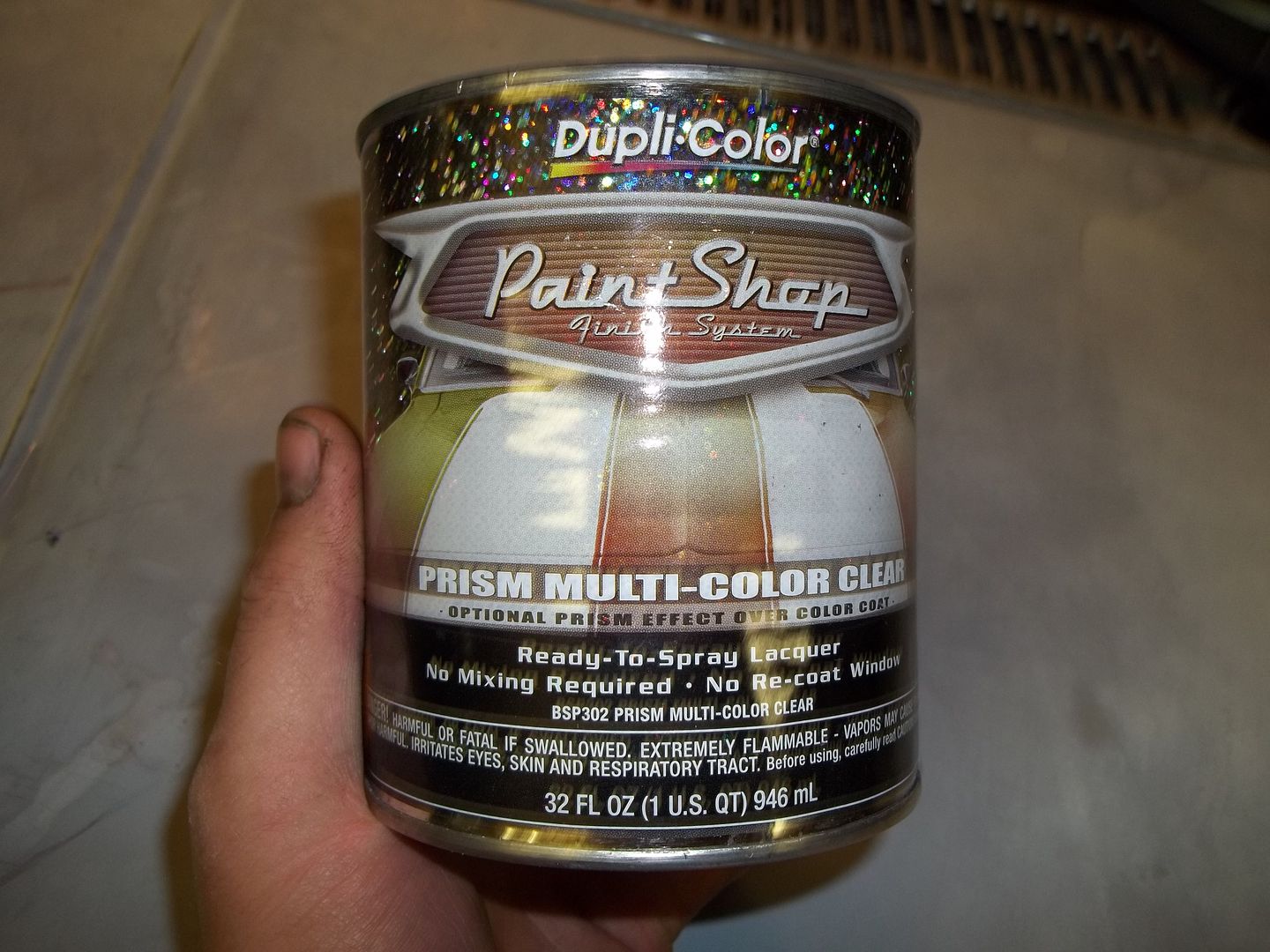

I recently did some testing with the Prism effect clear from the Duplicolor Paint Shop line. Here's the results.
Here's the product in question.

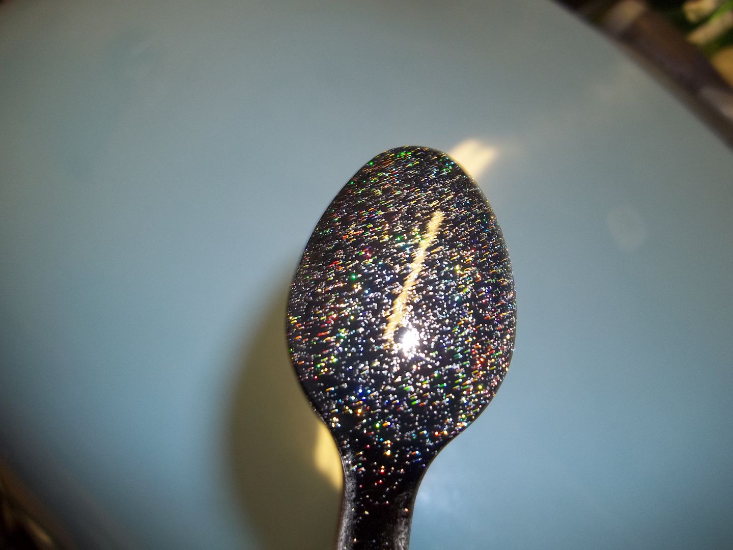

This is what it looks like in the can.

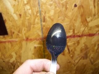

I did 6 tests, all using Duplicolor FP101 primer as the base. 4 of the tests were done using Perfect Match for the next coat, the final 2 were done using Testors and Tamiya hobby laquers. All the base coats were done with spray cans.
Chrysler GunMetal Gray
Toyota Black Metallic

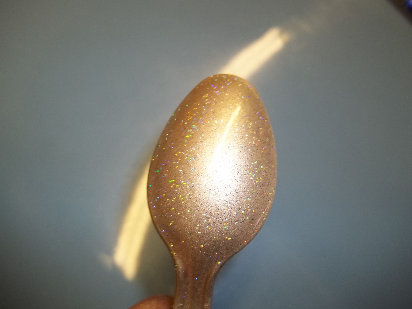

GM Light Driftwood Metallic

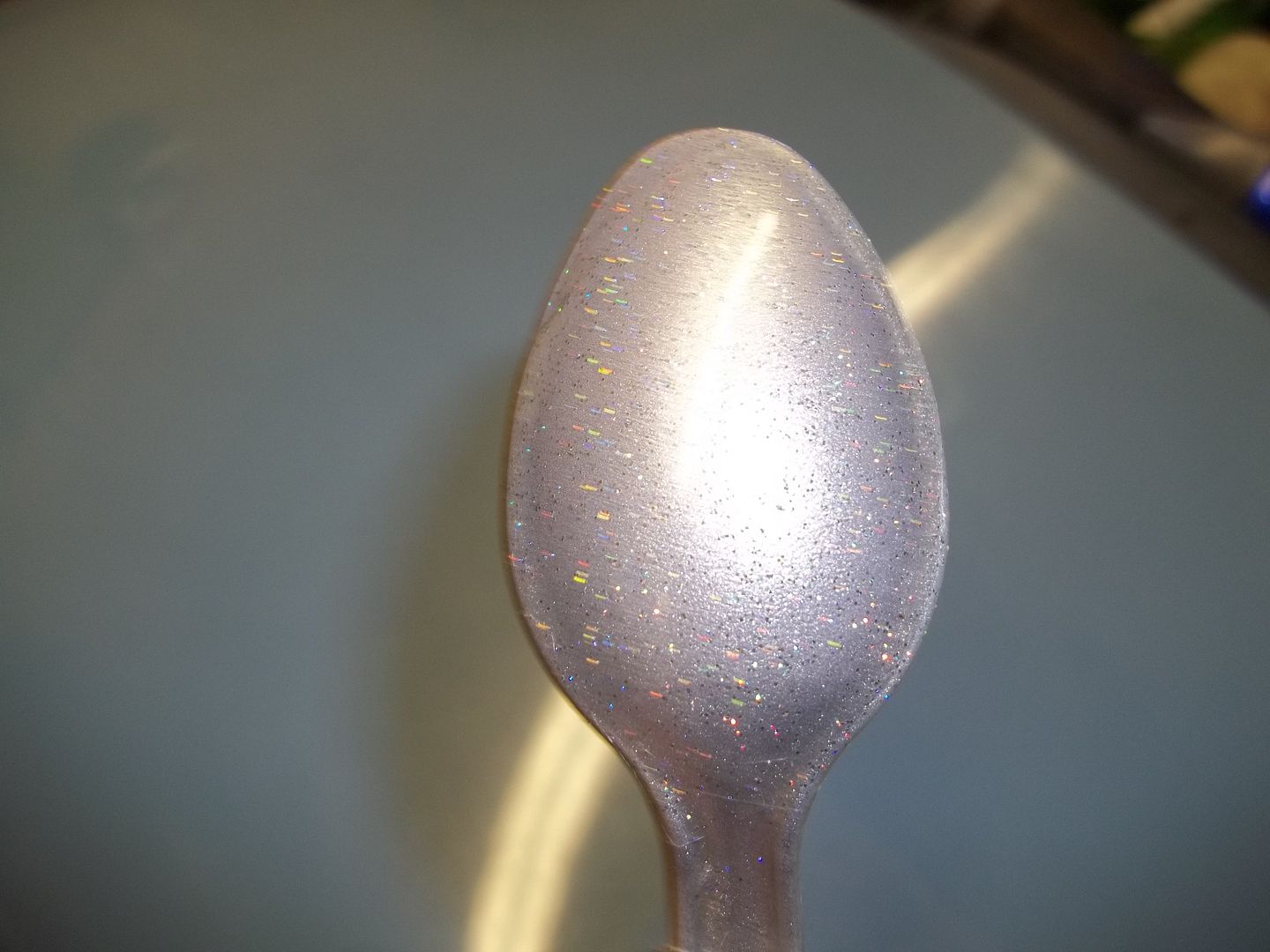

GM Ultra Silver Metallic

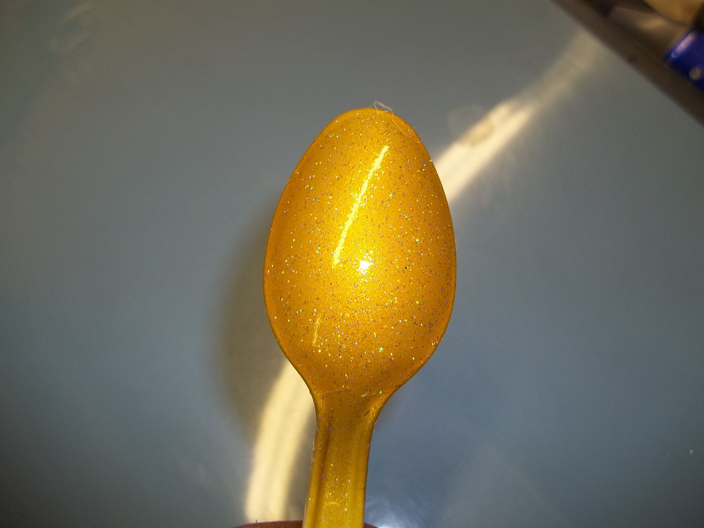

Testors One Shot Aztec Gold

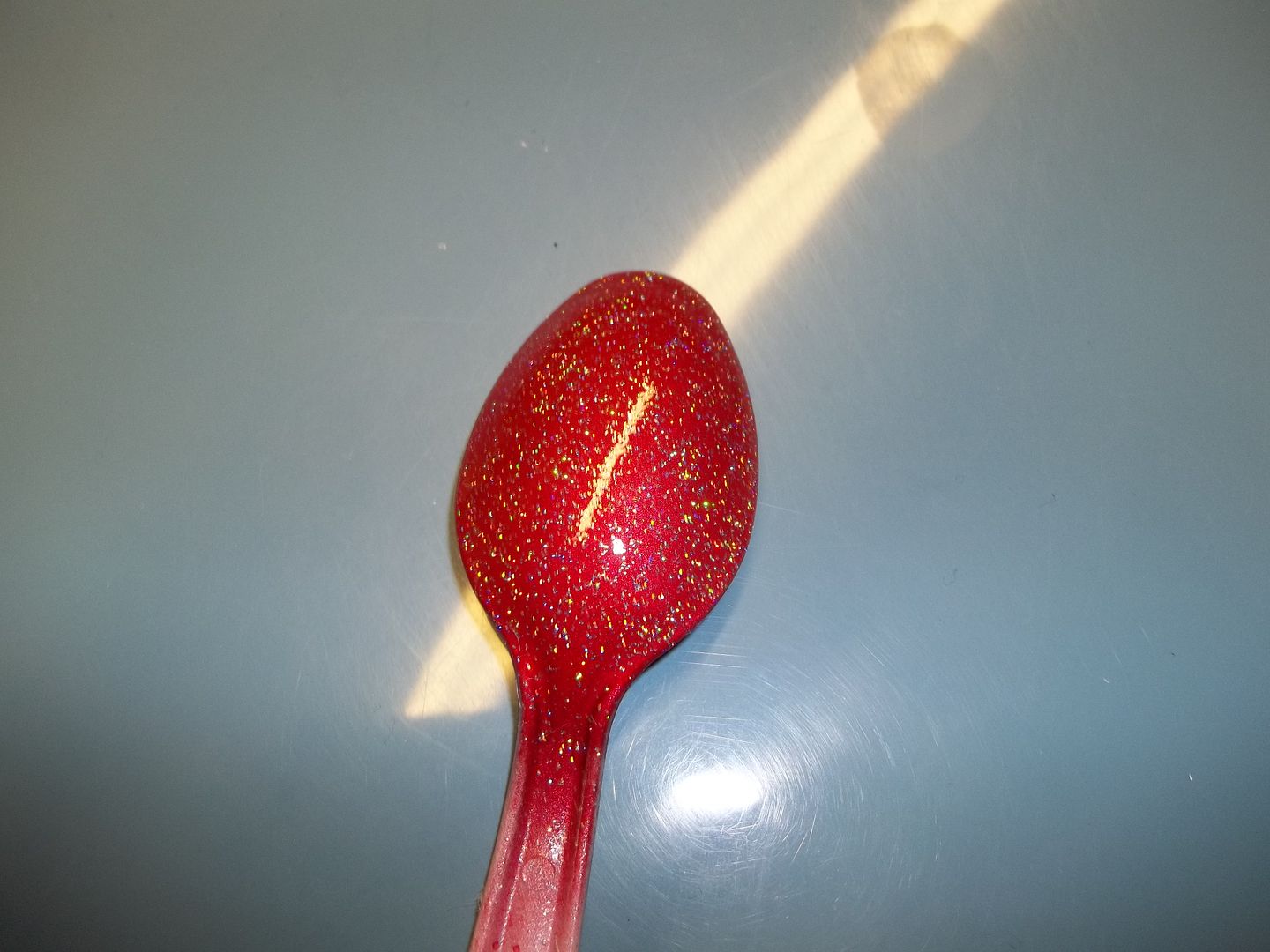

Tamiya Red Metallic
In addition, I did a second test using a candy red (Transparent Kandy Red Kustom Kolor) over the prism clear. Got a heavy metal flake effect, especially with the black and Gunmetal bases.
As mentioned, all the bases were rattle can. The clear and the candy red were both shot using a Paasche Model V with the #5 tip/needle, using 12-15 psi. There was no adverse effect using this clear, or the regular Duplicolor clear, over the hobby laquers. I have not tested them with enamels yet, but I will be trying it soon.

Those are some cool results,  I kind of like it, but have no idea what to use it on

The clear runs about $25 for a quart at any auto parts store, I usually get mine from Advance Auto or O'Reillys. When I picked this up, Advance was having a "buy 2 get one free" sale. This paint is prethinned, ready to spray with out of the can.

it looks cool but i dont know if i would like it on a model, the flakes may be well out of scale

Yeah, the flakes are a bit on the large side, especially for 1/24-1/25 scale. Might be ok on a larger scale build, though. I did pick up a can of their reguler metallic clear, which has a much smaller flake in it. I'll test it, too, and post soon.
Oh, and I have some up with a plan on the larger flake, as I do have soe 1/8  and 1/12 scale builds in the works that need a cool paint job. B)

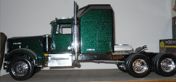

I used that Duolicolor spray "system" on one of my 1 16th Kenworth Aerodynes, it turned out nice but that paint is pretty expensive if I recall.
The color shifts from purple to green (I have a pic of the truck but with the flash it just looks totally green metallic).

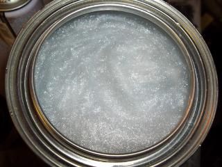

Alright, the clear has dried, so now for the 2nd test pix! B)
First, I'll start with the Metallic Clear over Duplicolor and hobby laquers.
Here's the Metallic clear in the can. Almost looks more like a pearl silvery-white once it's mixed up.

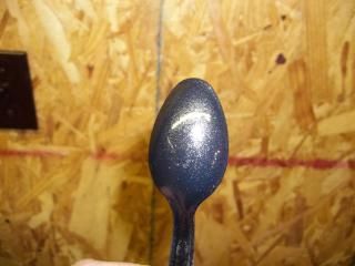

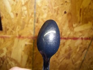

Over GM Metallic Black.
Testors Laquer System Gloss Black
Tamiya TS11 Maroon
I'm pleased with how it looks on these colors, especially over black. This clear seems to have a bluish tint to the metallic in it, which tends to make it not work well with certain colors. As before, no problems using it over hobby laquers.

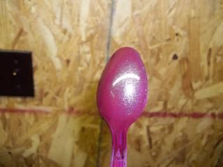

Testors Boyd Grape Pearl. I was very impressed with how this one looks. This one was also my first attempt at using Donn Yosts method of using cheap laquer thinner for enamels. I have to say, it works!

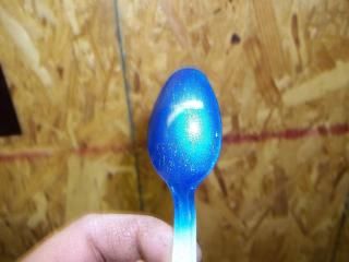

Tamiya X-13 Metallic Blue. Again, first time spraying Tamiya acrylic. I had a bad experience spraying water base paints in the past, so was reluctant to try it. After this test, I will be using more of the Tamiya acrylics for spraying in the future.
Valspar JD Green.
I saw no lifting or wrinkling, so I would feel safe using the Duplicolor Clears over hobby enamels and acrylics. As with the earlier test, all the airbrushed paints were shot with my trusty Paashe Model V dual action.
One more note I'd like to add, the Prism and Metallic clears are intended as a mid coat, and should be cleared over. While they do have a decent shine to them, they do have a slight texture that needs to buried in regular clear.
