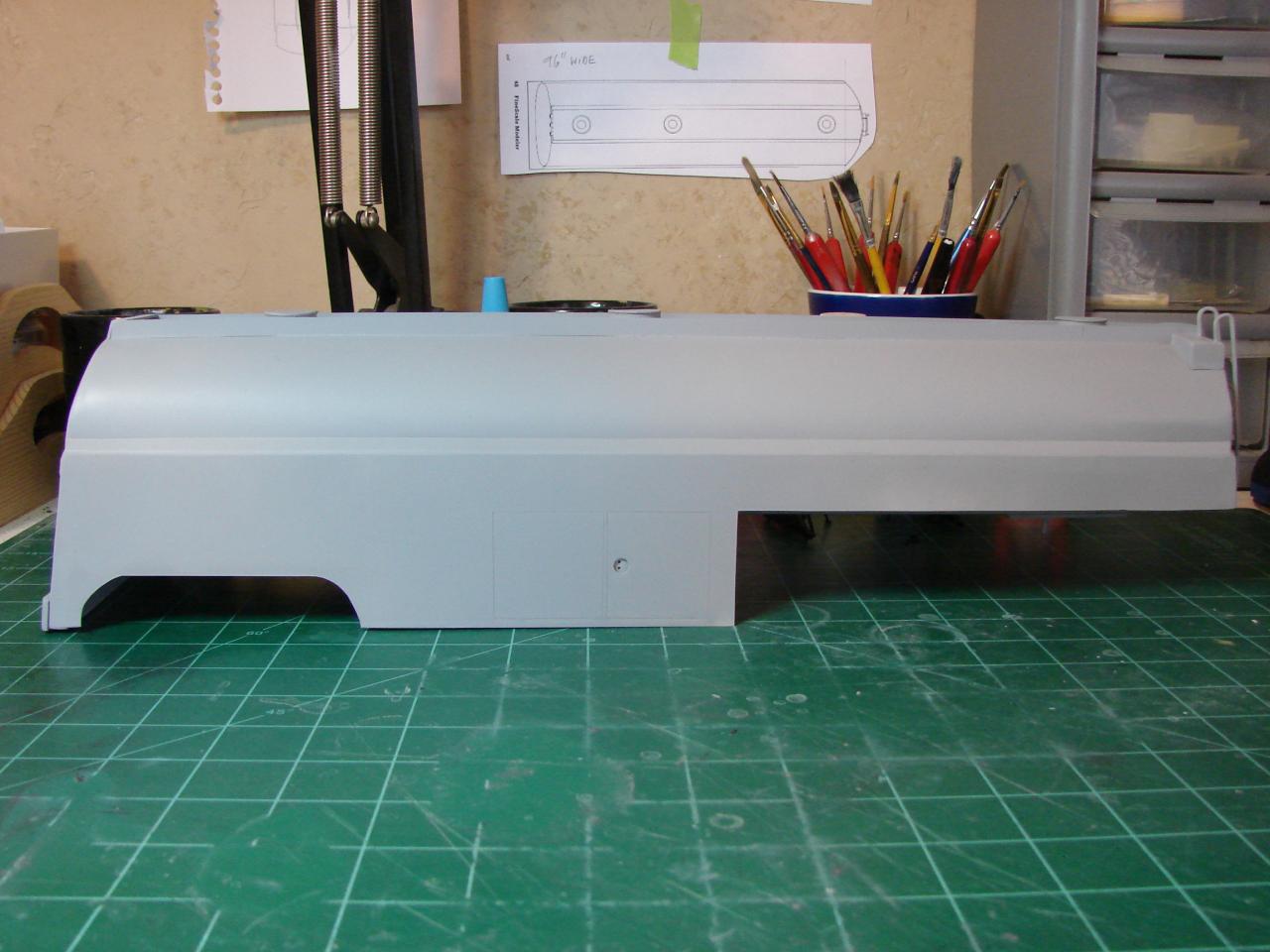

I built my Fruehauf trailer with Evergreen .020 and it holds up well. Doing the bulkheads and ribbing takes time but to me anyway a lot more satisfaction in doing that than getting PVC piping.
