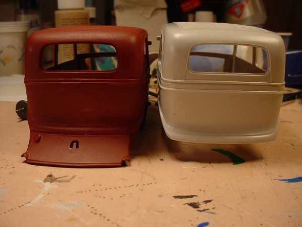

Here's where I left off in 2005. The body had been sectioned 6 scale inches at the belt line. The Plymouth flatty six was finished and ready to install. The chassis componets are just posed.
Here's the difference of what I sectioned out of the body. It was really easy, the two remaining pieces just fit right back together.
the good part about revisiting an old project is that you notice things you didn't before. On this one, the car was just sitting up way too high, like a highboy with the chassis showing below the bottom of the body. Back in 2005, I was playing with (and destroying!) chassis and suspension parts. Go to 2012 and I immediately saw my issue... I sectioned 6" out of the body but still had the stock height interior. So per the above photo, I took a second interior tub and cut the corresponding 6" out of it. It was a three part process. I needed the top of the doors since they had detail on them. I needed the lower half of the back for the arm rests. So I cut the floor out, then seperated the doors forward from the back of the tub. I cut 6" from the bottom of the doors, 6" from the top of the tub and then glued it all back together. It worked fairly well.
