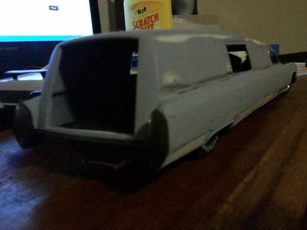

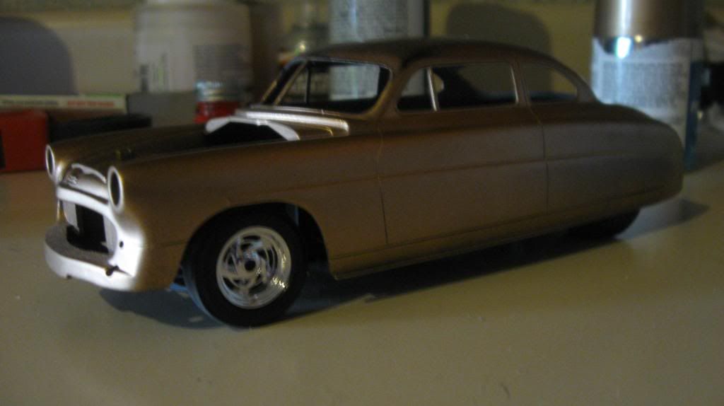

The Chevelle and the Falcon are kind of stalled. Could the third time be the charm?
Yeah, I know me building a Hudson Hornet seems kind of weird, but still.
So far I have added the tubs and rear frame/suspension from a Revell '67 Chevelle. The front tires and inner wheels are also from that kit, but I used the wheels from a Monogram '37 Ford street rod. I kept the stock suspension up front and modified the spindles to lower the nose a bit.

do to our firewall here, i cant see the picture, but it sounds like a really cool project. its the first pro streeted hudson i have seen. i am in a rut on mine too, doing too many other things besides building, but the wife will be happy.
Link to comment
Better? :unsure:
i dont know what you did, but that worked and that really cool !! reminds me of something Troy (however you spell his last name) would build.

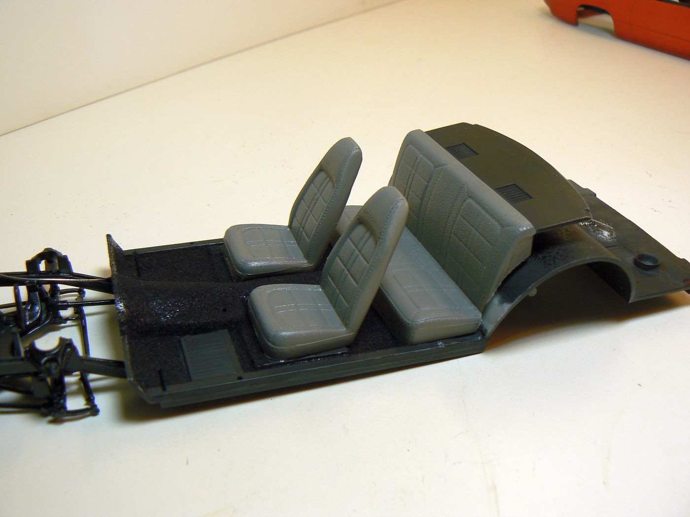

OK, I've got some more updating to do, I got the interior mocked up to check the back seat's alignment (Along with the door panels) and the modified chassis. It fits great, here's some pics to prove it!
Here's the minor mods needed to the wheel wells and back seat to get it to fit properly, just a bit of plastic removed from both...
And the interior mocked up with a spare Duster body. The gap between the package shelf on the back seat and rear window opening is fine, the rear glass is pretty thick!

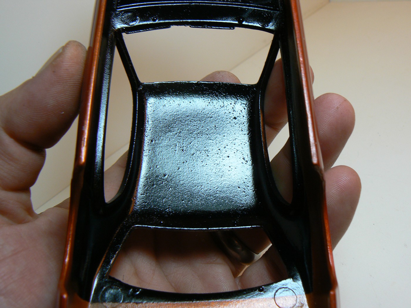

Next up, a bit of masking was done to the body so I could paint the headliner and under-hood areas Black, some Black embossing powder was added to the floor pan, and the interior assembly was started. I stopped here for the night, I'm sick as a dog, and I need some drugs and sleep!

OK, the interior is now done, but it's in the spare body to keep it all squared up while the glue dries. I got a bit more done, starting with making a new driveshaft. I chopped the universal joints off the kit part, added a piece of aluminum tubing, and we have a driveshaft that fits!

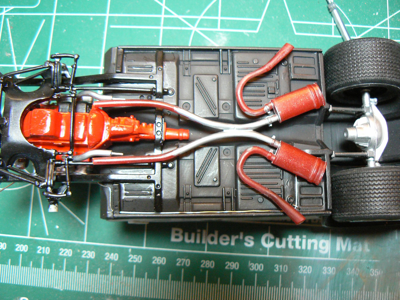

This part tells me why Sam didn't want to build it, the Challenger T/A exhaust wasn't exactly designed to fit a Duster. This took a bit of heat, a whole lot of eyeballing and test fitting, and a couple of pieces of beading wire to hold the modified exhaust together.
First up, the stripped exhaust in it's original size on the chassis...yeah, that's not gonna fit!
The exhaust itself lands right at the back corner of the door...not the best placement!
A bit of heat was applied to the exhaust tips, a bit of pressure, and we have tips that are better aligned. I also cut a section out of the center, and bent the pipes going up to the engine so they would line up with the location that the Duster's exhaust took over the transmission crossmember...
4 holes were carefully drilled in the modified exhaust, and a bit of 24 gauge beading wire was added to each pipe on the rear half...
And a bit of Tamiya Extra Thin cement was added to the joint. Once it's cured, I'll work on making the seam disappear, hopefully making it look like a kit part!
Once all of the repairs to the exhaust are done, I still need to make it play nice with the exhaust from the engine, which should be a real joy...I'm not looking forward to it! Oh, and then I need to find a way to get the exhaust secured to the chassis!

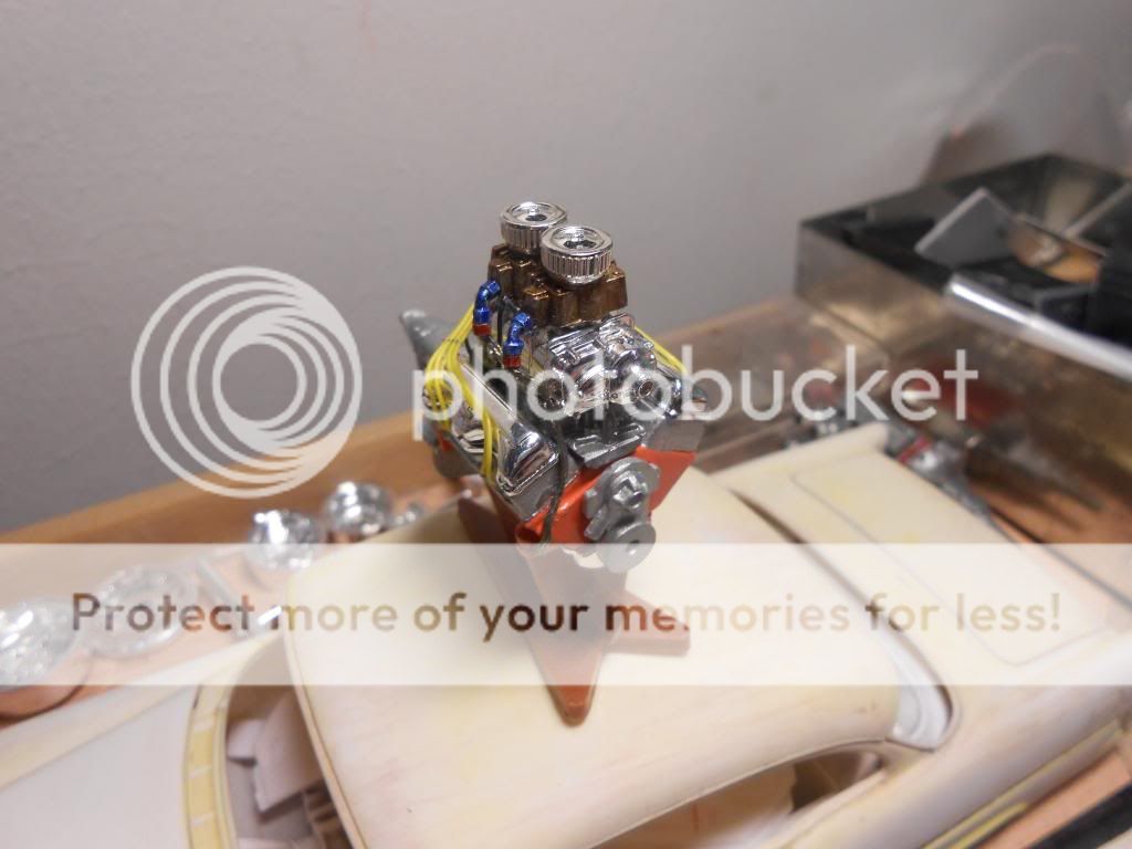

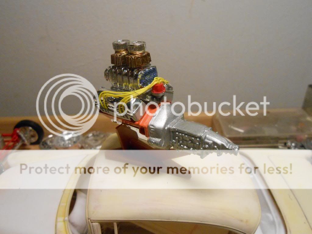

Little update for the engine of my '58 Chevy Sedan Delivery. I got the carburetors installed. They are from my parts box, Air Cleaners are from Revell '69 Nova and they need some Black Washing before I can call them done. Also started the Fuel Lines, still needs to make one fitting to the Water Pump so I can connect the lines there, too.
looking good. nice detail.....

Niko, that enigne looks great, Jim, I hope you and Marshall can join in, you've both got some killer work going on!

Now onto more of the exhaust system. I got it all together nicely if you recall, added a bit of Mr Hobby White putty, but it just wouldn't fill the cuts properly.
Here's the glued exhaust, the gap has gotta go...
A bit of Mr Hobby White putty, a bit of sanding....
After hitting it with some Metalizer Stainless Steel, it just didn't look good enough...
At this point, the pipe going up to the driver's side had snapped off at the joint. Now I had to strengthen the joint, a small piece of strip styrene was added to the back side, A bit of shaping to hide it on the sides...
And a quick test-fit on the chassis, this is where the inspiration hit me, I had a way to hide the joint!
Here's the fix, and a way to attach the exhaust to the chassis all in one! I grabbed some more .010 styrene strips, and glued a piece to the underside of the exhaust...
A second piece was glued to the flat side and pushed down with a piece of sprue right against the exhaust, causing it to go vertical...
Once the glue had set, some more glue was applied to the exhaust itself, and the strip was held down until the glue set, then the first step was repeated until I had a clamp/hanger assembly...
A bit of trimming of the new hanger, two holes drilled, then mocked up on the chassis. Once I had the exhaust where I wanted it, I marked where I wanted to cut the pipes to join with the engine and drilled a hole in each to accept the beading wire in the exhaust manifolds...
