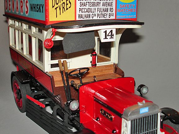

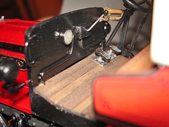

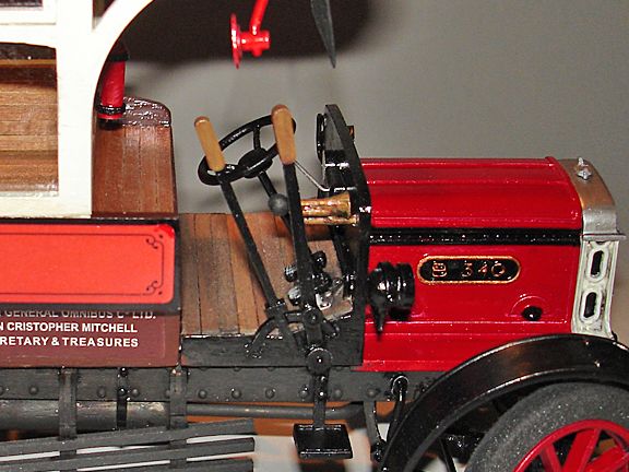

The driver's station was open to the elements... that had to be fun on cold winter days!

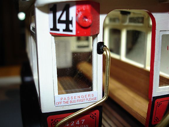

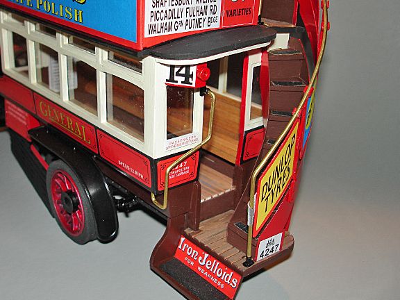

Access to the upper deck was via the rear stairway:

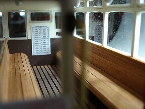

The people in the lower part sat on long wooden benches...

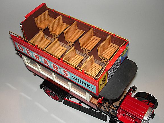

While the riders "upstairs" had individual two-passenger benches:
I added a scratchbuilt sun visor for the driver. The headlight "lenses" are clear 5-minute epoxy...

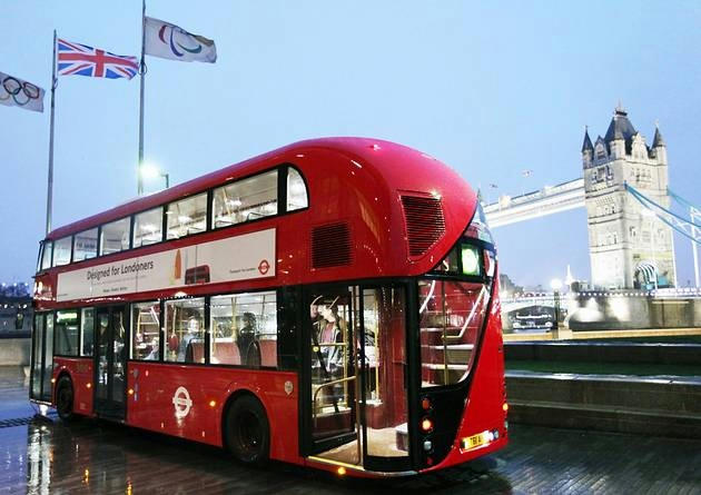

We've come a long way in 100 years with bus design, here's it's 2012 equivalent:
88f37756368c6dfd0c5a16708cfcb7423b467a62
I walked around one of these at a bus show a few months ago, truly amazing design.

Yes, sort of. The basic construction of the body is straightforward enough, but it gets a little tricky when you have to start adding the details. For example, the builder has to form the rear stairway skirts (and signboards) out of flat aluminum parts, and you have to get the curves exactly right to fit tightly against the sides of the steps with go gaps. Also, the builder has to bend all the brass rod to form the handrails, and it's a little tricky to get that rear stairway handrail curved exactly right, because it has to be bent in the correct curvature in two dimensions... the curve as the rail goes up the stairs, and also the curve that follows the curve of the stairway as it curls to the top. It took me a little while to finally get it right. The rear stairs was definitely the hardest part of the whole job, the rest wasn't too bad. Another challenge is getting the curve of the roof. The roof is obviously a flat piece of wood (it's actually very thin plywood!). I had to soak the wood overnight and then clamp it into the correct curvature while the wood dried, so it would hold it's curved shape. Again, getting that curve exactly right was a little tricky. All the rest of the laser-cut wooden parts fit very well and precisely, there's not much trimming or sanding needed before a part fits into place.
