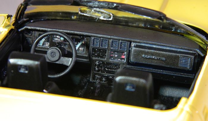

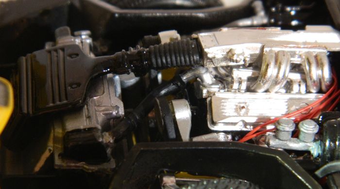

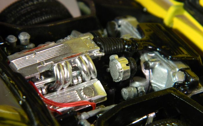

Well, I am calling the Corvette done.  This started off as an incomplete kit.  Another person provided a donor car so that I could complete this build.  The parts from the donor include the fan belt, water pump, upper radiator hose, and front tie rod.  The rear stop light was made from a sanded down piece of clear red sprue.  I modified the kit distributor so I could wire the engine by drilling holes for the wires.  The carpeting is flocked as well and I made decals for the dash gauges (including the idiot lights).  The body decals are old Fred Cady ones I bought last year.  Other than that, this was box-stock.
The body gave me fits during the build process.  The body and the hood were warped (and still are just a little bit).  After painting, I had to strip the paint and start over as the primer wasn't sticking to the body well (guess I hadn't cleaned it up well enough). After it was re-painted, I had another issue when masking off the yellow to paint the black.  After I was done, the tape pulled off paint. So I had to re-do the body a third time.
Anyway, here it is - hope you like it

Here's the interior:
Here's a couple of pics under the hood:

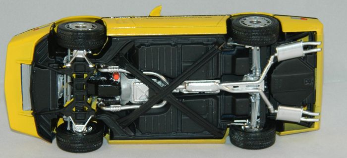

and here's the undercarriage:

Looks fantastic. I love the detail in the dash. Mind giving some info on how you did the colouring? I just got myself an '82 snap-kit Vette, so your build has given me some great inspiration.

For the dash, I sprayed the whole thing in satin black.  When that was dry, I painted the radio, heater controls and other inserts in gloss black.  The whole thing then got a light acrylic wash of black with a little blue.  I found some images of the dash online and downloaded those.  I cleaned them up and cropped the three displays as well as the insert with the engine lights into individual images.  I used a micrometer to take measurements and adjusted the images.  I then printed them off on white decal paper.  I added the decals last and used MicroSol to make sure they snuggled down against the molded-in detail.
