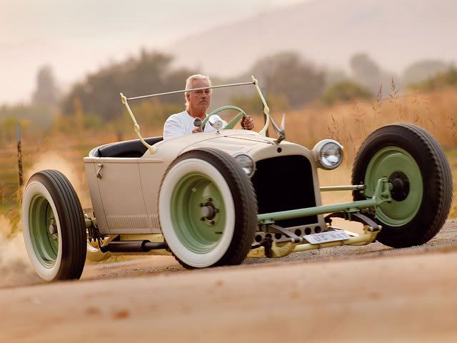

I don't know much about these types of hot rods, I'm not even sure if suicide & underslung are the same thing ? l'm working on a '32 Ford & would like to build a suicide front end. All the pics l can find don't show enough detail for me to understand what's going on. All l know is l like the forward extension of the front tires & lowered ride. Can anyone point me in the right direction to achieve this ? Thanks,

Here's a suicide front end. It gets it's name from the fact that if the spring breaks the chassis is almost guaranteed to hit the ground, since there's pretty much nothing of substance between the axle and the frame except for the spring.
Underslung just means that the frame is under the suspension rather than over - like on this slick lil' bucket (scrubline violation warning :D).

Actually, what failed most often and gave the front end its name was the often poor welding and too-light material choice for the cantilevered spring perch, made by unqualified builders.
But honestly, if you're interested in building hot rod models the best advise I can give you?
The H.A.M.B.
Nothin' better online for pre '65 hot rods and customs.
Great advice joining the HAMB. I had always heard that it was called a suicide front end because if the tie rod was ever damaged from say, an animal/debris impact, the tie rod would pull both wheels inward and then the wheels would try to meet in the middle, with predictable results.
The severe toe-in resulting from such an occurrance would be thrilling indeed, but but because of the design of steering linkage, assuming nothing breaks, toe tends to equalize and not throw the car violently in an unintended direction. When a spring perch breaks however...
